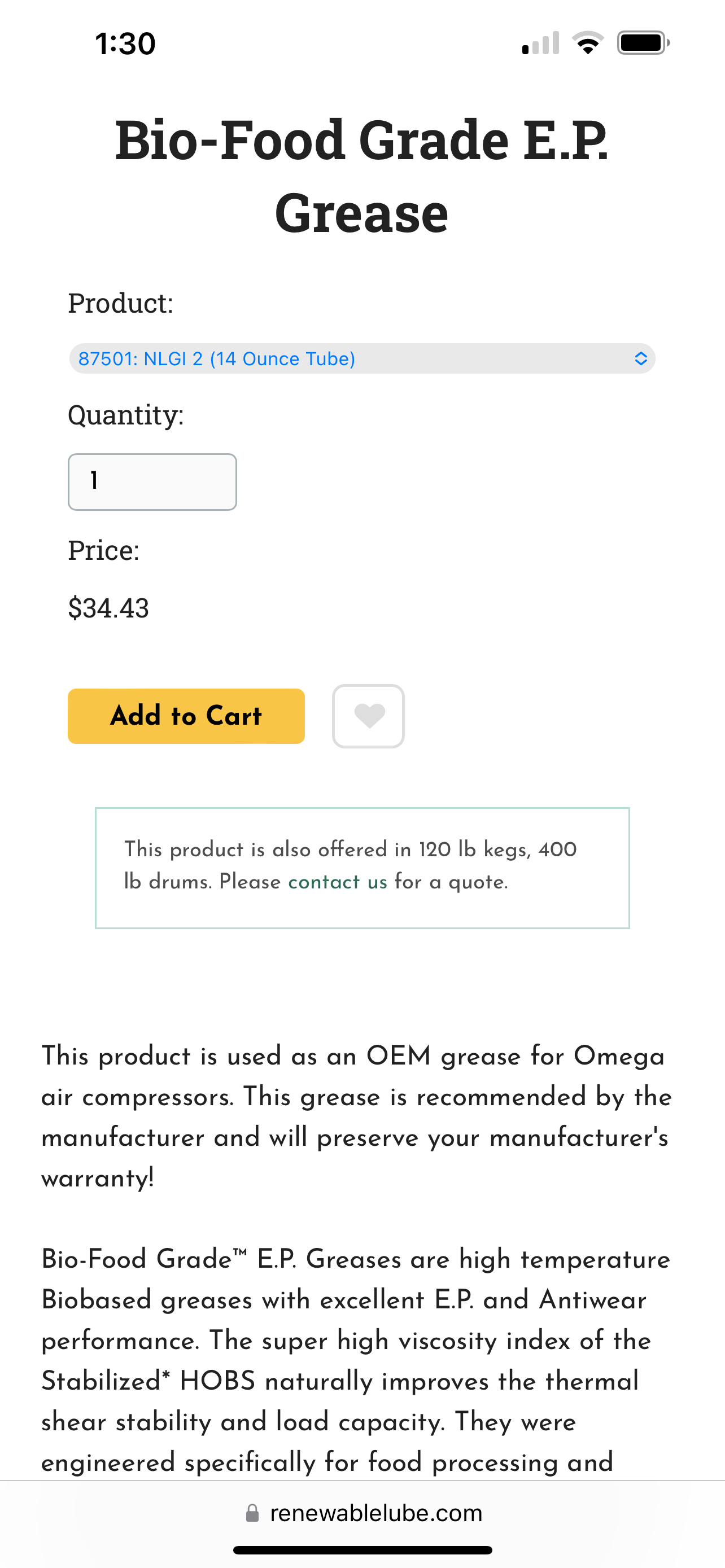

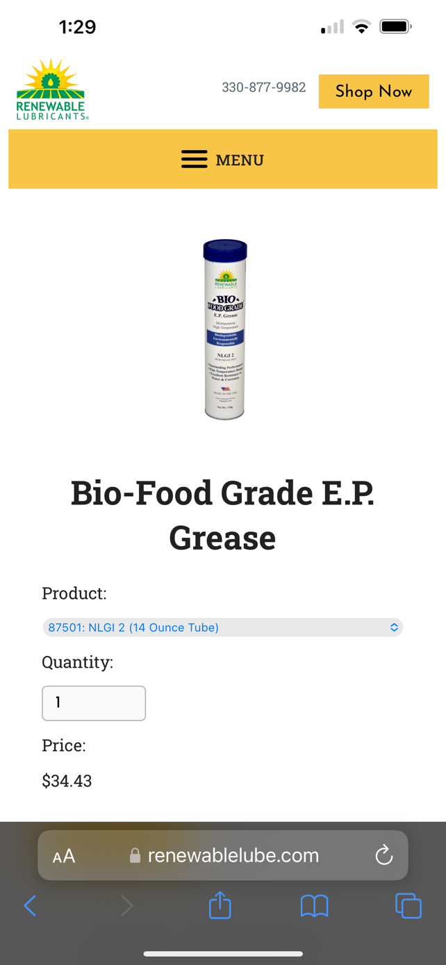

I have been using the aluminum disc that I machined in mine with no problems, I have like 16 hrs on my compressor now. I'm not making any more of the discs as I don't want any liability if something would happen to someone's compressor using one. In my opinion, I think it's just as well to run one without the rubber gasket or a disc. The grease I use in mine is from Renewable Lubricants, it comes in a 14 oz. tube for 34.00....It's been running fine with it and I believe that much grease will outlast the compressor....:)
Although it will work on the crank, (grease pot) this is the grease to be used inside the cylinders if you take the machine apart from what GX customer service told me. Luckily there is a lot of grease in that tube. Too bad the price went up on ebay.
