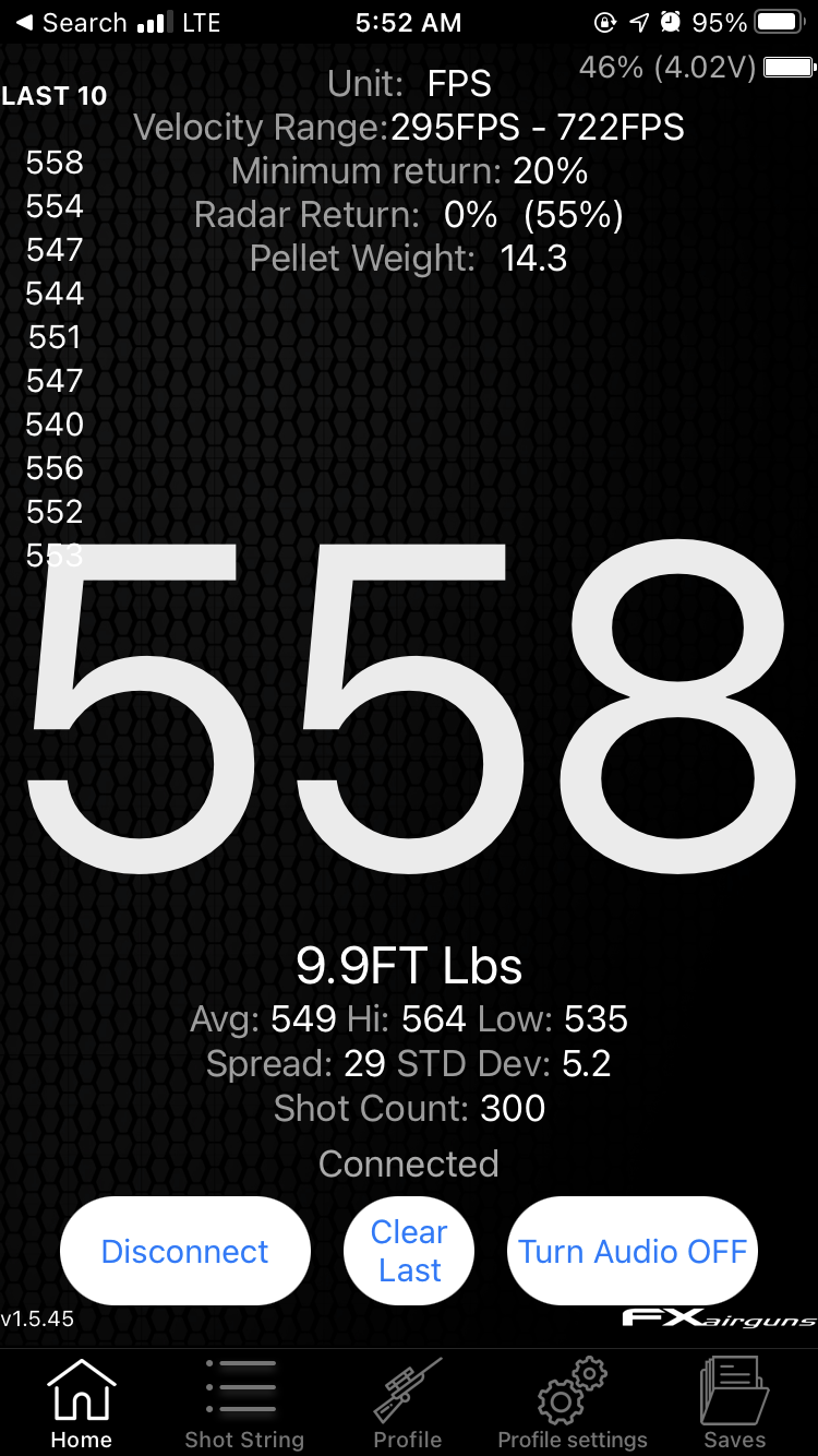

Is that from a 220 BAR to 75 BAR fill on my first-generation Cricket, shots continue to be regulated. Below is a 300-shot summary of such as stated:
And even stopping at this point there is still no sign of shots going off-the-reg.

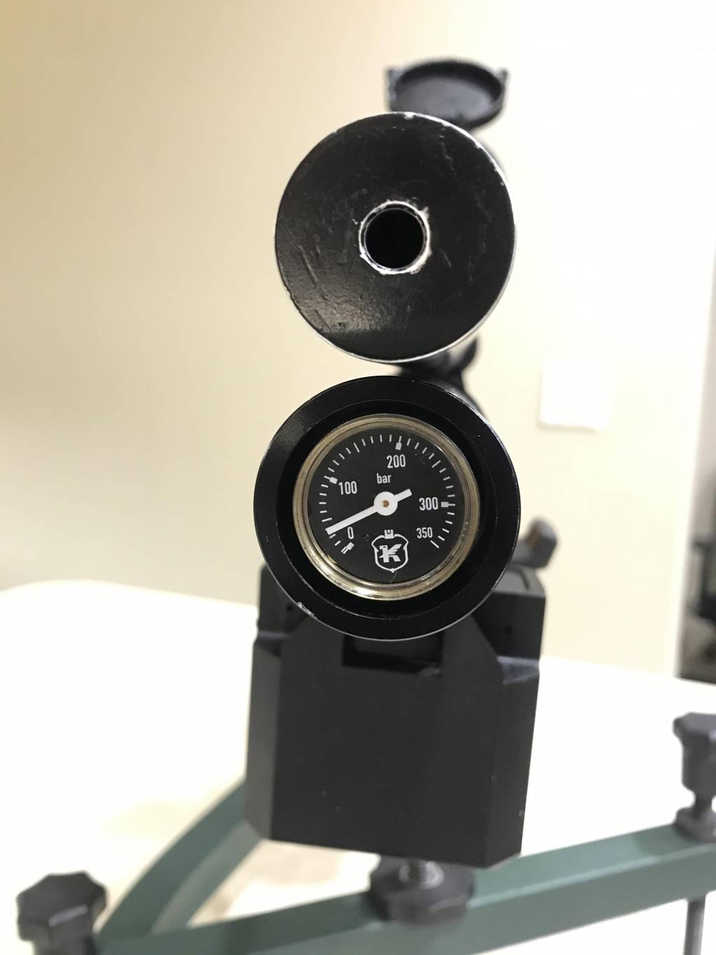

Below is the indicated air pressure on the Cricket after those 300 shots:
Ammo used are Crosman .22 Hollowpoints straight from the tin. With JSBs the extreme spread and standard deviation would be much lower.
The power level is plenty enough for my short-range target practice at a maximum distance of 48 yards.

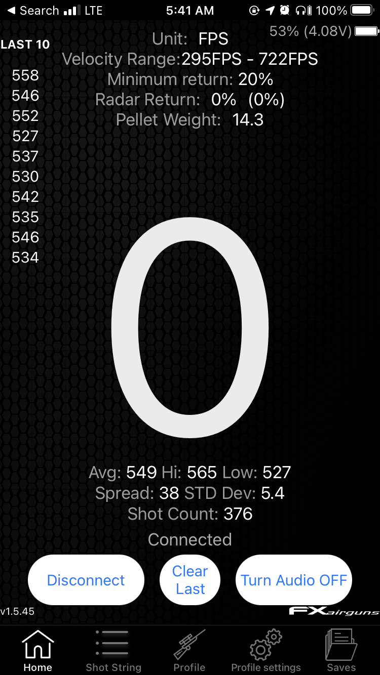

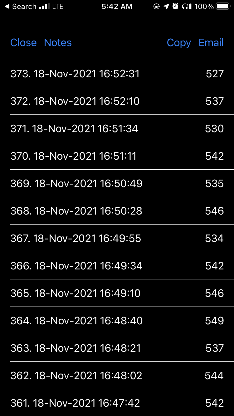

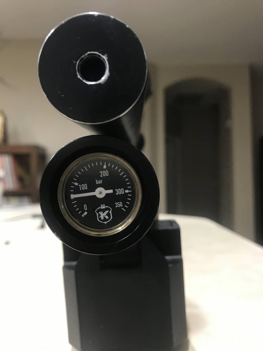

Anyway, I was able to get 370 shots in total to stay within a 30 FPS spread—with Crosman pellets—and per my Cricket’s gauge, shot 371 indicated it was no longer on-the-reg. Tank pressure was at around 35 BAR at that point as the picture below shows. I think 370 shots should be enough.😉
