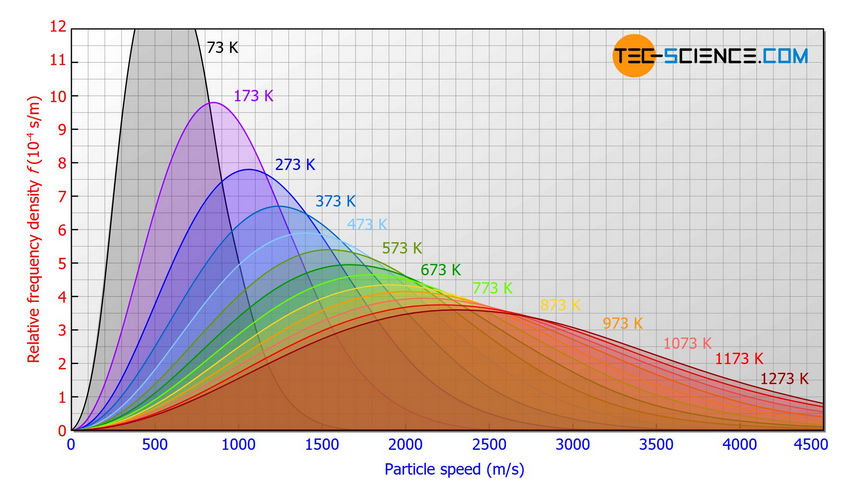

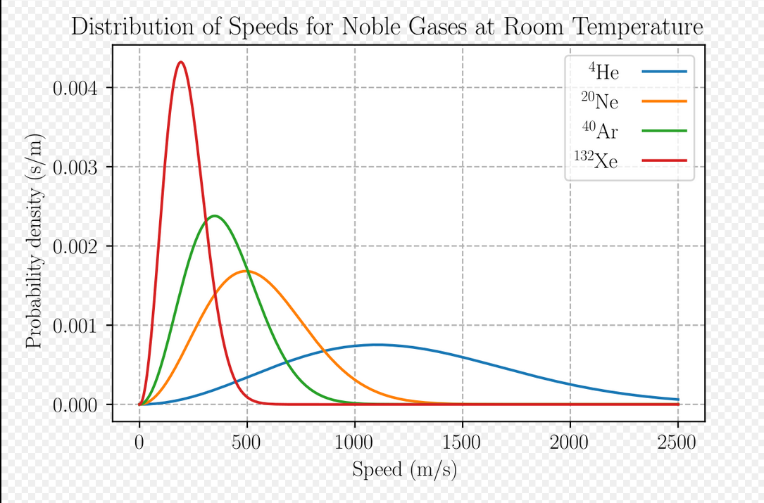

The other determining factor is the distribution of speeds based on the gas used. Sure we commonly use the air available in our atmosphere, but, there are those that opt for helium. Below is a GREAT visualization of how impactful the gas being used to propel our projectiles is....
Familiarize yourself with the Maxwell-Boltzmann distribution.
Likewise Temperature of gas...
Really, its a deep rabbit hole that very few dare to go. Sure the above doesn't apply to 99% of airgunners, but it still applies to thermodynamics and limiting factors.

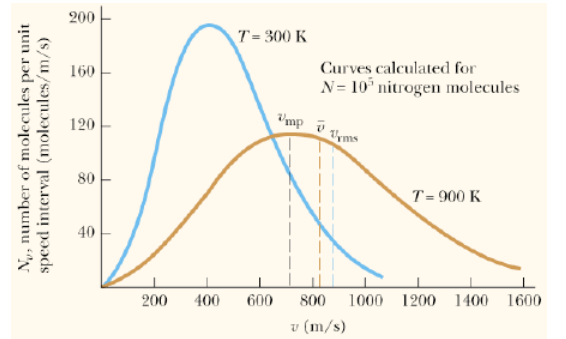

Here’s a question I have, so room temp is like 300K if I’m remembering right. If you had air at say 500k, or any higher temp I guess, how much faster velocities(the projectile not the air) could be achieved? Never mind the magical heat resistant orings, springs, and plastic parts needed!
Now I’m getting chem2 flashbacks haha!
Very loaded question, depends on sectional density of your projectile. However, for practical purposes...
300k / room temp (80f) nets 1000-1100 fps at most in most calibers for most readily available off the shelf projectiles
500k would net closer to 1300-1400 fps
