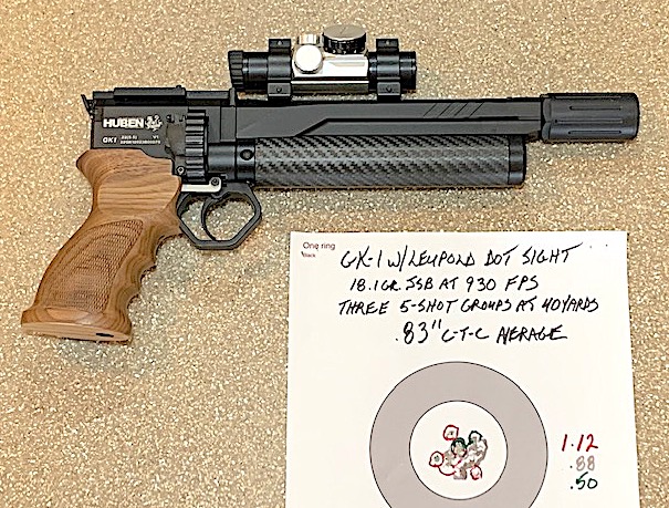

Not particularly technically-minded but smitten with my .22 GK-1, early in reading your post I forecast if any PCP meets the lofty goal it's GK-1(s). Then, it came as no surprise they can blow the lofty goal to smithereens.
By the way, revolvers are not only less than optimal for accuracy, but also ballistic efficiency. That GK-1s are both extremely accurate and ballistically efficient puts them in the class you and I use to describe them- MAGIC... INDEED!
And while 'accurate' is a relative term, the GK-1 also blows that term to smithereens (in Revolver World).
