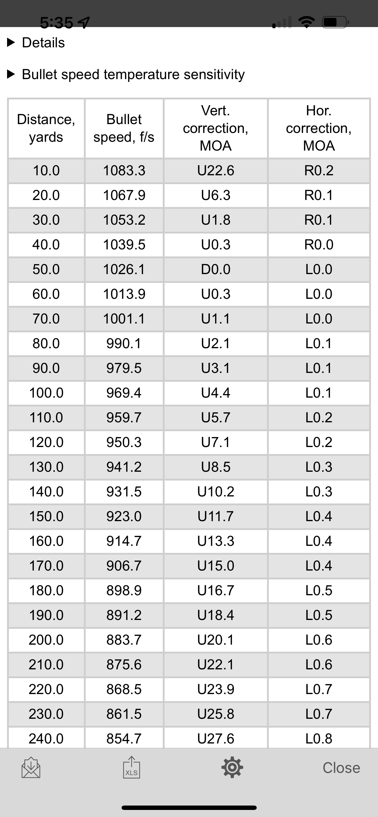

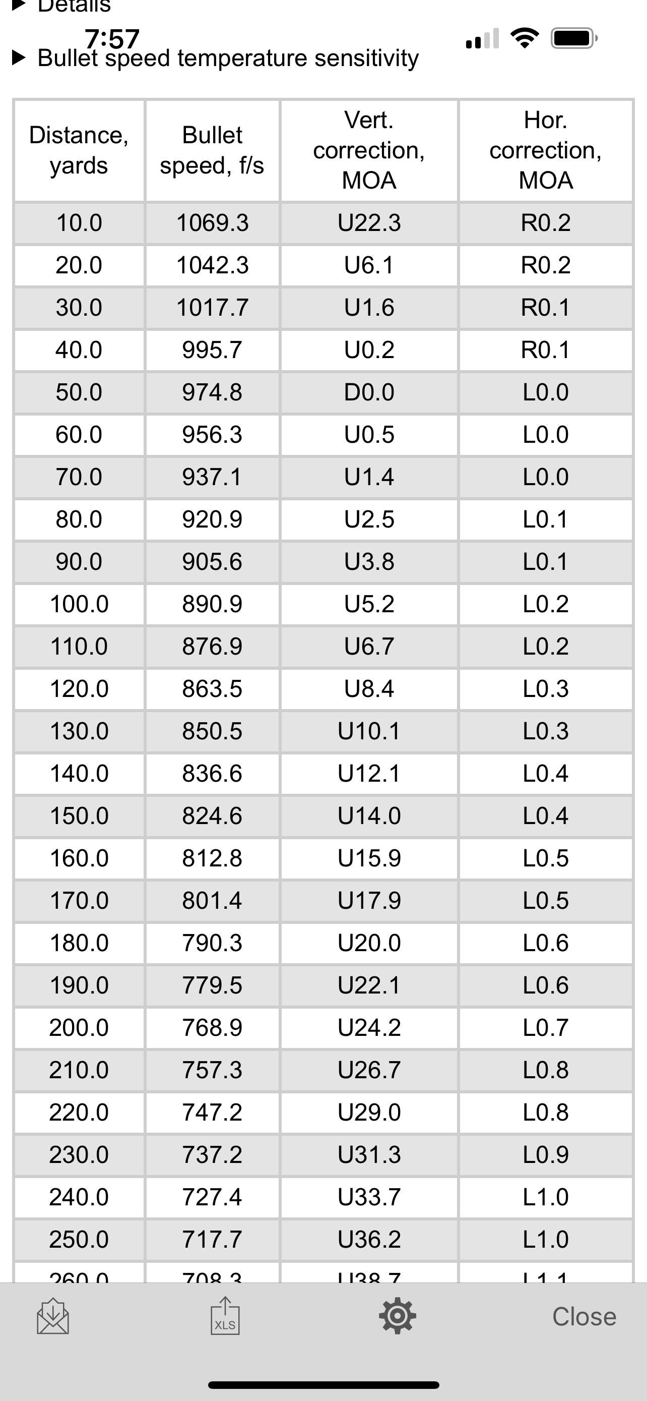

So I went ahead and typed up the data with StrelokPro
I didn’t change the bc from the data in StrelokPro simply because I don’t believe it changes.
I believe this is simply a factor of a very high scope “3.75”
And messing with the near and far zero changing with fps changes
Here are the screenshots showing the near and far zero.
3.75” scope height
50y zero
14 twist
1000fps
10y and 170y
And at 1100fps
10y and 190y
What do u think?
3.75” scope height
50y zero
14 twist
1000fps
10y and 170y
And at 1100fps
10y and 190y
What do u think?
I think you're on to something. If at 1100 FPS the slug is still RISING from a 50 yard zero, then of course the 100Y will be higher than 1000 FPS where the slug is at its zenith with a 50Y zero... Makes sense to me, but that's only IMO...
I'll bet if he set a 75 yard zero for both speeds he'd see a similar BC. Or, like I said, just use Lab Radar to save on brain cells...

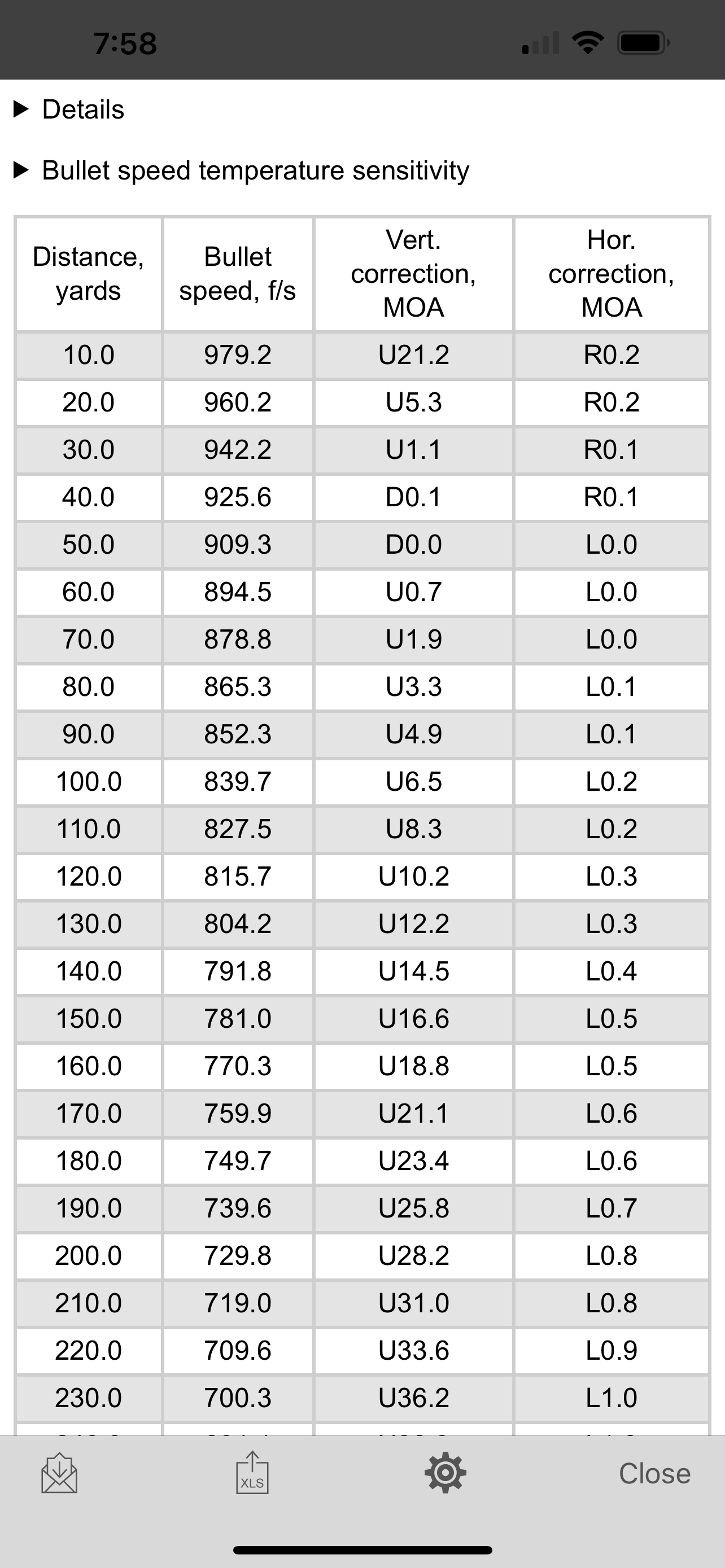

To take it a step farther
Here’s the same data with 1100 fps and .18 bc
I think he just increased the bc till it matched what he saw on target.
