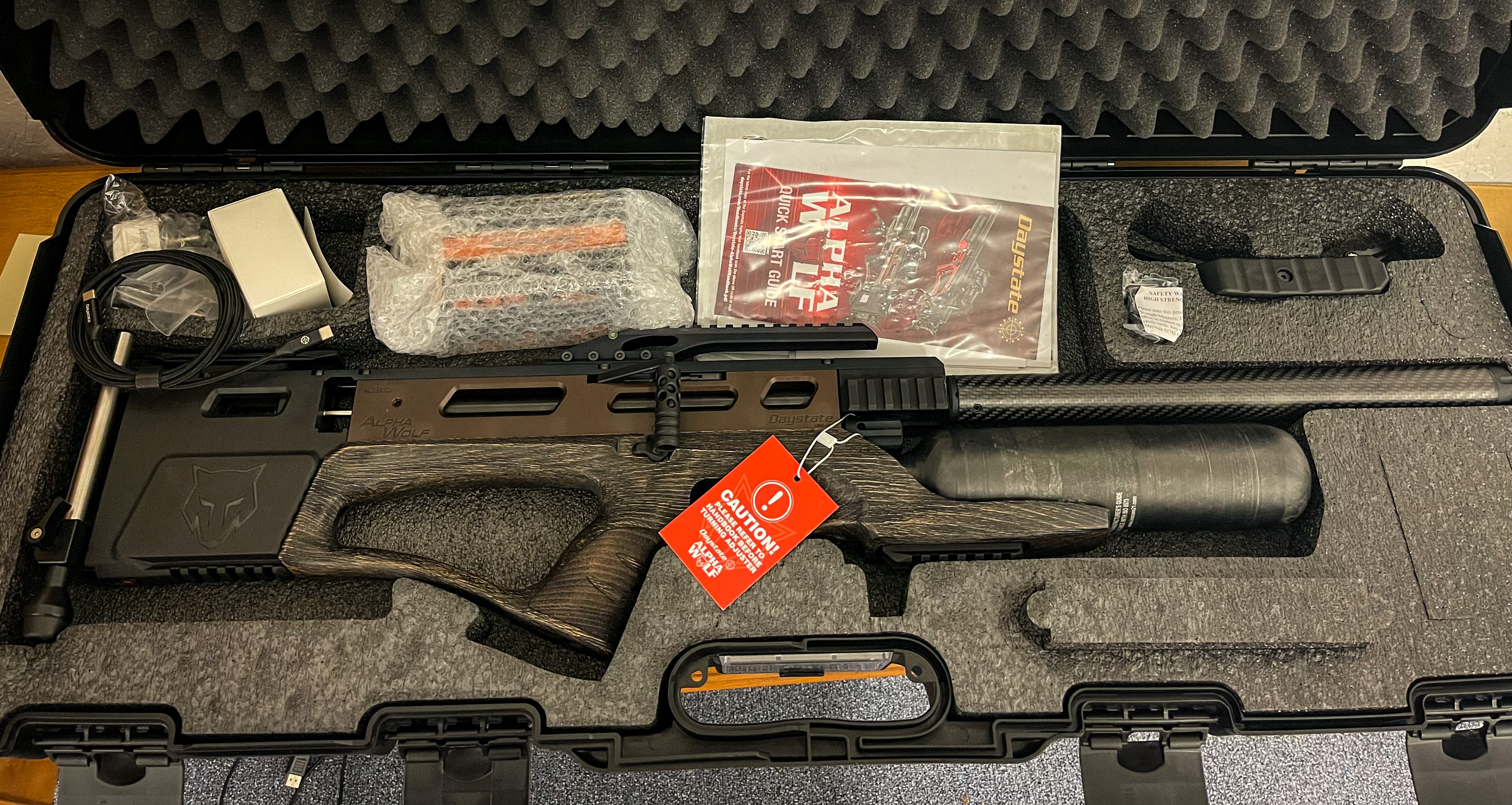

Just arrived at the office. She's nice, ladies and gents.
A lot of firsts today. First Daystate. First Electronic controlled rifle/trigger. First time trying an Athlon scope. First time trying a 0db Moderator.
