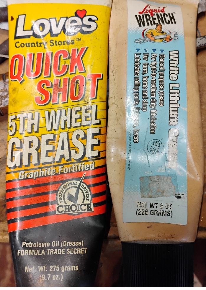

The lubes I use on hinge bolt and chisel detant.
5th wheel on hinge and white lith on detant . ( Don't take much a fraction of a dab..lol)
