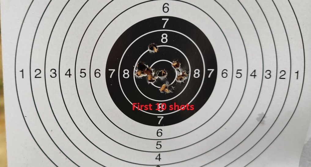

So i visited my friend to get the new rifle going, and after dragging the targets out to 50 M, which then upon measuring turned out to be 47 M / 51 yards we was ready to let lead fly.
I opened up the ball with JSB heavy pellets, which without trying too hard my gun was not that happy with, though also not horrible, but i think the barrel need to lead in a little before it will really like those, still i did manage to launch 300 or so of those.

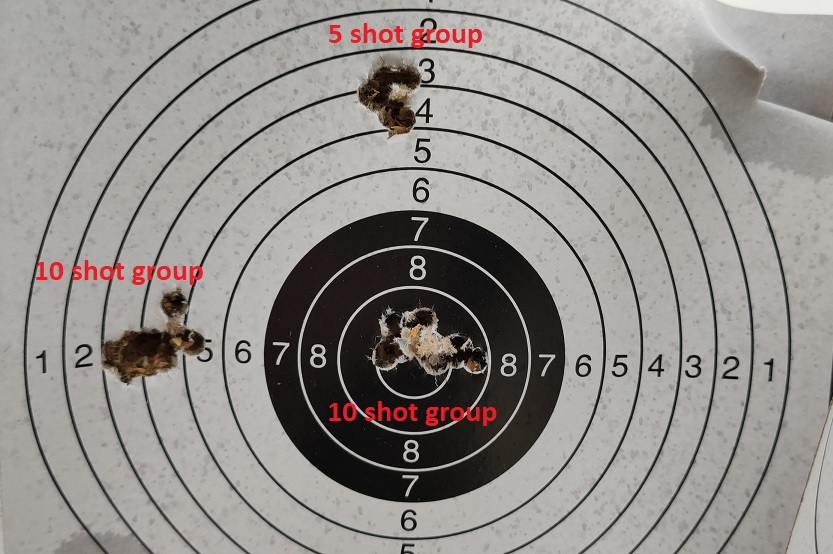

Then i changed to the JSB Monster redesigns and things at once looked much better, though in the change i also moved my scope as far back as it can, that also felt a lot better.
Anyway i snagged a picture of the first target shot with the heavies, and then a later target with 3 groups to it using the monster redesigns.

I do not have a crono yet, i will get around to getting one of those next month, rear reg is at 90 BAR and i was shooting at the 7 hammer setting for the M redesigns, hammer spring adjustment screw is at 3.9 mm.
