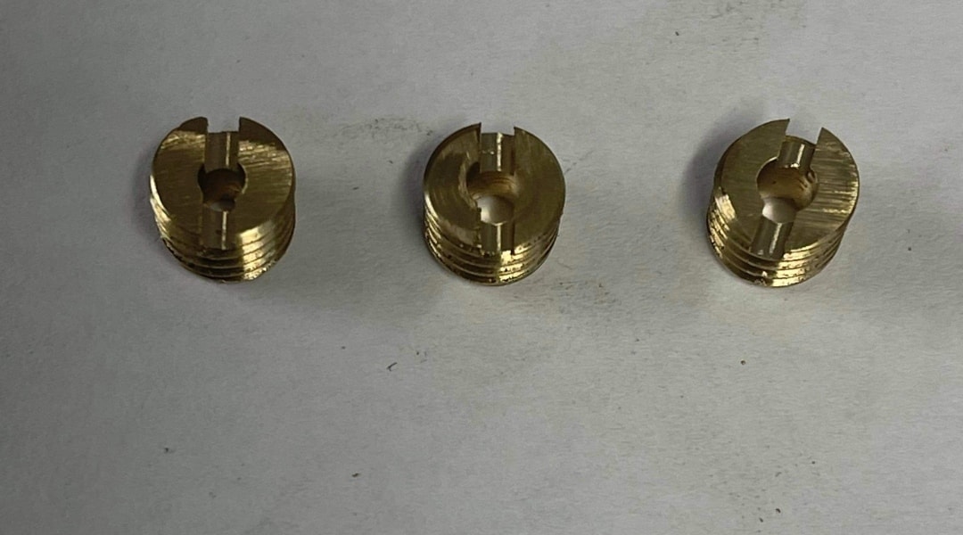

The Sub12s ship to UK with a threaded restrictor in the transfer port. If someone wants to tune for lower power they could probably experiment with different size holes in one of these.
