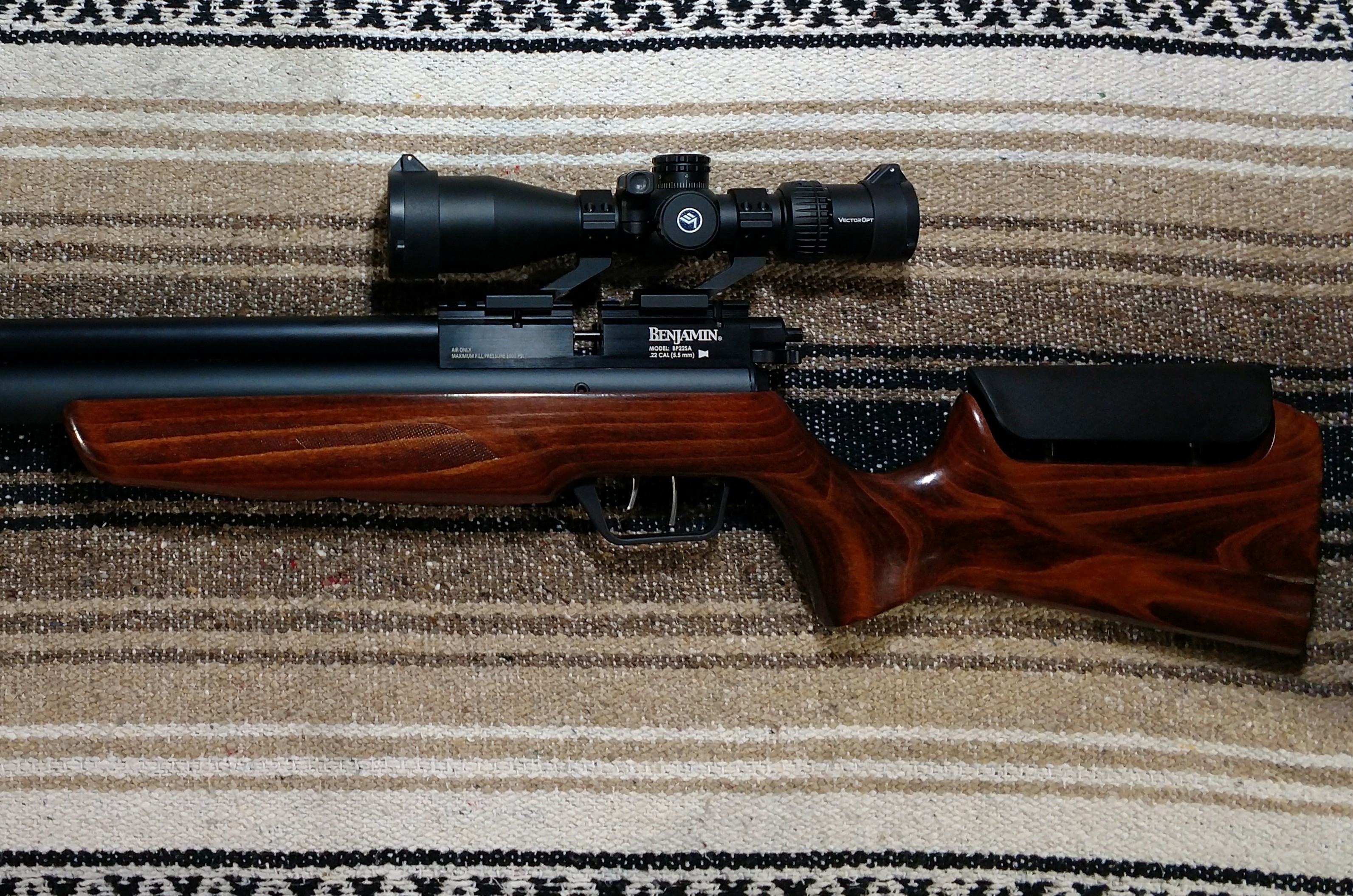

This makes a world of difference carrying and shouldering a Marauder: Monstron offset rings on Amazon to clear the magazine with a short scope, & the stock is chopped off an inch before the checkering and about an inch off the back, then it's stripped of factory pained finish, sanded and stained/final finish.
It is the shouldering of the rifle and not having the center of the scope being perfectly in line with your vision where most people feel uncomfortable. This is because they have to move their head to find good scope sight picture alignment. A scope with a perceived "bad eyebox" is generally fixed with a set of rings that are of the correct height to match the cheek weld and position of the eye.
