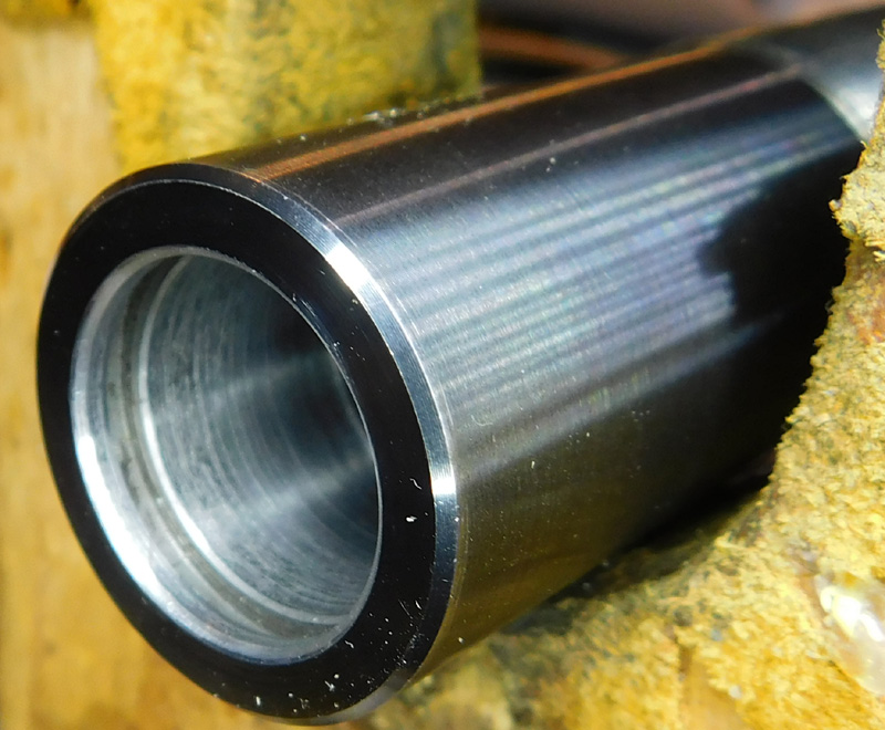

I have made a trade with a good old friend who has worked on Tokamak atomic reactors for the past 40+ years and he's an above exeptional machinist. Some home made/smoked bacon and a slap of home made cold smoked salmon, and my barrel will be finder than what AEA ever intended in the first place!
It will all happen thursday 29/12 or 12/29 for you lot ;-)
Cant wait to lob some pounds of lead with this thing and see what it actually can do tethered at 100m~110yds.
I will snap some pics so you can see what was done, next week.
So finally it is done :)
Hopefully some range time in the near future.

I pounded a round ball through mine this afternoon and with my old eyes and a manual micrometer i get @ .733"
Anything smaller and you are assured blow by and reduced power.

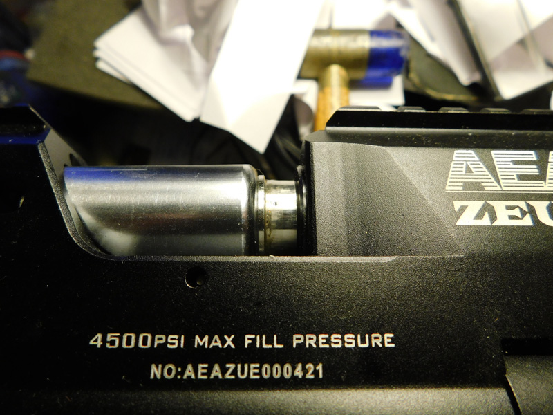

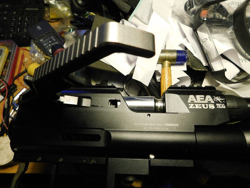

My bolt is so sloppy thet is cants and wont go into battery by itself, it needs a nudge.
Anyone else encountered this?
