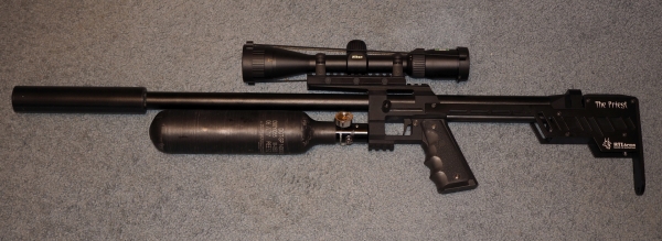

"TopAirMan"My Priest with a Talon Tunes CF bottle and JDS Airman 1800psi regulator. SWEET!
BTW, there is about .100 clearance between the bottle and shroud.
This one is set at about 36FPE in .22 cal. I also have the .177 kit for it and it is just as awesome!

was there any bugs to work out when the gun was new?
what was it that needed improvement?"Jman2311"I experimented an awful lot trying to make it better than it was when I got it. I failed to improve anything.

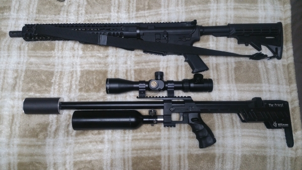

Please do update. I'd like to know velocity and what arrow you have to use. If it is interchangeable with the pioneer airbow that'll be awesome. very cool palbirds. Thanks."palbirds"First test firing of my Priest with test Arrow. Lots of work still ahead. Will update regularly.
