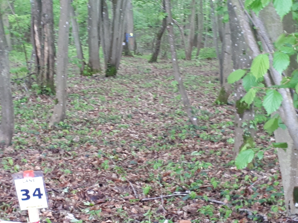

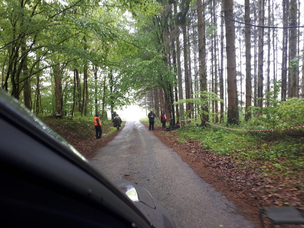

this is how we woke up..
small impression of the European championship... beautiful cake from AirArms!!!!!
Big thank you to all the sponsors.... visit the Benelux HFT site to see who helped us

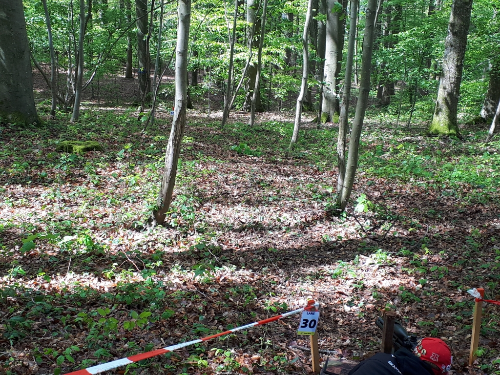

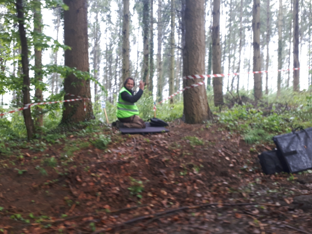

First day ... since I’m part of the organisation I’ve forgot my rainclothing.... we had four seasons in one day! My son was cold and I was wet after 5 lanes... so whe quit the first day.... 😞
next day, I didn’t do so bad! There was quite a bit of wind, some rain and had a day score that was in the top end!

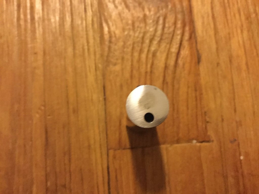

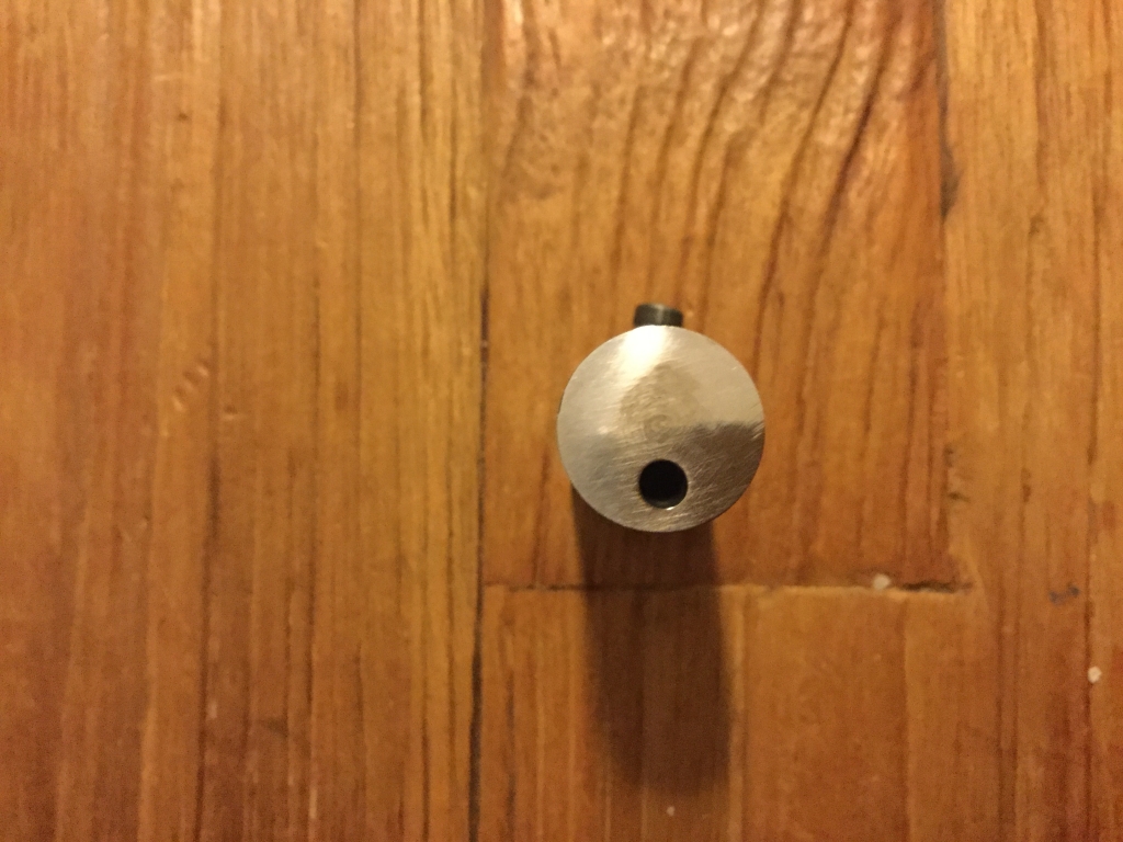

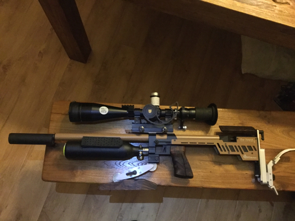

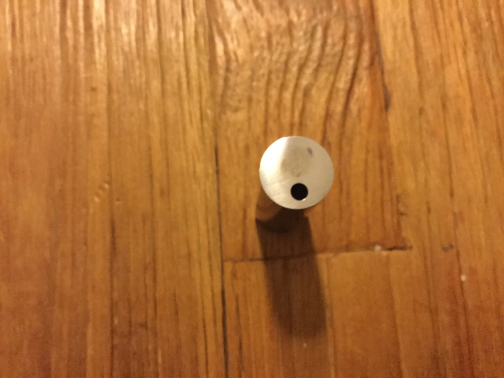

I promised to make a picture of my polished hammer cause if something is wrong it would show..... yeah?
ok here it is ... the hammer of the Priest 1 after 20.000 pellets!!
the hole I made because people assumed that inconsistancy happend because it couldn’t go past a air bubble, but it became clear that a metal preservatieve was the colporate, once removed bang on takdriver!!
but hammer ok, no wear.... stil surpasses any other bullpup.
Alex

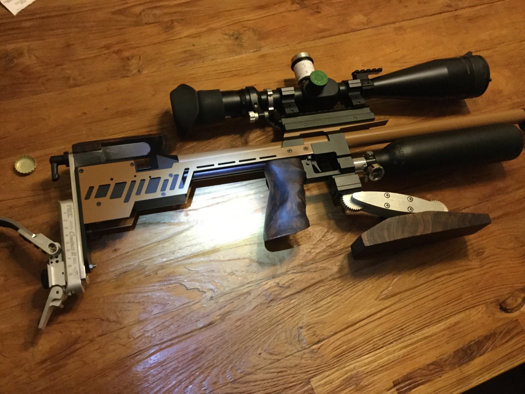

Hi vetmx,
I had inconsistency issues and after cleaning the hammer ( black gunk) and polishing it was bang on, I took a dremmel and grinded a hole but it wasn’t necessary.
if you have the first Priest and like me run it at say 12 FTP or 16 joules and have very good trigger control, then you may have to grind of 1 mm of you're hammer at the side of the catch... say 2/3 mm after the hammer surface... this prevents after release that the catch glides along the hammer surface while traveling towards the valve stem. Hope you can understand what I’m trying to say, because English is not my first language..
