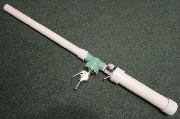

I've made all manner of pneumatic PVC "cannon". This is the stuff radar chrono's were built for. I may have to build a new cannon anew. They could launch a fin-stabilized rod at fearsome velocities - now that I have the means it would be interesting to see what those velocities actually are...
1. Was your projectile sabot'd?
2. I can't believe ThomasT sent a rifle *out* to be tuned...

Yupper, it took me a while, o-rings were hard.

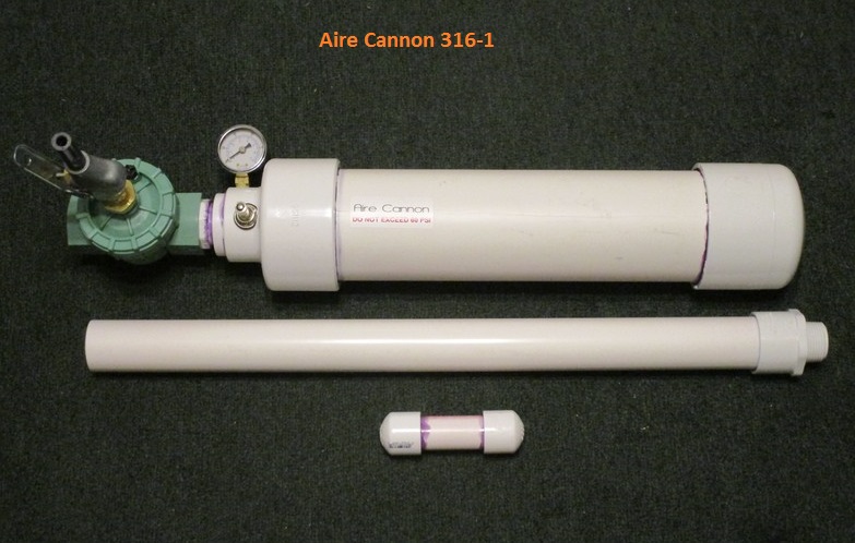

Hello @GeneT
1) No, the Projectile is made up using 2-each 3/4" PVC Pipe Caps ( Only certain brands will fit inside the 1-1/4" PVC pipe ) and a 3" long piece of 3/4" PVC pipe. Glue one cap on the pipe and then fill the pipe full with .177 BB's and epoxy, and the glue on the other cap. Solid as a rock and weights 1-pound. I also made them with no BB's and they are ROCKET SHIPS ..... wow :ROFLMAO:
2) The .177 is a Pistol and needed some fine tuning
ThomasT

How about some detail info on materials and how to build? I used to build lawn sprinklers.
Hello @mandn
Let me see if I still have the "build sheets" on this thing. I will look in my drawing computer and see if it is in there and at one time I had made a "How to Video" but pretty sure it is gone. I stopped using Youtube and I think all of that material was deleted.
I will let you know one way or the other.
