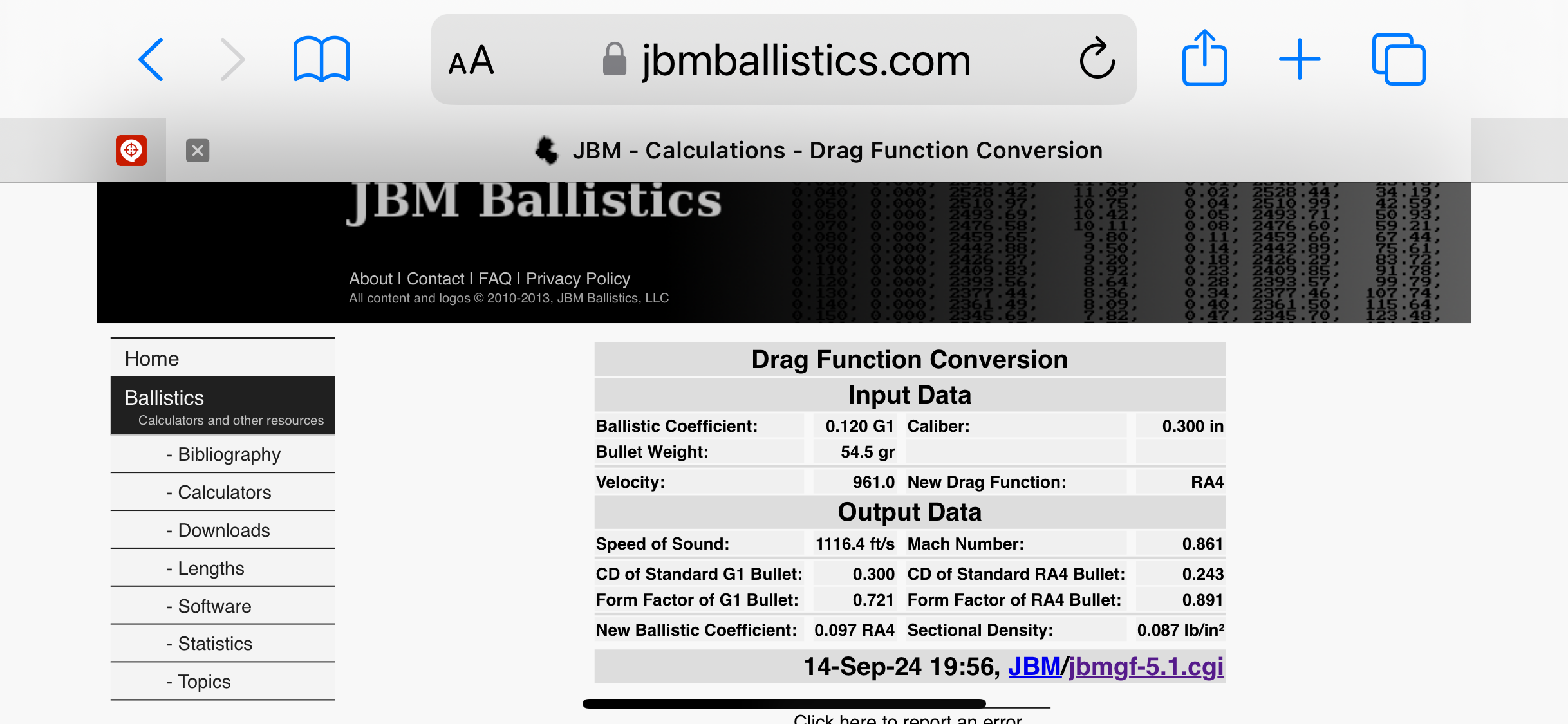

Why does the drag law I am being told, or recommended, to use in certain apps differ?
Why does the bc on the tin not match what the calculator says it will do AND not match what I see in real life?

I'm getting bcs from low .03s to mid- high .04s.
I've read some things that are way too complex that I don't have equipment for, radar and such, but we have been figuring bc on paper forever.

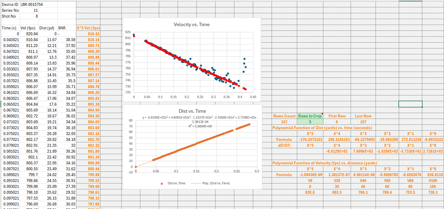

That’s all well and good for relatively short range where you are shooting under consistent conditions. But what if you want to shoot at distances well beyond what you normally shoot at, with different inclines, elevations, and environmental conditions, and you hope to hit the target on the first shot? Then you need a fairly accurate BC to predict how much compensation you are going to need.
For doing that, I think the Labradar is the best tool that is readily available for us hobbyists.
You’ve gotten to the gravy of what the Labradar can do. If you are so inclined, you can make good use of it.

Here's the same technique applied to airguns.
Owing to the fact that the final 4 data points are obviously very inaccurate, I added a cell to let the user ignore a number of rows from the tail end of the data array. So you can see that also.

I've attempted to fit ballistic solver data to my Labradar data and measured holdovers. Specifically, I used downrange velocities and drop/holdover to back-calculate BC and scope elevation. The fit was never good.
As for the consistency of conditions, I use wind flags and common sense. My home range isn't very windy but it's very switchy and will blow in any direction. So it's valuable data to see the spread on target as I shoot a series of shots as the wind flags shift and move.
That said, I now see that the Labradar velocity I was feeding into that method is spurious so using the velocity regression I just put together I'll repeat the process and also try to get my hands on some ballistic solvers that have more airgun-appropriate BC models. Hopefully that combination will give me better data.
** Also, if a pellet is spiraling, would it not appear to rise/fall over the best fit trajectory? Another reason for complete manual holdover data. The other effects like air density and incline angle are predictable and can be added over either calculated or measured holdovers.
How do you add air density over measured holdover without a ballistic app? And if you are using a ballistic app, you need a fairly close BC. At least for long shots. If your BC is incorrect, and you need to change your air density any substantial amount, the new POI predicted by the app will be incorrect.
If you’ve got spiraling, that’s a different issue.
