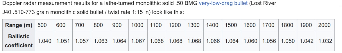

Aside from that..most external ballistic models will take into account the change of the conditions (air density and velocity), thus adjusting the bc within the model to represent the real world data being presented, such as the Pesja model, which uses a retardation co-efficient for any given slope constant factor if velocity data points are known.
The Doppler radar measurements disagree for a constant BC below...

"The initial rise in the BC value is attributed to a projectile's always present yaw and precession out of the bore. The test results were obtained from many shots not just a single shot. The bullet was assigned 1.062 for its BC number by the bullet's manufacturer Lost River Ballistic Technologies."
Does the BC change if I shoot a projectile at 150 fps versus 500 fps, 900 or 1500 fps, or 2500 fps? At Sea level, or in 30,000 ft? If so, its not constant.

I don't doubt your reasoning or logic entirely, however, current literature does. I find it hard to believe that every source I review on the subject matter is wrong.
"The Problem with Ballistic Coefficients of Bullets
Bullet ballistic coefficient (BC) values actually varies with velocity Mach number, so a bullet’s claimed BC is only an approximation for one part of a bullet’s flight path, usually the fastest part, right out of the muzzle to about 300 yards. Modern ballistic solvers often use stepped BC to account for this variation, and there is a push towards Doppler radar to measure a bullet’s true drag performance throughout its trajectory. While most manufacturers provide an average BC for their bullets, a Cd vs. Mach curve for a bullet will give a much better representation throughout the flight path. This is obviously not needed for hunting or most gong shooting competition which take place inside of 400 yards, but for PRS and long range shooting, it exponentially increases the chances for hits over longer ranges in varying wind and atmospheric conditions."
I could give endless citations that disagree with the statement "BC should remain constant based on projectile SD and FF"...however, I am uncertain you can give countless citations that support your argument, other than your word. Until such citations and articles are published, we're dealing with a Schrödinger's box...and discussing the matter on an online forum is far less fruitful than either editing wiki pages, or publishing your own articles via places like researchgate...
Then you add in, the effects of high velocity drag or high density air that could, alter soft leaded projectiles shape even microscopically, thus, producing a different BC even by your logic (alteration of FF), even if its by a thousandths, simply due to the velocity. Add in unstable flight at particular speeds for particular projectiles, the BC is clearly not the same in unstable flight as it is stable, thus, does twist rate not change the projectiles ability to overcome air resistance, or effects its flight path to some degree? AFAIK MERO doesn't have a twist rate input, but twist rates definitely effect trajectory? What gives? I ask because, I do not know, so please don't take offense to that question. Also, I will assume it does not take into account spin drift? A tumbling projectile certainly cannot have the same BC as one that does not tumble, or enter angular precession. Likewise, a rifle with no twist rate will definitely not have the same POI as one with a 7" twist rate.
It is in my humble opinion, stating BC should be constant is a form of idealism that can only be achieved in a perfect world, which we do not live in. If boundaries can be pushed thus breaking a drag law, then, they should be accounted for, such as "BC *should* remain constant in ideal settings with ideal drag laws applied"...however this isn't the case, and unfortunately the perfect drag laws for every projectile do not currently exist, and aren't widely known or accessible.
