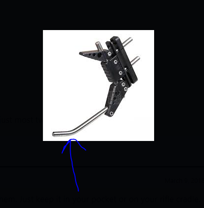

Isn't this a butt hook? An adjustable butt pad with a hook that slides on and off.
Its an add on piece thats flat with a hook on the end. Its not the adjustable butt pad/plate that we all see and use today.

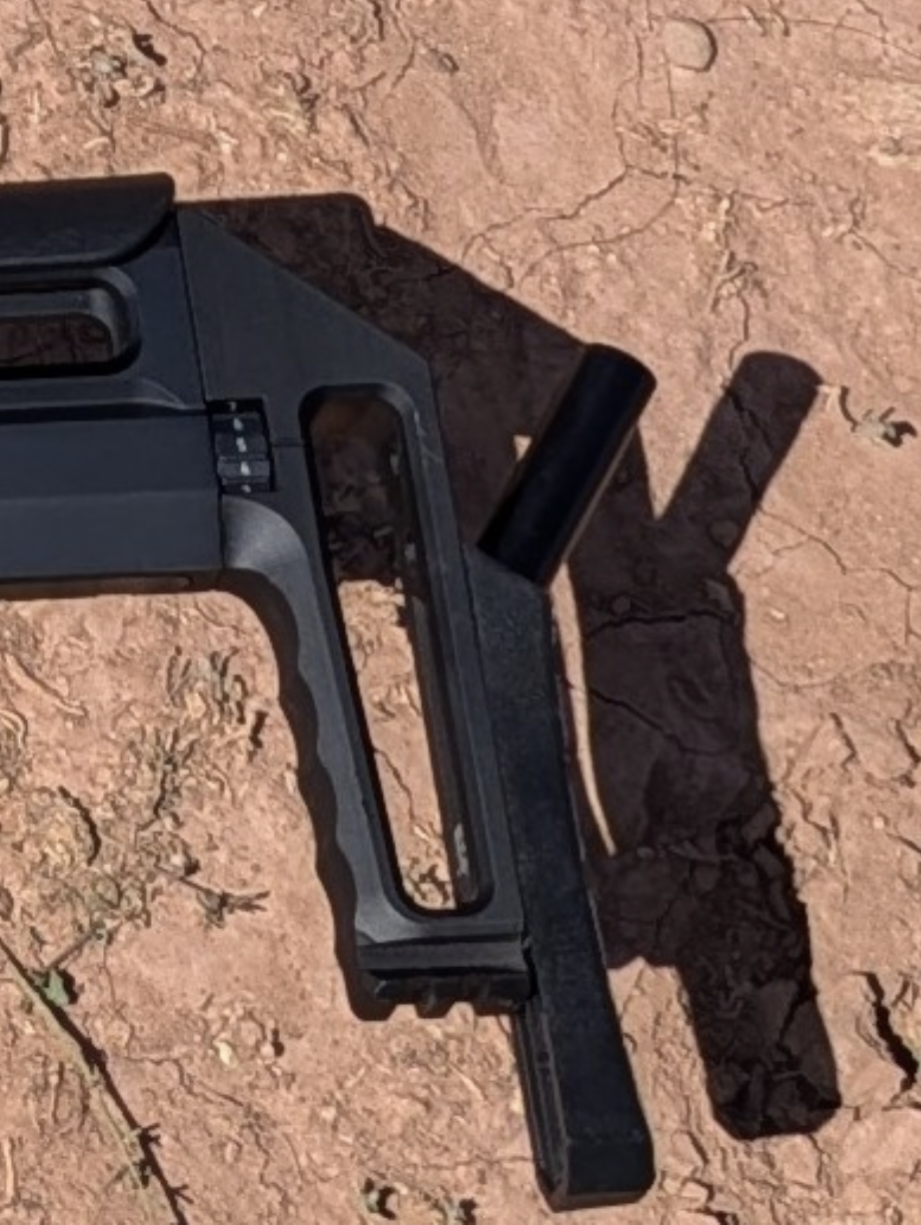

If a hook is considered common sense and well defined, is this a hook or not a hook? Is the top part of this butt plate a hook? Is the bottom part a hook?
I know the image above would not pass the ISSF equipment test for a standard rifle (i.e. 10m air rifle) because the ISSF defines a maximum depth of curve of 20mm for an air rifle butt plate.
The next possible gun configuration is the 50m free rifle, which has a definition of a hook. So what is the definition of "hook" that we should all follow?
Seems like their needs to be some clarification regarding this rule since there are people questioning what should be considered a legal butt plate for AAFTA Hunter, a butt plate that is not allowed to have a hook. If we follow ISSF rules, the picture of the 3d printed butt plate does not pass the 50m free rifle allowances at least due to the top part of the butt plate.
I would personally claim the 3d printed butt plate example to not fit within the rules of the hunter class, but there is an entire forum thread that argued about this earlier this year trying to make up parts of the butt plate assembly to circumvent what might be the spirit of the rules. Stuff like "that's not a hook, those are wings", or "the top part is a hanger" and since there is no limit on hangers you can do whatever you want.
I would lean toward defining the butt plate limitation in a way similar to what ISSF states as a standard rifle. Maybe 20mm is too shallow of a depth of curve for AAFTA Hunter, but something along that type of definition would make a measurable and objective rule rather than a subjective rule depending on what a MD thinks is a hook.
In my opinion, the hunter class rifle should resemble what other sports call a standard rifle, however that is not explicitly stated in the AAFTA rules. The rules simply state no butt hooks.
For reference, this is the current AAFTA Hunter rule (Hunter division rules, section "Shooting" part B, page 9 of the 2024 AAFTA rules) - there is no definition declaring what is a hook, or a hanger, or whatever else you might want to call it.
