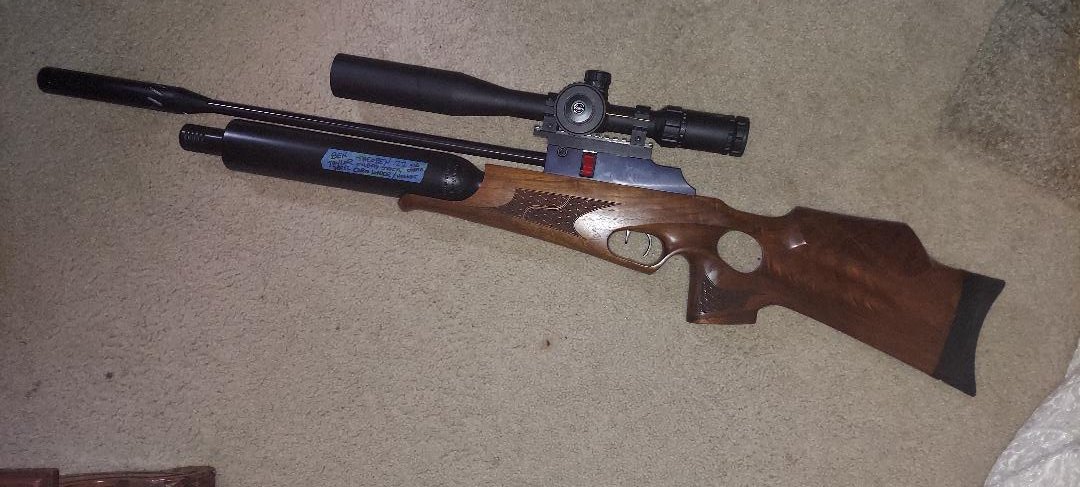

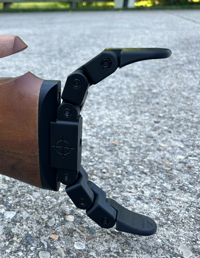

If a hook is considered common sense and well defined, is this a hook or not a hook? Is the top part of this butt plate a hook? Is the bottom part a hook?

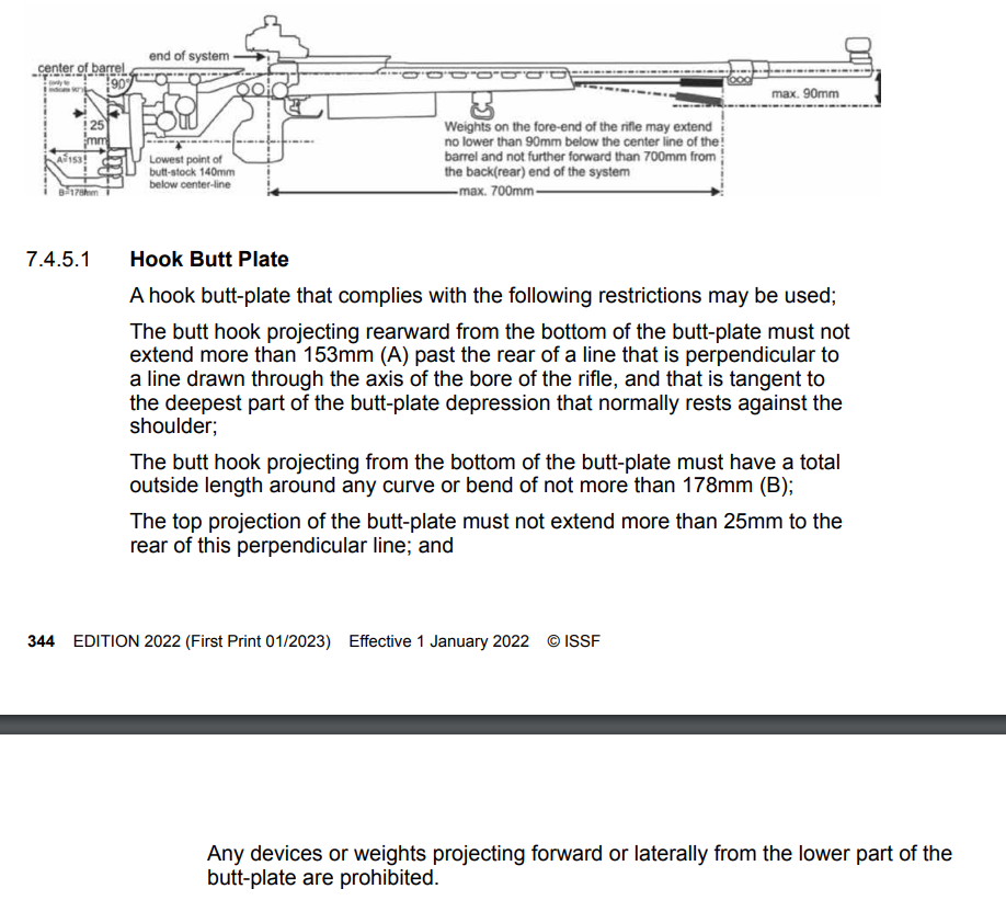

I know the image above would not pass the ISSF equipment test for a standard rifle (i.e. 10m air rifle) because the ISSF defines a maximum depth of curve of 20mm for an air rifle butt plate.
The next possible gun configuration is the 50m free rifle, which has a definition of a hook. So what is the definition of "hook" that we should all follow?
Seems like their needs to be some clarification regarding this rule since there are people questioning what should be considered a legal butt plate for AAFTA Hunter, a butt plate that is not allowed to have a hook. If we follow ISSF rules, the picture of the 3d printed butt plate does not pass the 50m free rifle allowances at least due to the top part of the butt plate.
I would personally claim the 3d printed butt plate example to not fit within the rules of the hunter class, but there is an entire forum thread that argued about this earlier this year trying to make up parts of the butt plate assembly to circumvent what might be the spirit of the rules. Stuff like "that's not a hook, those are wings", or "the top part is a hanger" and since there is no limit on hangers you can do whatever you want.
I would lean toward defining the butt plate limitation in a way similar to what ISSF states as a standard rifle. Maybe 20mm is too shallow of a depth of curve for AAFTA Hunter, but something along that type of definition would make a measurable and objective rule rather than a subjective rule depending on what a MD thinks is a hook.
In my opinion, the hunter class rifle should resemble what other sports call a standard rifle, however that is not explicitly stated in the AAFTA rules. The rules simply state no butt hooks.

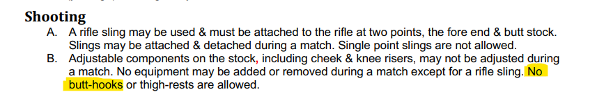

For reference, this is the current AAFTA Hunter rule (Hunter division rules, section "Shooting" part B, page 9 of the 2024 AAFTA rules) - there is no definition declaring what is a hook, or a hanger, or whatever else you might want to call it.

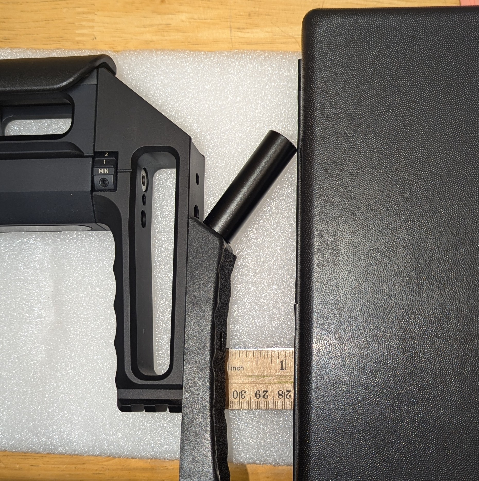

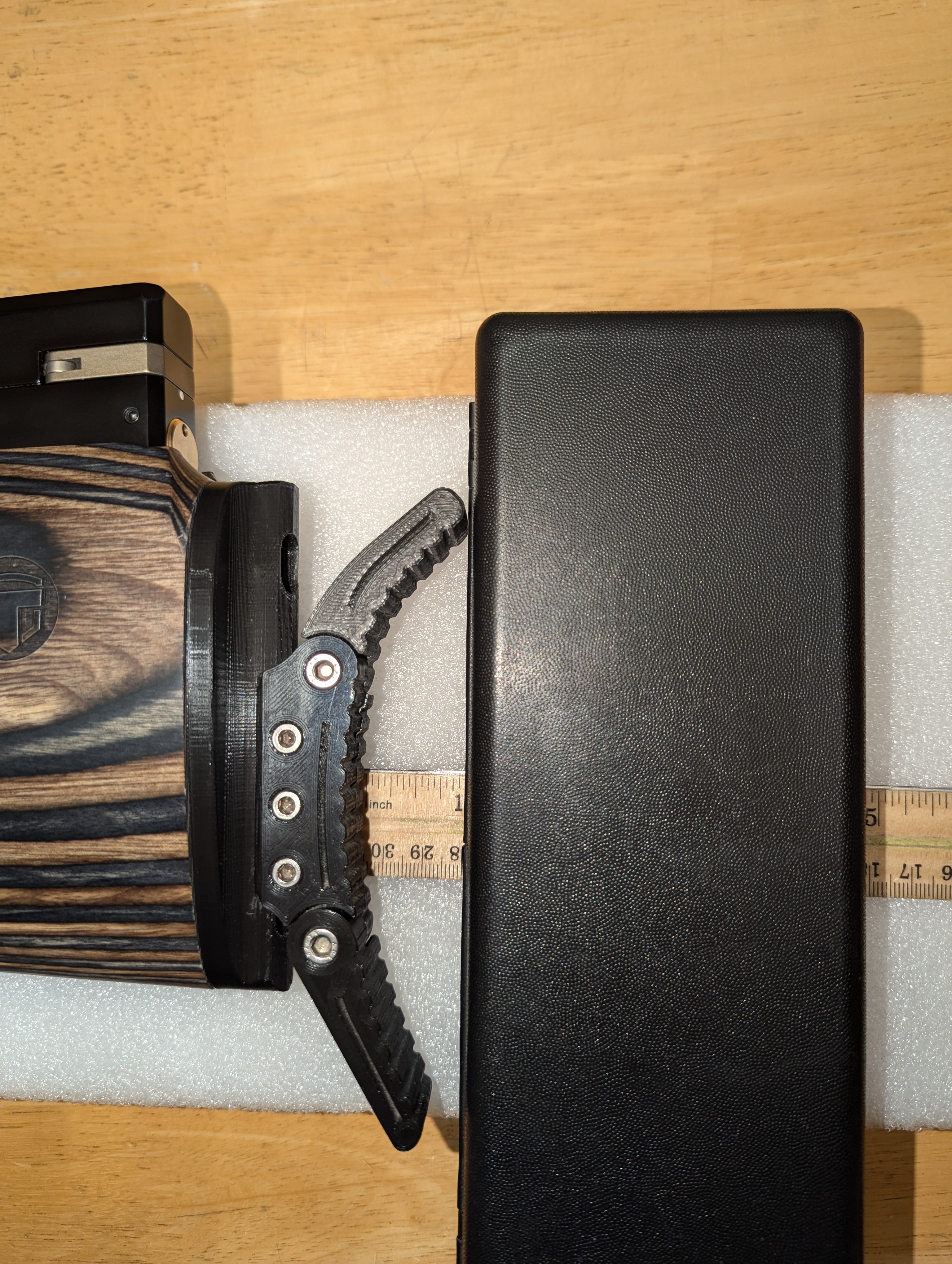

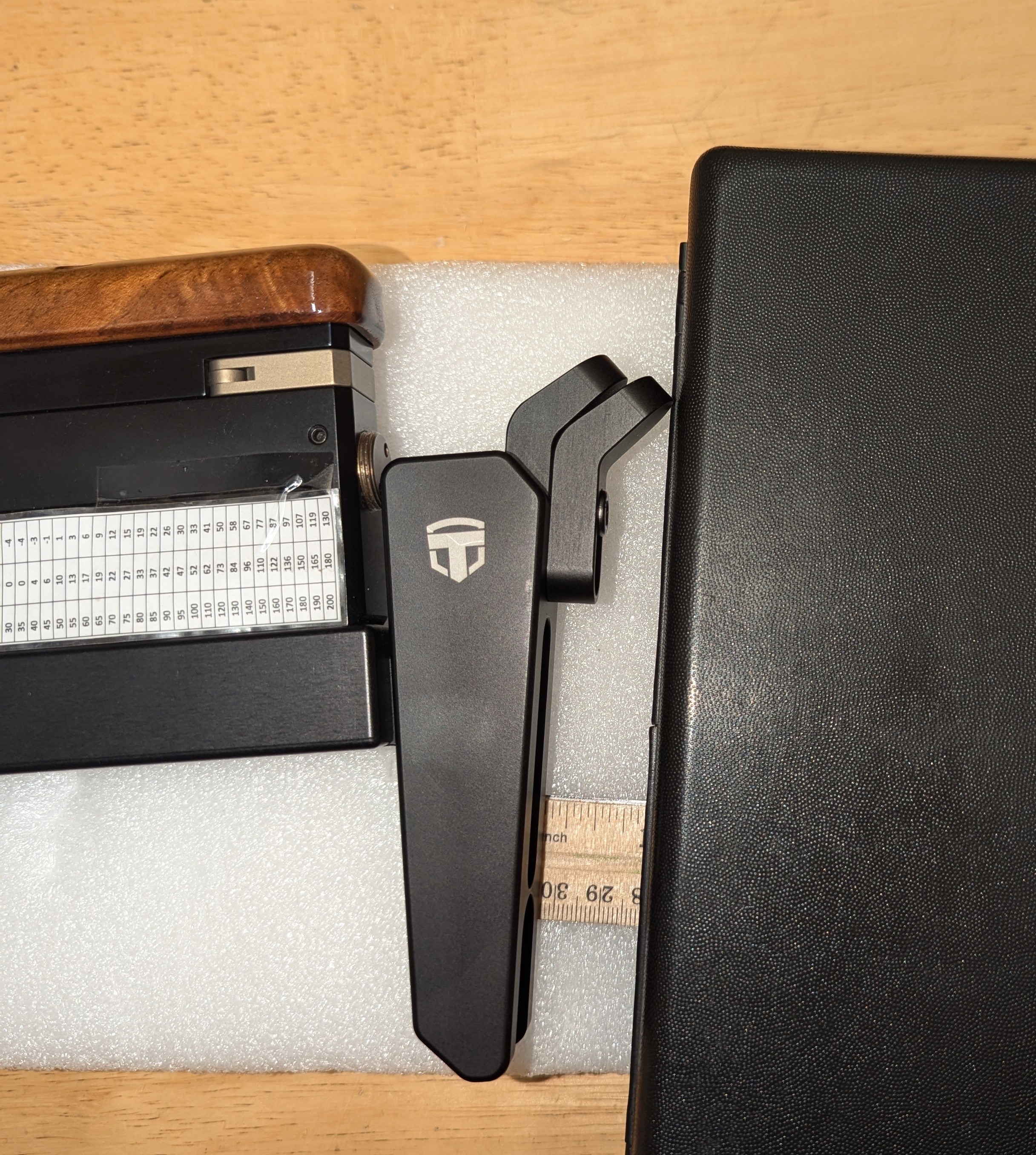

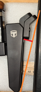

Out of curiosity I measured "G" on three personal rigs that I don't consider butt-hooks but might be subject to the new rule.
All three are right around an inch, the most being about 1.1875"
Although all three are much more hanger than butthook. All three seem fairly conservative to me, relative to true field target butt-hooks like those used in WFTF.

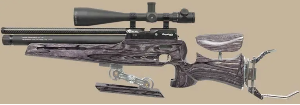

Ie THIS is my understanding of a field target butthook...
I believe your straight edge is supposed to bridge the top and bottom of the butt plate, and the measurements is the max depth. The butt that only has the hanger will end up having a much smaller depth of curve than what your picture represents. I am not sure how it will work out on the others.
20mm might be too restrictive from what is currently available, maybe 1.25 inch is a reasonable depth based on the current accessory availability and common implementations.
NRA High Power Rifle, another "standard rifle" type discipline, also identifies the allowed curvature for butt plate. It's still about the 20mm number, but is just another reference that can be used for guidance when clarifying/defining an AAFTA Hunter legal butt plate. (rule 3.15)
Yes, there's a gray area in how that particular "G" measurement would be taken. I was trying to keep my measured point parallel to the line that would bisect most of the buttpad. And then measure from the deepest part of the curve (when a curve is present).
If "cutting the corner" when no bottom "wing" is present, like in your photo of my buttpad, even more hangar would be possible than what I demonstrated with the way I measured.

In my opinion, the amount of curvature is less important than the length of the pad. Franklink's second photo with the 3D printed "Samson" pad is the way I have shot hunter in the past. You can't get too much more curvature and still have decent contact area with your shoulder. The photo from cavedweller looks like a Sub-Moa pad, I have used that for EFT complying with Ron's 30 degree rule. I also use that pad with a bunch of extensions on the top and a hook on the bottom for Open and WFTF.
I think when you start to get into a tricky area is when you add extensions or links to these pads. Increasing the effective length of the top paddle while increasing the curvature will give you more support by allowing weight of the rifle to rest on top of the shoulder.
The current Hunter class rules say no butt hooks. A butt hook is a bar that extends from the bottom of the butt pad under the arm. If you don't know what a butt hook is, now you do. Most match directors also extend the definition of a butt hook to mean the scorpion tail that extends over the shoulder. While not technically a butt hook, I agree that these don't belong on a hunter class rifle.
So my suggestion for a rule clarification would be "No butt hooks or extensions of the butt pad that are designed to extend over the shoulder or under the arm pit." If we want to be extra clear, we could add "Two piece or three piece adjustable butt pads should not have extensions between the paddles and the base. Butt pad paddles should be less than 2.5" in length."
Actually, we can clean this up a little:
"Butt pads should not extend over the shoulder or under the armpit. Butt pads with adjustable paddles should have the paddle attached directly to the base without extensions, and the length of each paddle should not exceed 2.5"
Then insert photos of legal and illegal butt pads. That would effectively make everything currently in use still legal and remove the grey area that is up to MD interpretation.
