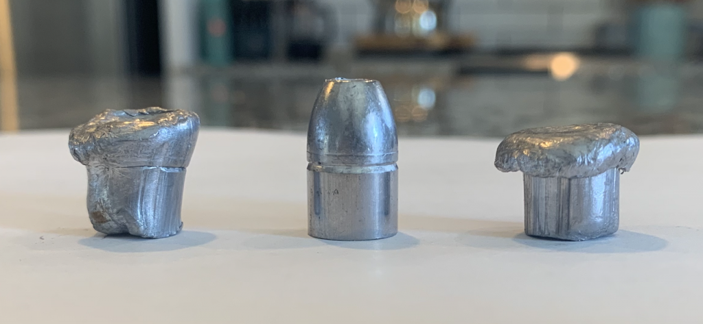

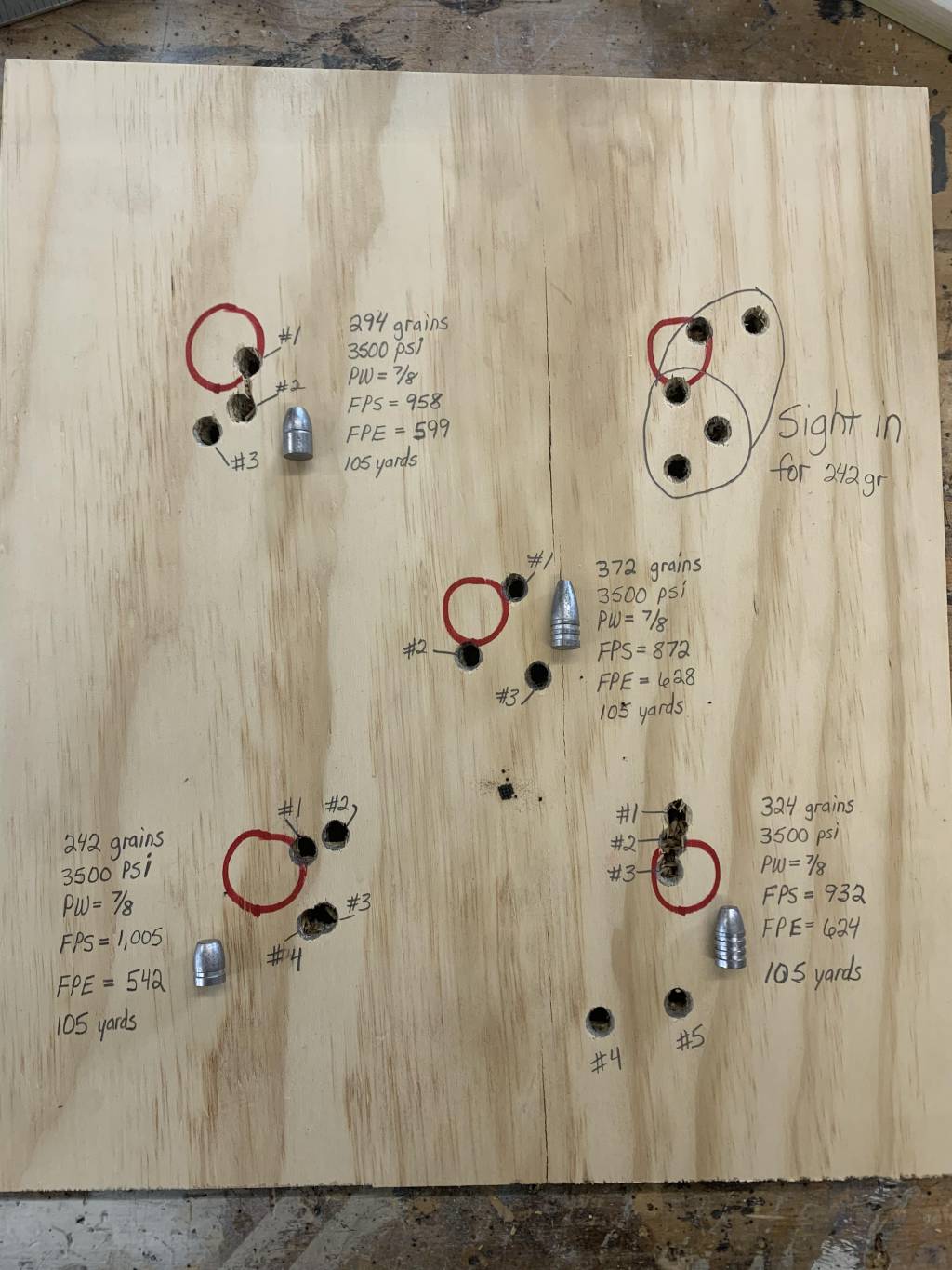

.357 Griffin LDC boat tail into shredded rubber pellet trap at 905 fps...I am pretty sure this will take down a coyote.
