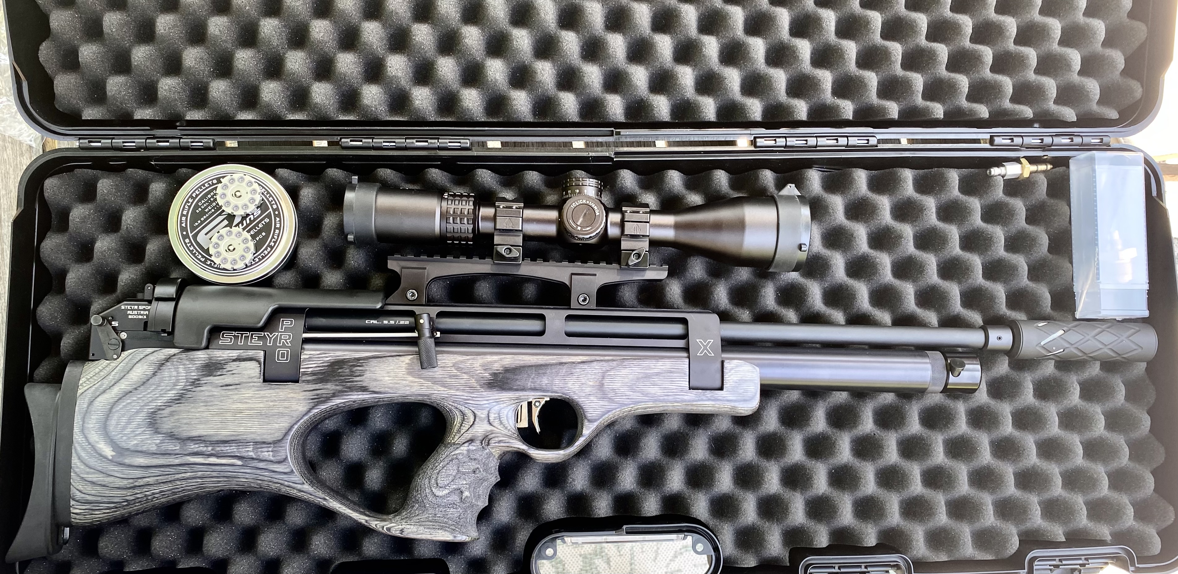

That's interesting about the loose pellets. I'd assume if they were that loose they would shoot poorly. I guess we will have to disagree on the trigger. I'm curious which bullpup trigger you'd put in front of this gun? I was able to put 5 shots on a moving target (squirrel)... I don't think there is an airgun trigger that can consistently do that besides this one.
As long as we stay in the subset of bullpups, I agree that the trigger is the best I've seen or used.

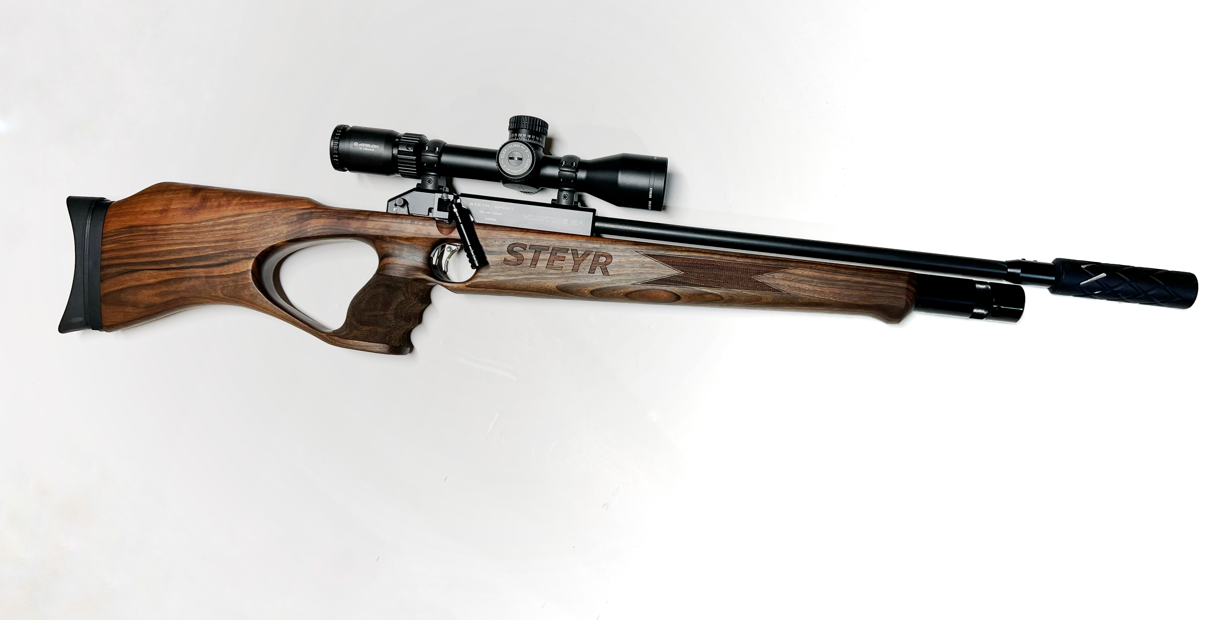

I have both the Pro X10 and the Hunting 5SA both have the power set to 40 J; both guns are stellar in all ways. Unless you spend time with a Steyr the feeling is hard to explain
Same here! Love both guns.
Interestingly, for me thy shoot the 15.9 grain JSBs a bit better than the 18.1. Both the 15.9 and the 18.1 generate almost exactly 30 FPE (40 Joules). What i don’t understand is the comment about pellets being loose in the magazine. In both my Pro-X and my H5SA the pellets fit the mags quite tightly, to the extent that i actually use a little tool (back end of a Sharpie marker 😇) to seat them in the mags. This is for both the 6 Pro-X mags (10 rounds) and the 8 H5SA mags (5 rounds each) that I have.

I did find both rifles Very Loud when I first got them. The Steyr slip-on adapter for a silencer was unavailable everywhere here when I got the Pro-X so I ordered one from Krale and it worked perfectly. For the Hunting 5 I couldn’t find the Steyr adapter even from Krale, but a DonnyFL 16mm one worked fine, so that’s what i have. The difference between the unsilenced guns and them with a silencer/moderator is quite dramatic. I never even take the mods off the gun.
One change I have made though, is to remove the weaver/Picatinny scope rail from the Pro-X and mount the scope using a set of dovetail mounts. I found the OEM scope rail raised the scope up too much for me.

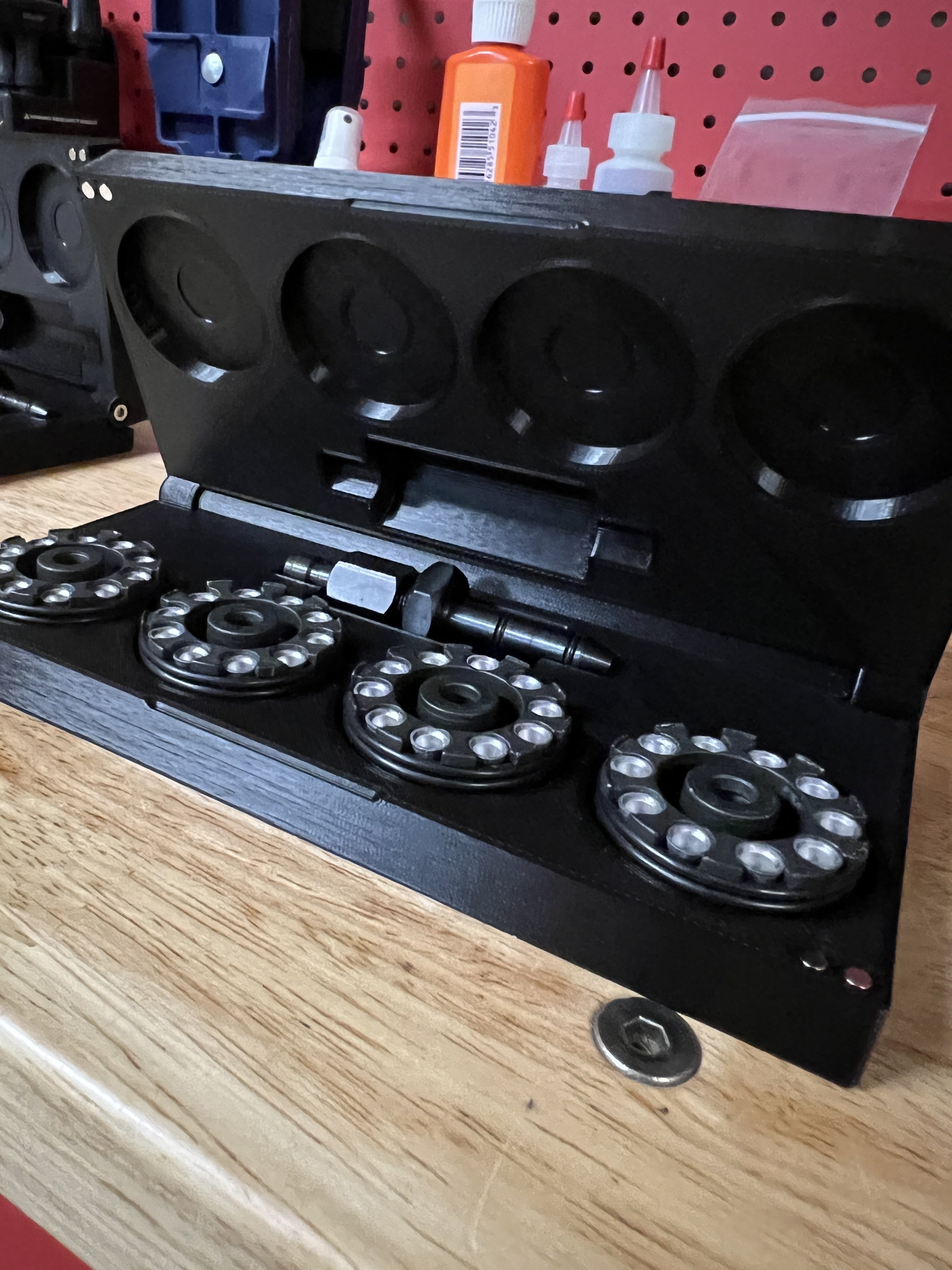

My pellets aren't really loose in the mag. I shoot JSB's and seat them completely flush with the muzzle side of the mag, using whatever is close by such as pencil point, pen or Bic pen top. They do take a little pressure to seat them.
The problem is when the mags are loaded with pellets it takes very little to knock the pellets out. If loaded mags are put in the foam Steyr case half of the pellets have fallen out of the mag the next time the case is opened. Can't even think about putting loaded mags in you pocket. I have the same situation with the mags for my Hunting 5 auto.

I’ve had the Hunting 5 for about 4 years now. Other airguns have come and gone, but my Steyr is a keeper. I found the triggers to be a little heavy. But either Marlon Layton or M Mahoney had some lighter trigger springs and that changed everything. Like a match trigger now. I was also lucky enough that a member had lathed the end of a barrel to accept a moderator. Whisper quiet. I use a Bic pen tip to push the pellets into the magazines. By pushing against a flat surface the pen cap flares the skirts off the pellets and seals the magazine holes. A fingernail push on the other side makes sure the heads don’t protrude outside the front of the magazine. Of course my mags only hold 5 shots, but I load 8 at a time and am usually topping off the air in my gun. Yes, they’re expensive, but I feel I’ve got my money’s worth is ease of ownership (they’re very durable) and smiles. There is nothing worse than a miss, but when you can see the pellet splash, realign and make a solid hit- priceless! For all you new Steyr owners, be it bullpup or dinosaurs like me, enjoy!

A company called kube makes these mag holders note this one is for weihrauch :
