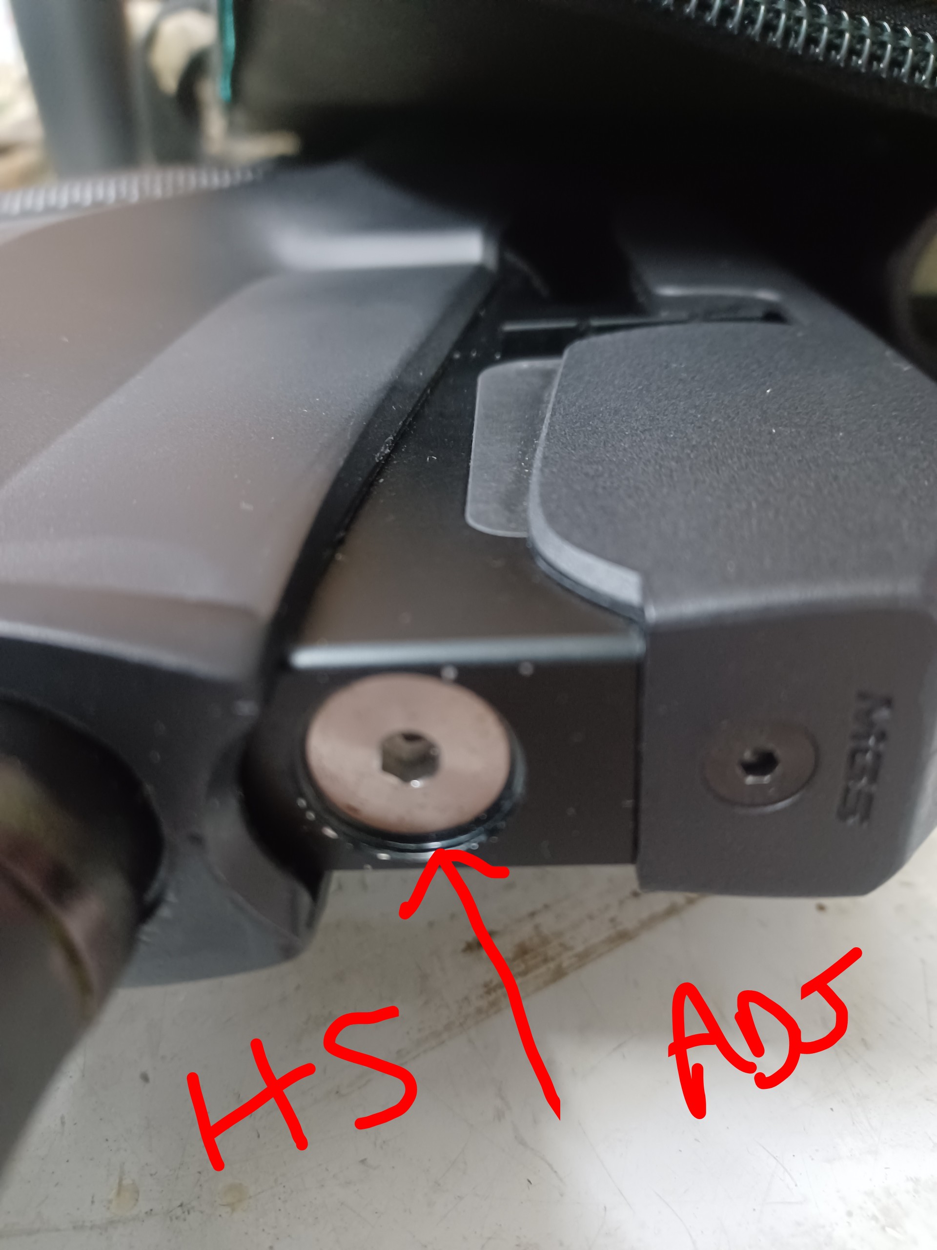

BULLSHARK IS REGULATED AT 120 BAR
You have to remove the cheek piece and you will see the screw. Mine was turned in all the way when I got it. Backed it out 1 1/4 turns to set to my pellet weight.
There are two possible places when I remove the cheekpiece actually one you don't have to remove the cheek piece is possible for you to take a picture of it?
I will get a picture posted soon.
