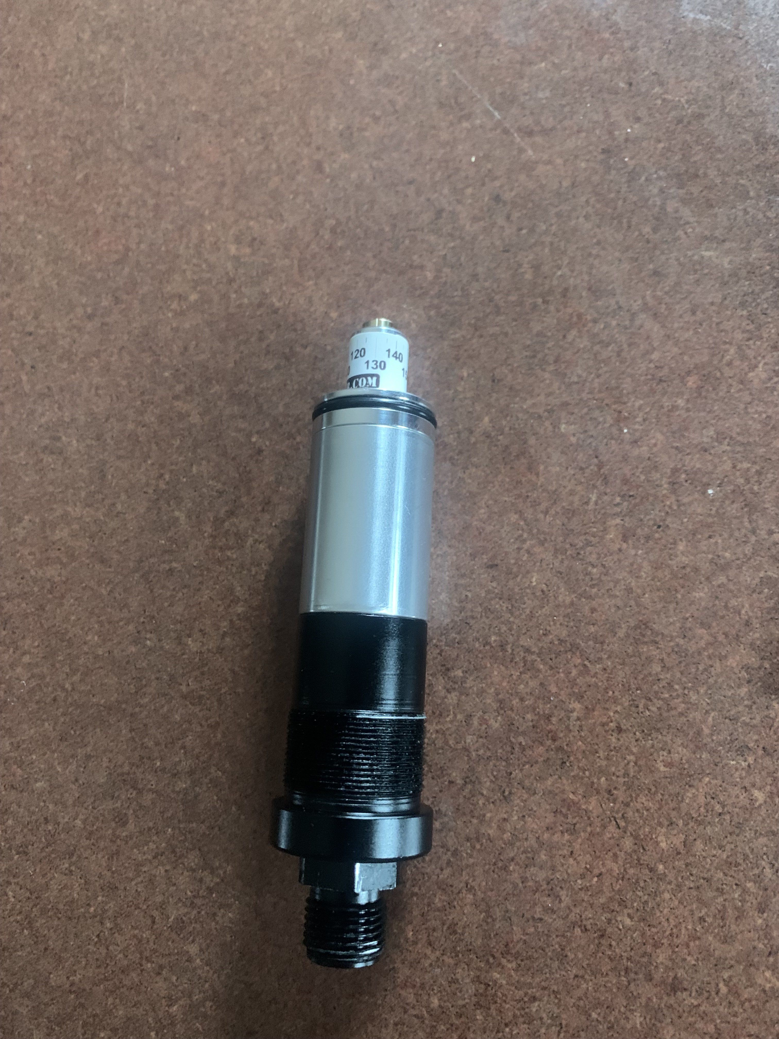

I was able to install the Huma regulator and plenum In mine, however, the oring at the end of the air tube tore and now I’m SOL until I can get another one. I can’t wait to try it
