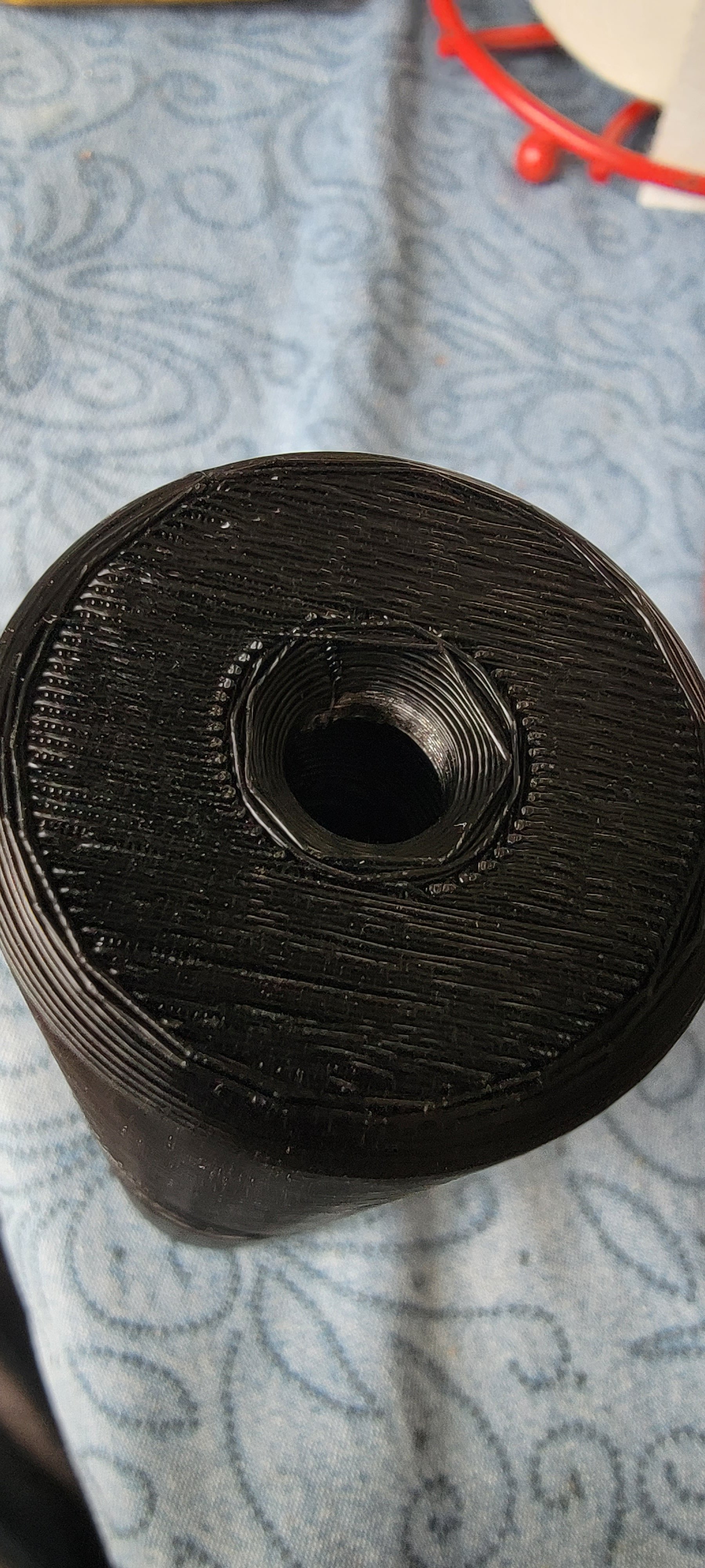

Well......they say that you get what you pay for. I bit. Purchased this moderator in .25 cal and immediately went from 3/8" group at 40 yds to not even hitting paper (14×18) at 25 yds. I gave up. It's not like it's going to improve. I took it off, and threaded my old Neil Clague unit on, and was immediately back in business. Results speak loudest.

Got the chance to try out the 25 cal. moderator today. (n)clipping 👎
Get yourself a chain saw file. Slip the moderator over it and spin it against that. It is just the right thing for cleaning out a tube like that. It doesn't take off too much at a time. If there is "fuzz" visible get a lighter and just VERY BRIEFLY (maybe one second) move the moderator over it like a chimney. If your threads are printed and not metal that will not work as the threads will suffer.
