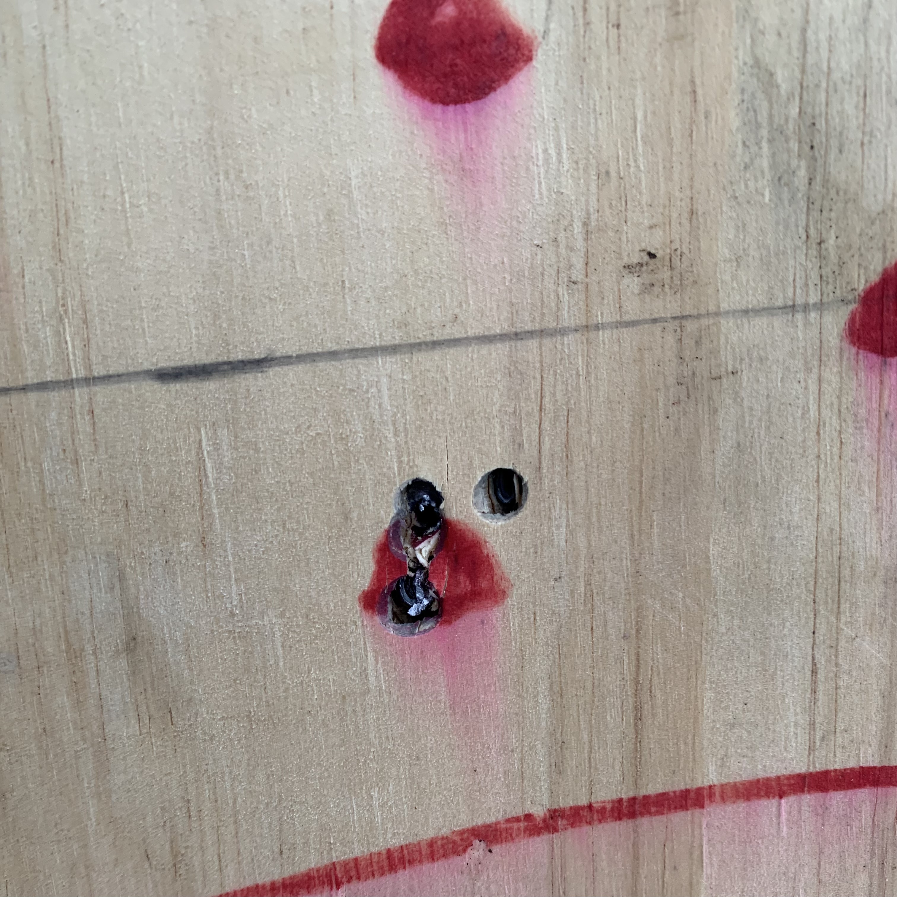

That's an interesting build, what kind of grouping will it hold, at say, 30yards?

We’ll , it’s not a R7. .. because it’s a long stroke it’s balanced and does not load at the end .. It uses wire thinner than the R1 factory spring.. .148 is stock R1/hw80 .. I’d say like a Hw 90. In this one I’m testing gas rams , In airguns there is a fine balance of weight spring and port size and more so length.
