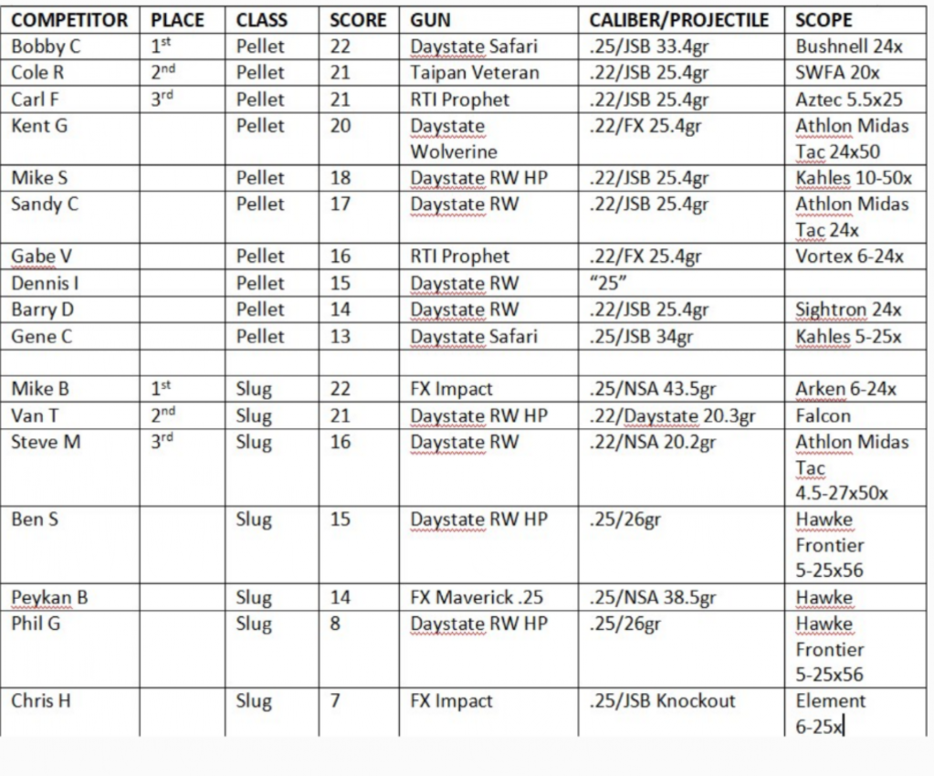

Back to the Extreme FT events. There are only two classes (both limited to .30 and 100fpe): slugs or pellets. And whether the shooter picks slugs or pellets, they have to be commercially available. The Extreme FT rules have removed many of the other variables. Max scope power is 25x. Shooters can click or holdover. None of the gadgets that normal field target shooters use are allowed in Extreme, so there aren’t butthooks that wrap under and around the shoulder, nor are there 1 foot tall knee risers. As for position, shooters are all sitting on a stool or bucket (although bumbag is allowed, just gotta have feet flat on the ground), and using shooting sticks and shooting from a reasonable position that just about any “gun person” (firearm or otherwise) would recognize as a normal way to shoot a gun. You know, stock of the gun where it is supposed to be, buttpad pulled up to the shoulder/armpit, cheek resting on the CHEEKPIECE, trigger hand on the grip of the gun, non-trigger hand supporting the forearm of the gun, gun resting in shooting sticks in the normal way. None of the contortionist stuff going on, or guns missing substantial and usually necessary portions of their stocks, or guns literally bolted down into rail-gun like artillery pieces. Just good ole-fashioned, shoot a gun like it’s traditionally supposed to be shot, positions.
So, we’ve got slug and pellet shooters using the same shooting position, taking 40 shots at the same targets, from 20-100 yards, no wind-flags (would introduce the variable of who has spent more time shooting over the top of wind flags and can read them best), no unlimited sighter-shot silliness (whose gun has the biggest booby bottles and mag capacity), in the same roughly 2 hour window of weather conditions, with the same caliber limit and fpe limit and scope mag limits, all with hits and misses being recorded by an impartial witness. Really, about as fair of a comparison between pellets and slugs as we’re likely to find. (yeah the guns and barrels are a variable but it’s not realistic to think that we’re going to find a particular gun/barrel that shoots pellets just as good a slugs, or vice versa so that we could compare pellets and slugs from the same gun).

The slugs gotta just be killing it right? The guys shooting slugs have just got to be scoring so much higher that the pellet shooters are completely demoralized…………NOPE. I think we’re up to 4 monthly matches now and the high score from the pellet shooters and the slug shooters has been very similar each month. Last month both classes’ high scores were identical.
And we’re not even shooting at crazy-hard targets like a dime at 100 yards would be. We’re talking 2 inches at 100 yards being on the extremely hard end of the spectrum of target placement thus far. Nor is there any kind of $$$ limit on the rigs that can be used. And there are some guys using PRICEY gun/scope combos already and all indications suggest that is only going to keep going up.

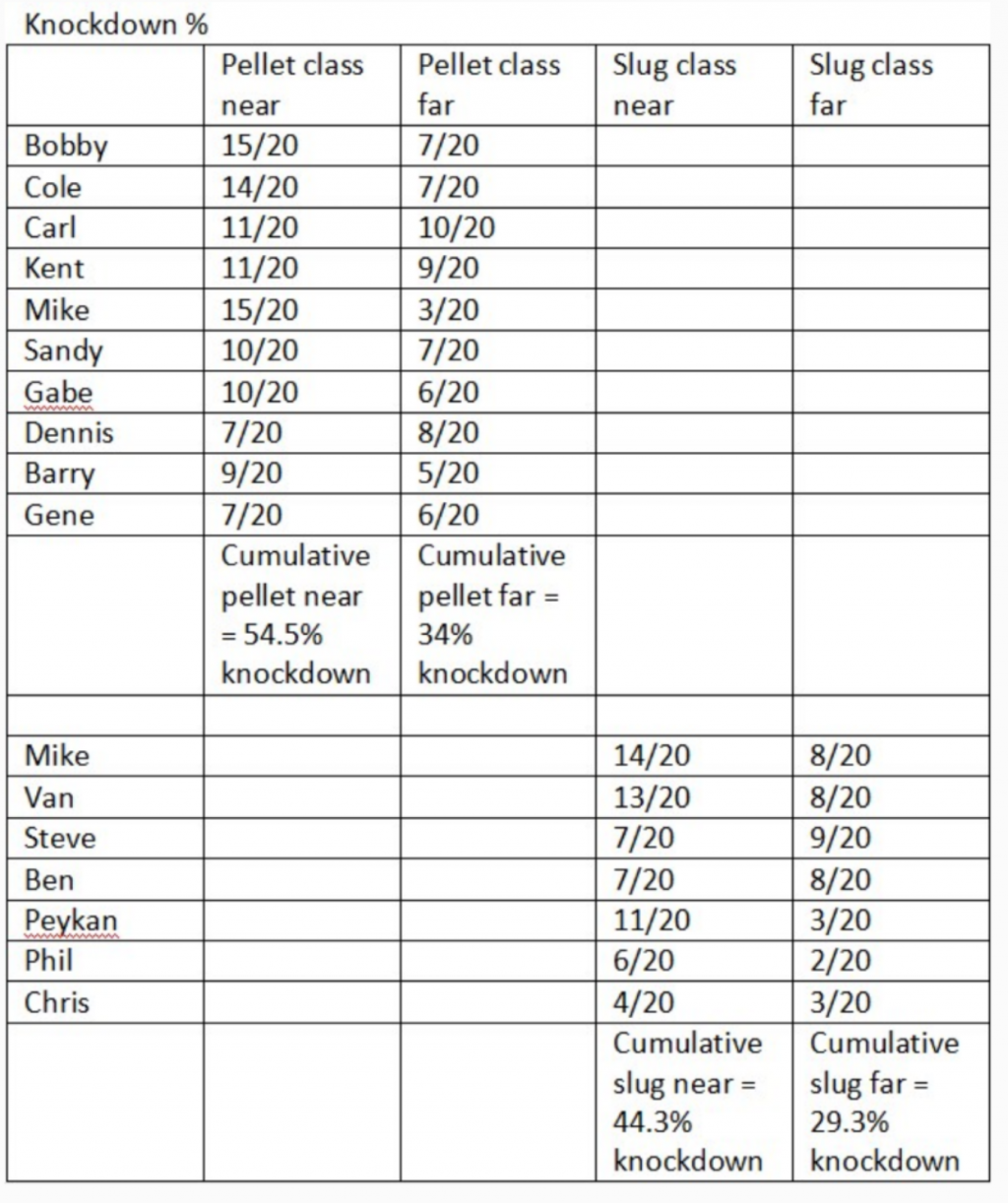

So, what’s going on here? Why doesn’t that superior BC equate to higher scores from the slug shooters in about the most fair comparison between slugs and pellets that we’re likely to find?

So, what gives? Is there anybody out there repeatedly and consistently getting better groups with slugs than pellets?

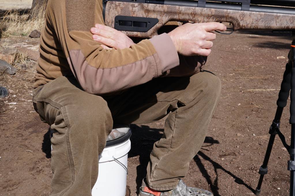

It's interesting that most people that have shot EBR wouldn't dream of NOT using wind flags when shooting at 75Y and 100Y, but we can't have a few pieces of surveyors tape up on the hill placed in random spots to at least get an idea what the wind is going to do to our projectile??!! Going to any rifle match when the top shooter being a former FT national champion is only getting 22/40 seems silly to me, also a former state FT and former 50Y EBR BR national champion only gets 17/40, but whatever, you (anybody) do you, while I'm equally welcome to my opinion. BTW Cole, there's a big difference between a using real wind flag designed for BR that someone shoots over in practice and a steamer that's 30Y to 60Y in either direction up the hill aways. I think this deserves a trial run at least!

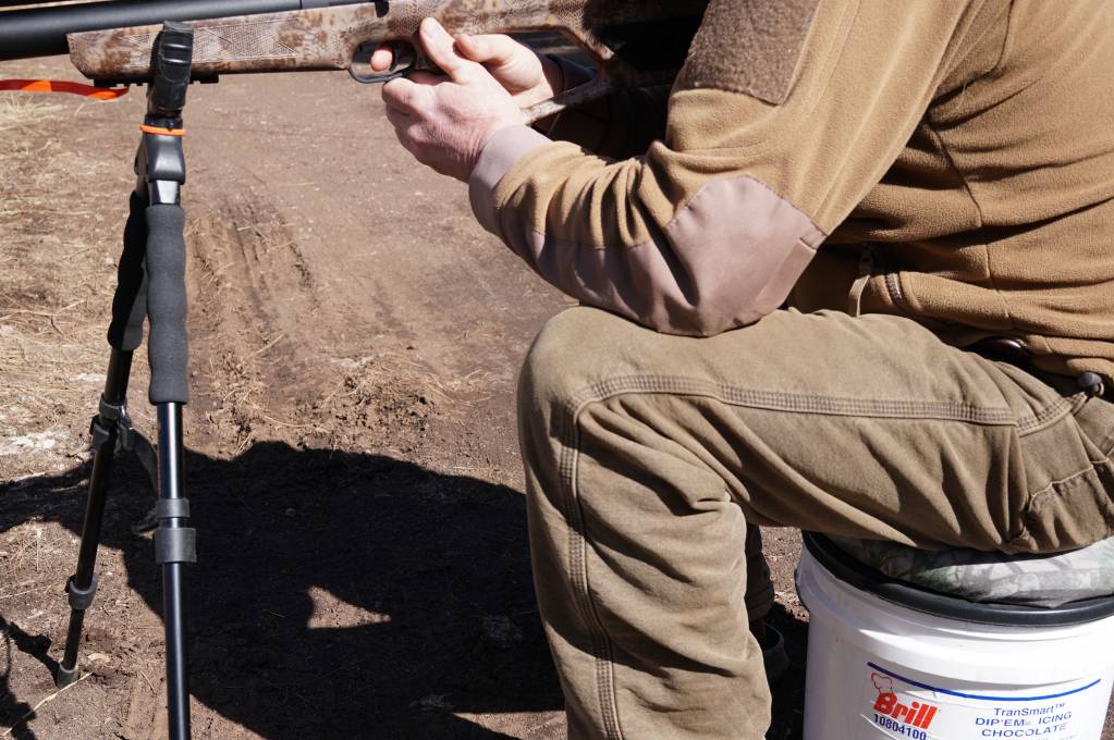

As to "any reasonable position" and your assertion here "non-trigger hand supporting the forearm of the gun", well ALL OF THIS needs to be specified EXACTLY in the rules as to what is acceptable or not. For example I saw one of our dear friends at the last EFT holding the grip of his gun with both hands, butt pad into shoulder, elbows on knees, and gun resting in the saddle of the sticks, like in pic #2. Would he have been DQ'ed because he didn't hold the forestock? Except for offhand and kneeling, I never hold the forstock in a traditional manor, my hand is on the shooting sticks upper frame and I bet quite a few of us are doing that or holding one of the legs, like in pic #1. I've also rested the bottom of the stock on my arm with my support hand holding the butt like Pic #3. Honestly I see zero difference in "my" wobble factor between these three positions and they are all comfortable.
Anyone care to discuss what "reasonable position" means?

As for the position, some of my description of the positional aspects were just my personal thoughts and opinions, specifically about the non-trigger hand supporting the forend of the gun. I'm not in charge of any of this, just somewhat active in sharing my thoughts and opinions, but the "reasonable position" is entirely my creation. I don't think the wording in the "official" rules say anything similar to "reasonable position." As for my opinion (which counts for exactly 1 vote if it comes down to it) I don't have any issues with any of the ways you showed the gun being held, they are all normal ways to shoot off a bipod. It gets a lot more questionable when the gun is laying across legs, or sitting on top of a knee or not contacting the shoulder, etc. I hold it kinda like the first pic that you provided, just with my hand up at the top of the sticks. My hand sort of wraps around the junction of the sticks and the forearm of the gun. I wasn't trying to turn this into another debate about positions, just give a brief enough description of the allowed position for everyone to understand that we're all shooting from the same position. My one vote on position will always be that anything that affords someone an unfair advantage will be a nay from me.

P.S., all three positions demonstrated above by Steve with that bad ass .30 Vulcan2 are reasonable...
