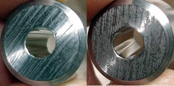

Secondly , I see 4 current barrels FX , CZ , LW , polygonal , also heard of TJ's barrels - not sure what their design is. FX barrels seem specifically designed for the hybrid FX slugs. The others , more universal. Now too me it appears barrels with deeper grooves would cut deeper into the slug , affecting it's flight for the worse , so are shallower grooves the way to go? Lastly , the polygonal barrel confuses me with the shape , are the lans and grooves straight? If not , how on earth does it work ?
