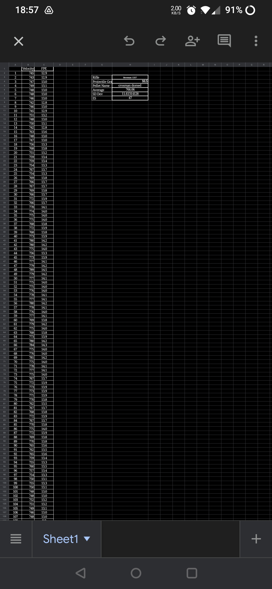

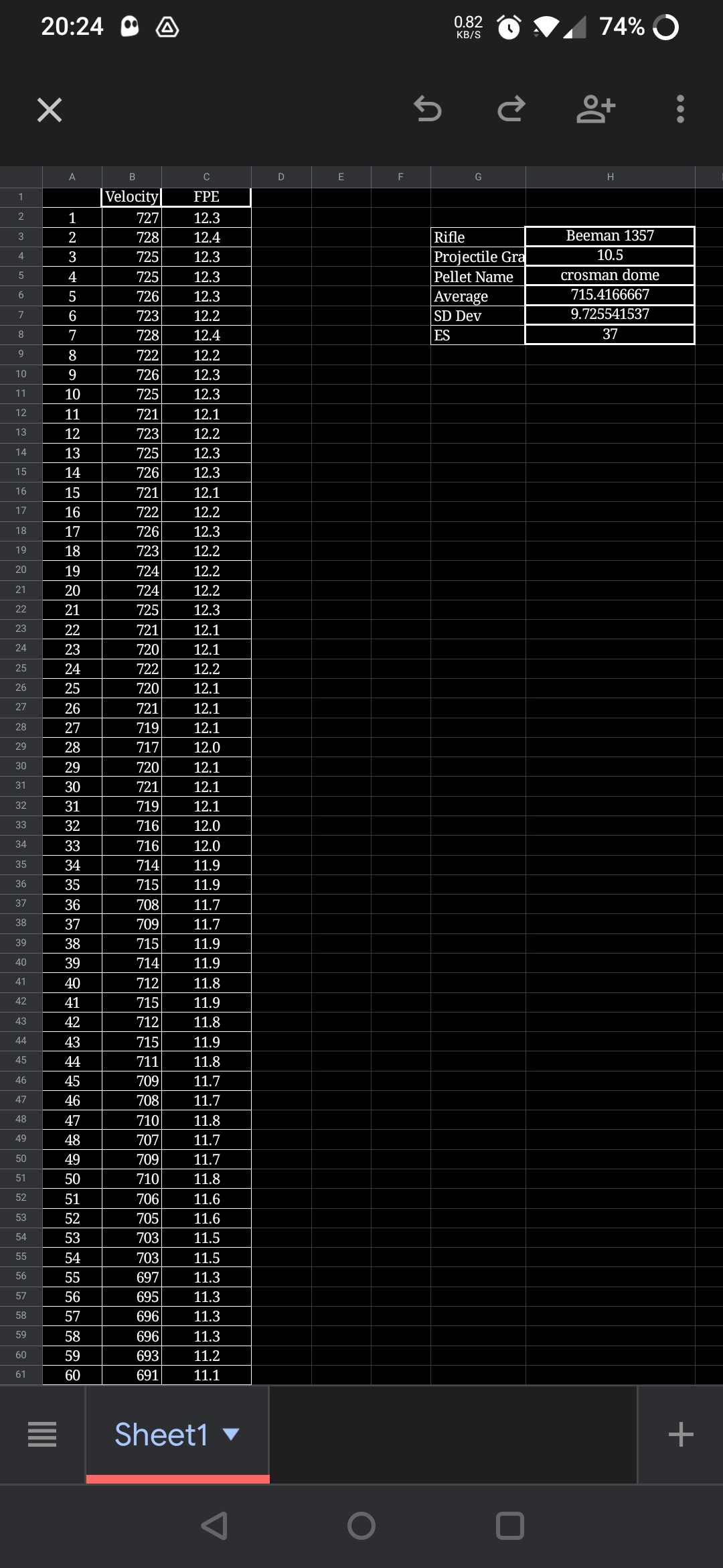

Picked this little bullpup up a few days ago on the cheap. First time putting it across the chronograph it was shooting at 1070 fps with 10.5 grain pellets and had a horrible cliff and only about 30 shots from 3000psi to 1200psi. Spent a few days playing with different hammer springs (size and strength ratings) and did a bstaley o-ring mod on it. So far it's gotten a 1000% better. Settled on the stock spring with 2 coils cut 2 turns in from flush and 2 2.4mm orings 1 behind the hammer stop that the valve pin sits in and 1 in front of it. This string was with crosman 10.5's from 3000 psi to right around 2000. I'll try 2.5 turns in tomorrow.
