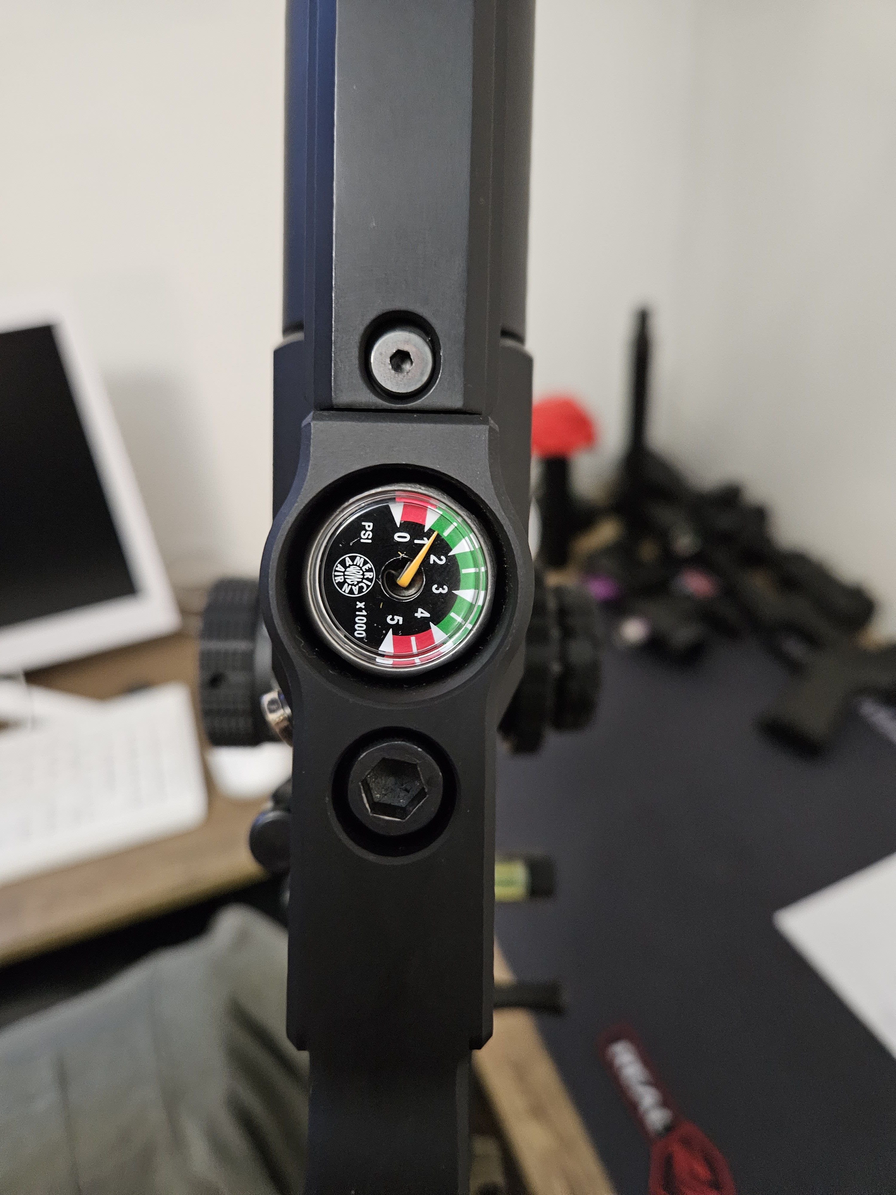

That brings me to Saturday. Saturday I degassed the rifle, tore it down, and by god are these things easy to work on and tune. It was actually a pleasurable experience, not a million and 1 little pieces to remove, special tools needed (aside from the barrel removal tool) , or headaches, purely simple.

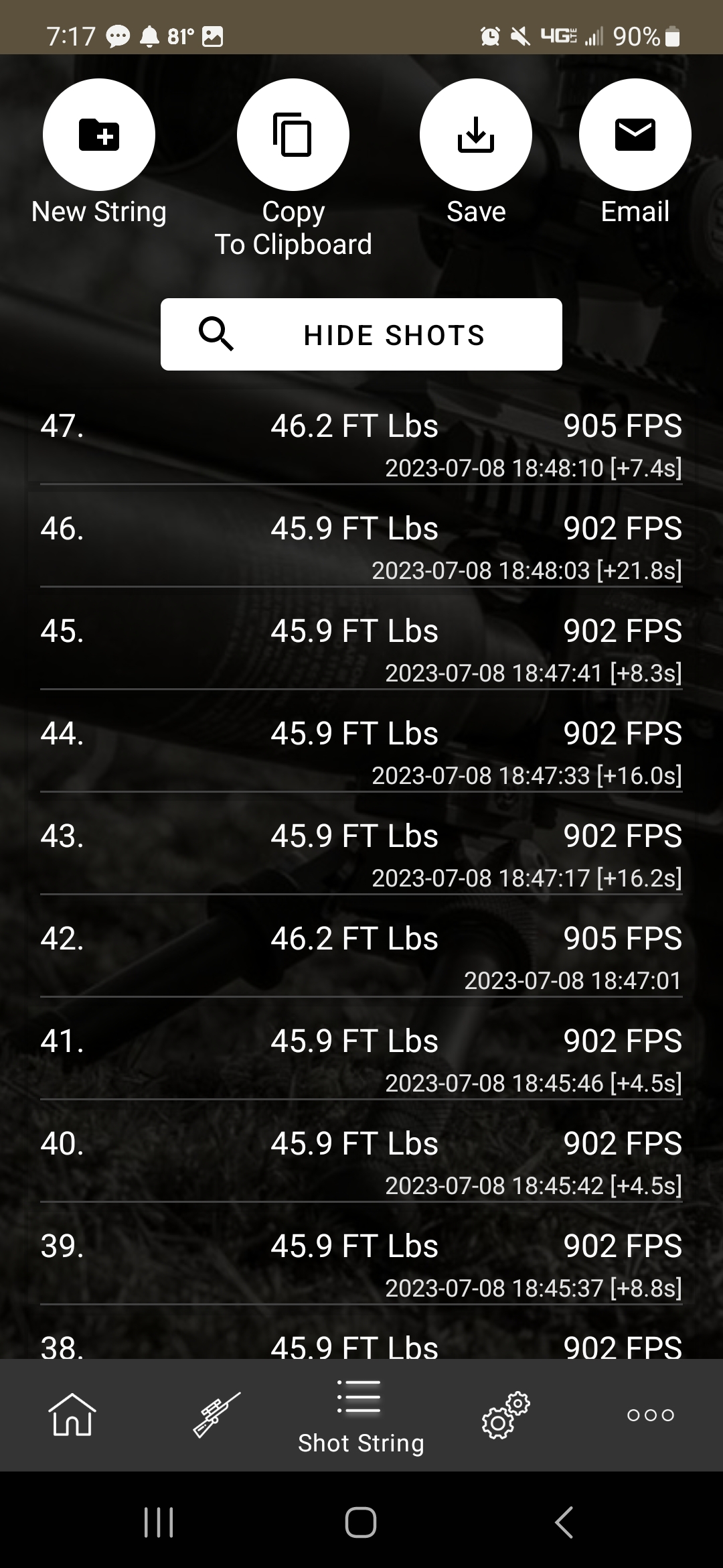

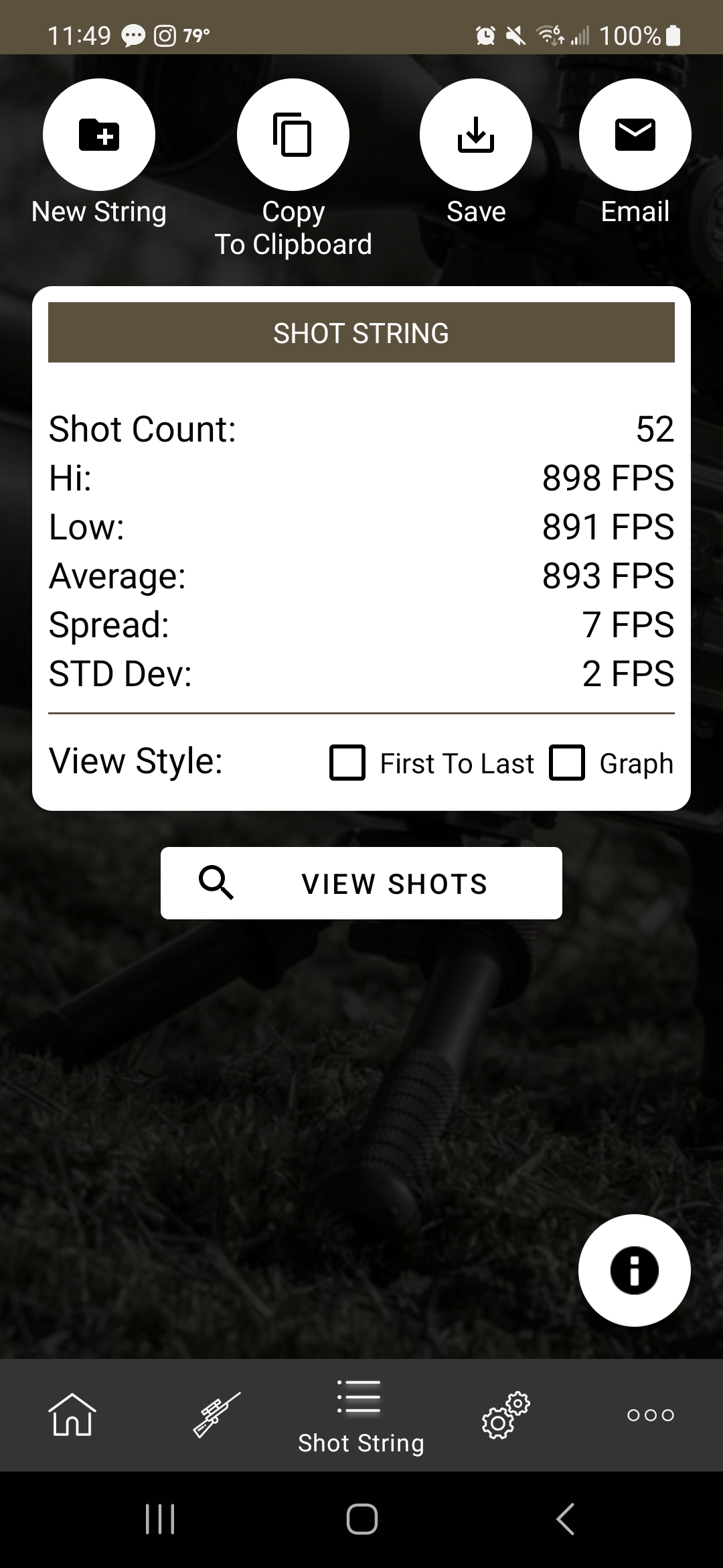

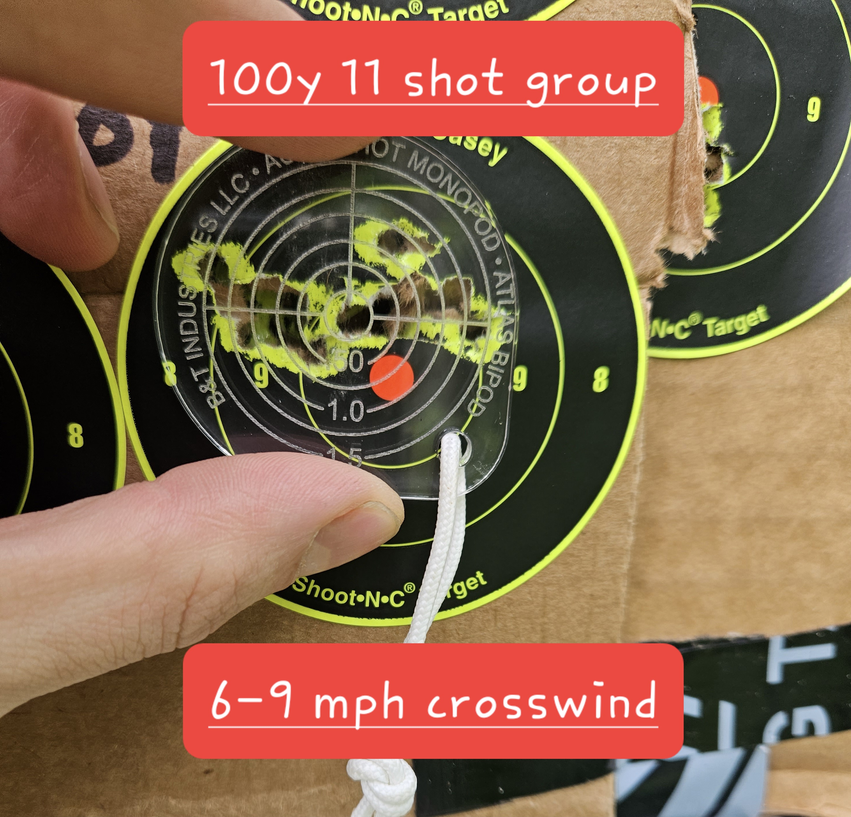

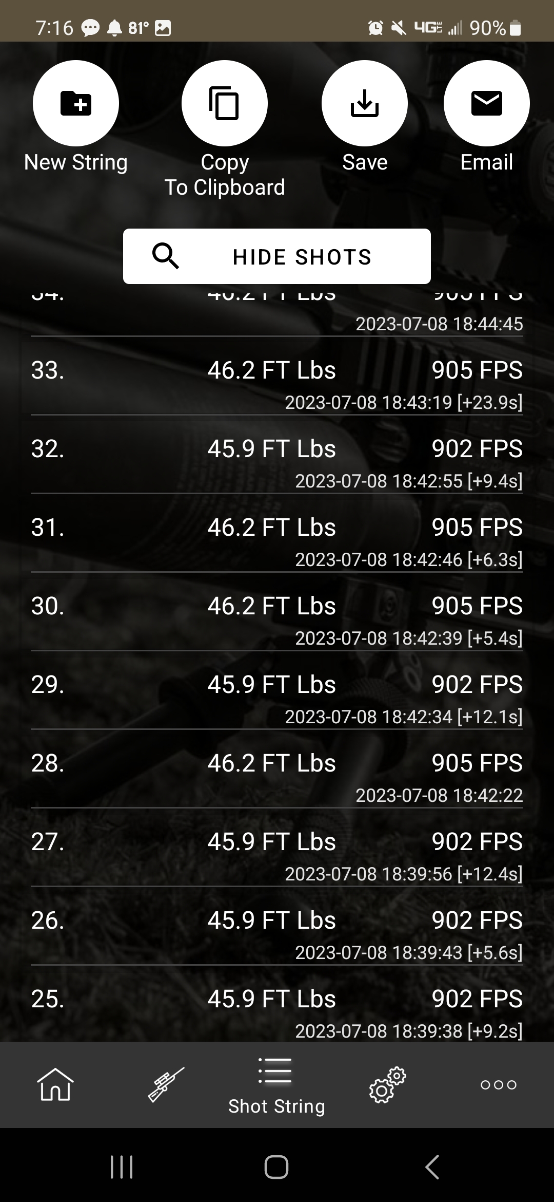

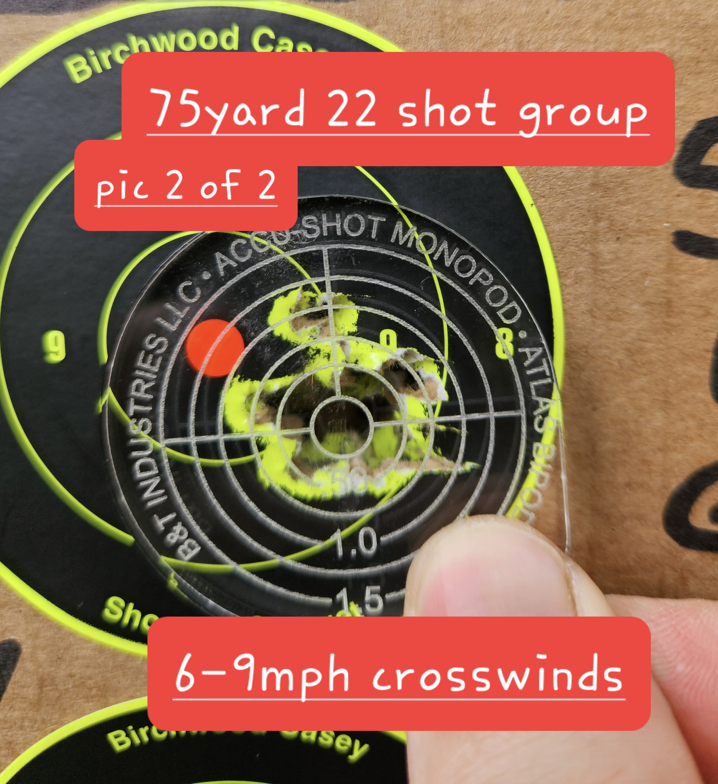

Saturday I got an absolutely incredibly consistent tune but others had questioned the air usage, only getting 55 or so shots shooting 18.13 from the rifle and as the pics show, it was damn consistent, and accuracy was there.

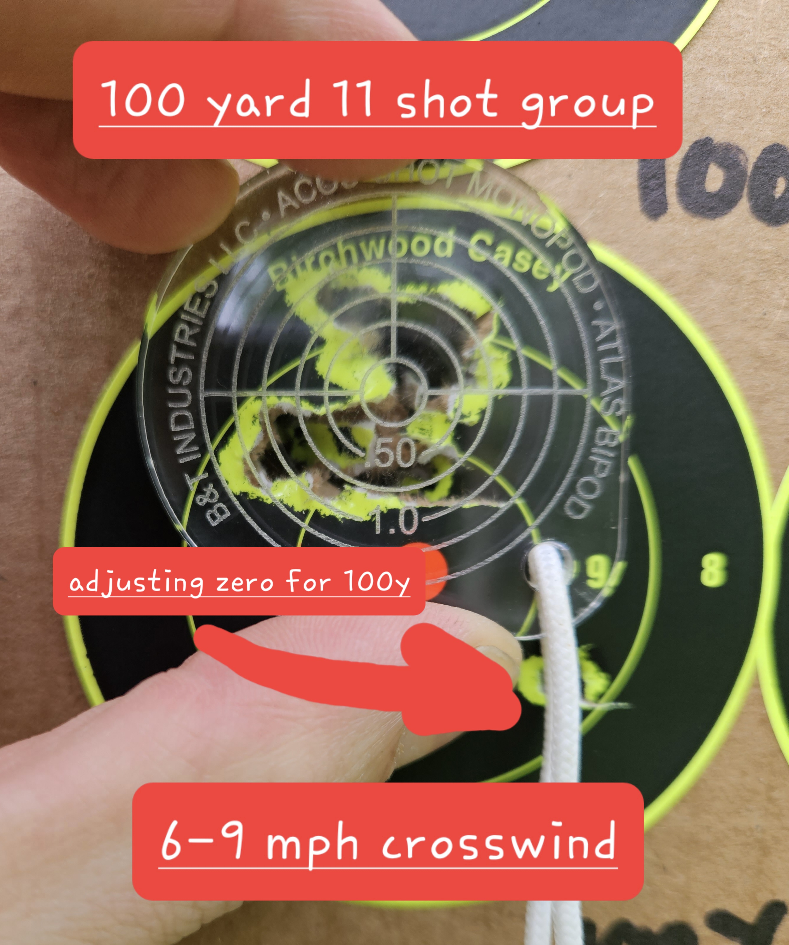

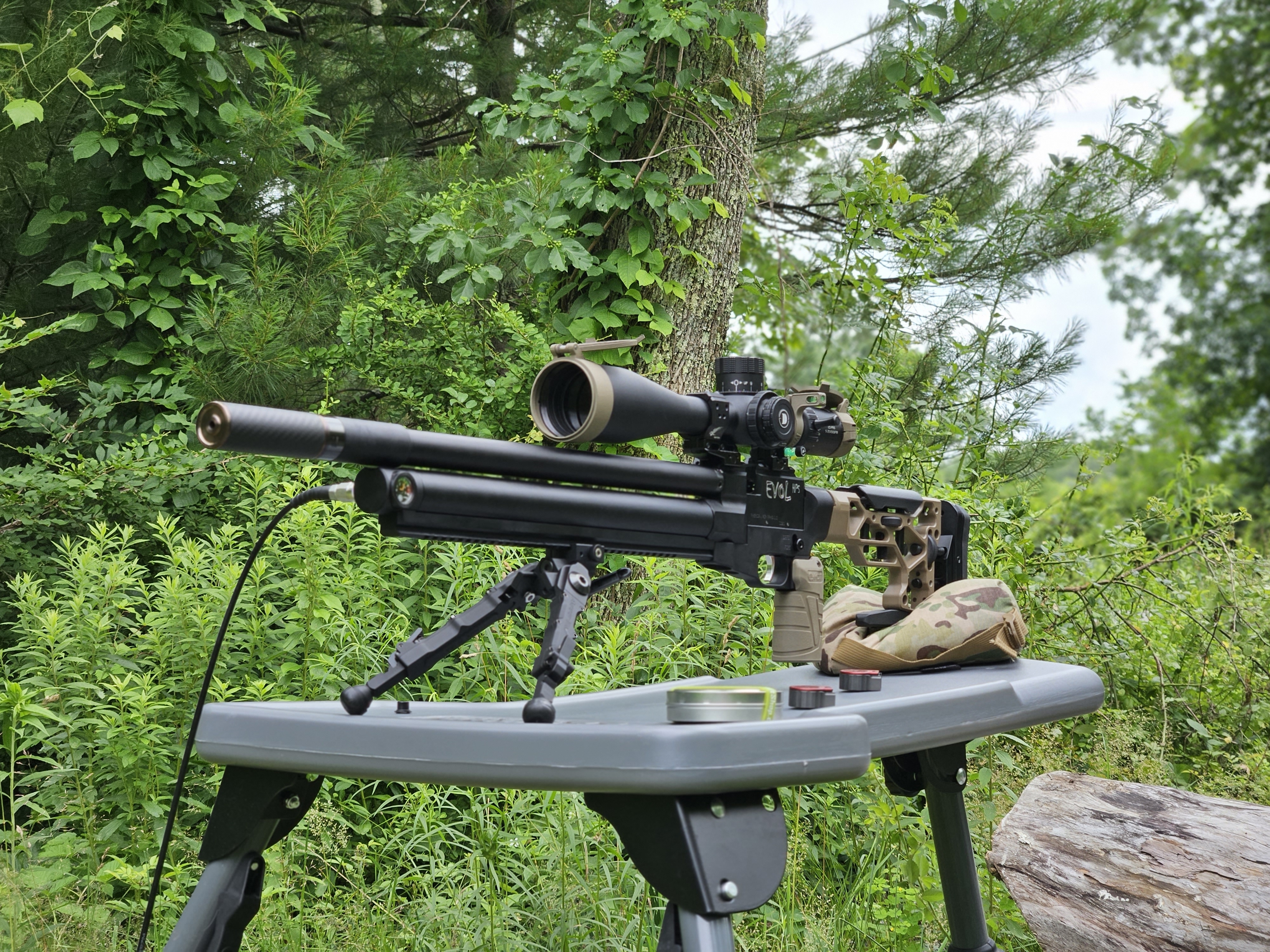

An Evol HPS Shooting 18.13 for 135 shots a fill at ~30 FPE , extremely quiet, extremely docile, and extremely accurate with such a light projectile.

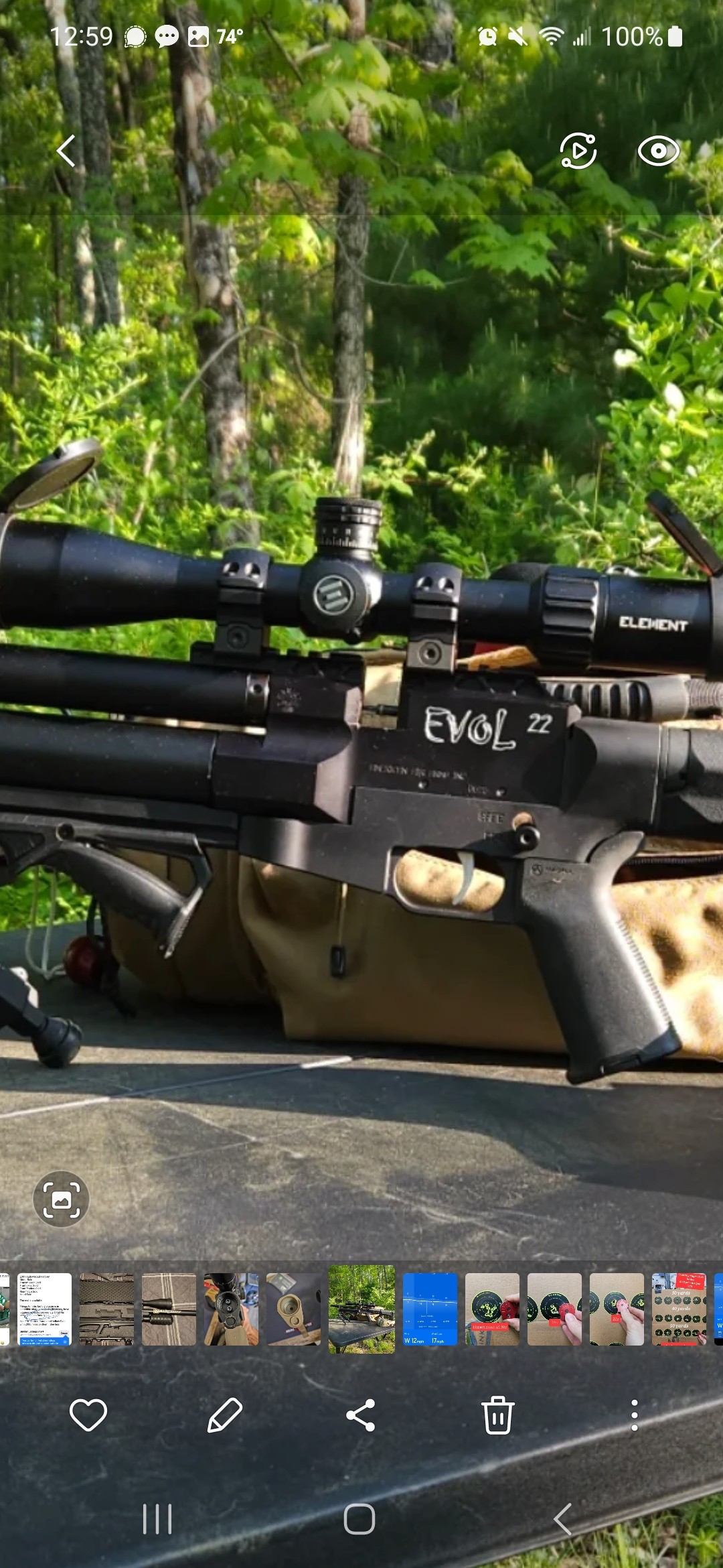

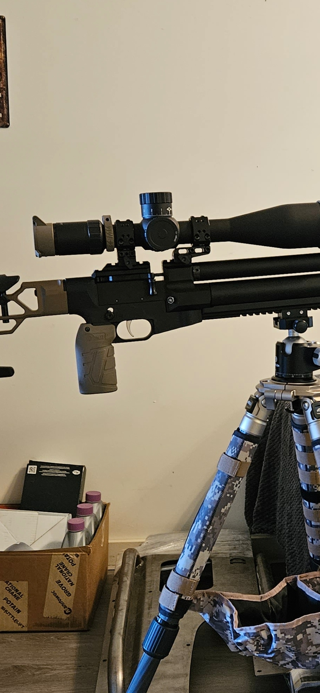

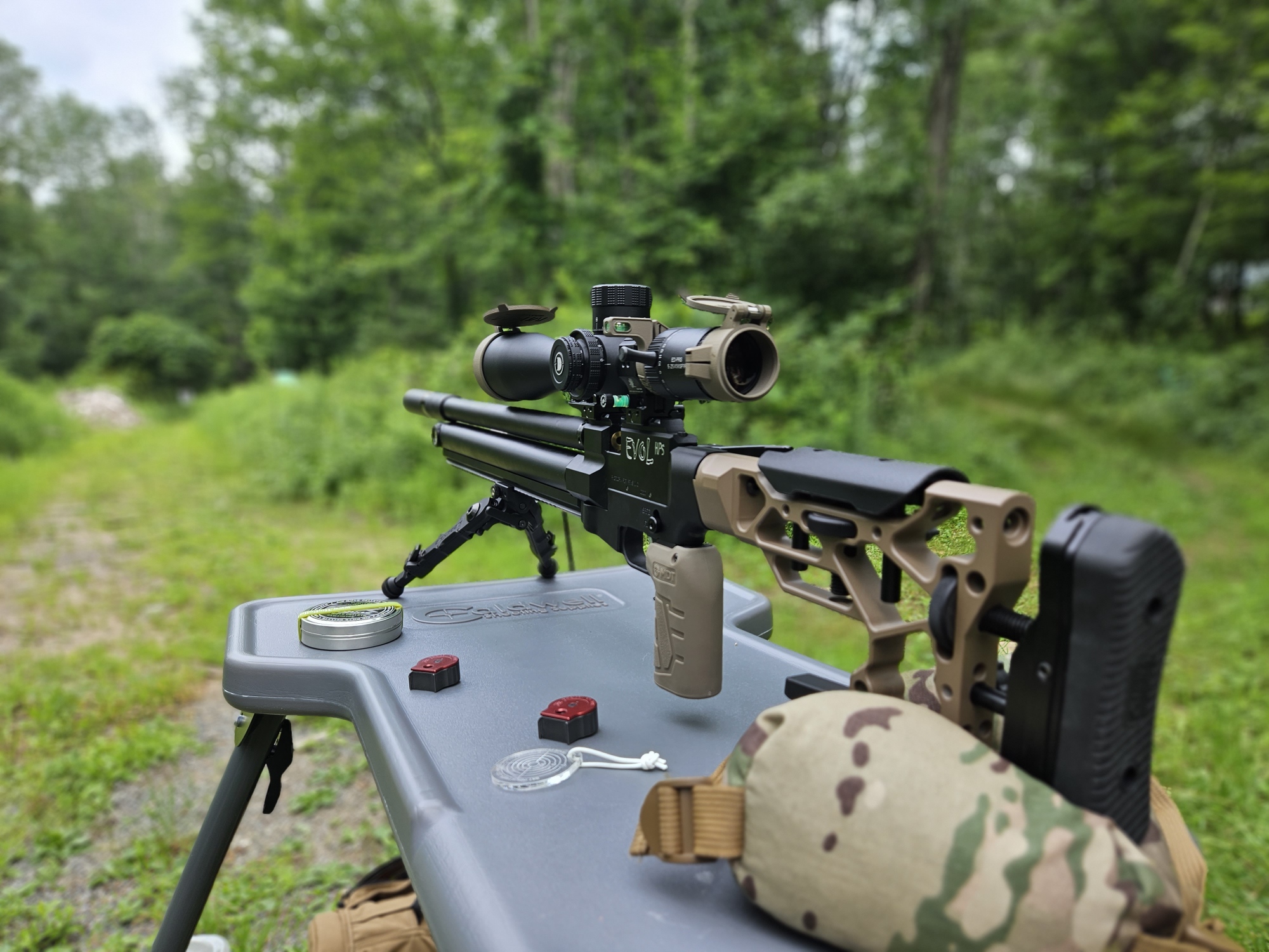

I am loving the addition of the MDTTAC stock (the LOP is perfect for me) but I am still finding it hard to get comfortable behind the high scope , I noticed this when it was on my HUBEN at NAC, as well as when it was on the HPS with its original magpul PRS stock. I am thinking about going with a smaller objective lens to bring the centerline of the scope closer to the centerline of the barrel and provide me with a more comfortable position. Something with a better eye box and eye relief for me too. I realize if I go below 50mm objective I may sacrifice some mag.

Not to rain on your parade....and maybe I'm misreading....but 18.13s @ 900 are more like 32-33fpe, not 45fpe.
Regardless, congrats on the large shot count and accuracy you're seeing from the 18.1s after your adjustments to the gun. I am am also a fan of not running a gun at the edge of what it's capable of, powerwise.
I am going to edit that! Good catch, you are absolutely right! I forgot to change the numbers in the settings on my FX Pocket Chrono, since they did an update its more cumbersome and I was too ecstatic.
View attachment 371543View attachment 371548View attachment 371547View attachment 371542View attachment 371544View attachment 371545View attachment 371546
Why don’t you add to your comb ( where your cheek rests) by putting a block under the plastic part, or even possibly a couple spacers under with longer screws? I find a slightly higher scope to help sweeten the flat spot in the trajectory compared to the distances i shoot. If you’re right above the barrel it brings the flat spot too close

Thanks a lot man! I unfortunately have to remove the MDT stock, playing with it yesterday and figuring out that while the LOP is good the real-estate on the picatinny rail on the older HPS is much more limited unlike there is on my newer mini, so I cannot get good eye relief unless I really crook my neck back and I am not about to do that , defeats the purpose of setting it up to "fit me", and I despise using ANY type of rail extender lol It stinks because the LOP is great , until I put the scope on haha
