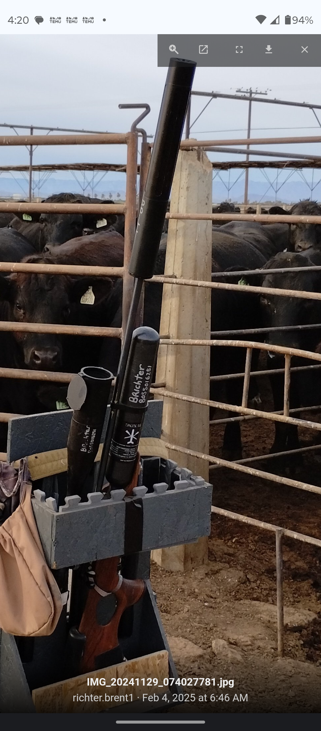

The bottle fits after sanding the inside of the stock down, I use a hold bracket too

That is a huge can! Interesting looking 1.1L. I was not expecting it to look so slim.
So you need to get the old models, the new ones are a little shorter and fatter and the barrel interferes when screwing it down. If you aren't using a regulator, this helps "push" air. I gained 10-13 fpe on the airranger extreme. I went from the 480(metal) to like the 560 carbon, the the 720 carbon to the 1.1l carbon. Each time fpe went up. Having more air in board helps shoot more shots in the 3250psi zone. I use a external regulator when I tune, best accuracy using .25 griffin 57 grain large boa, 4mm ldc, round dimpled tip. So I get like 8 shoots in the range before filling. Distance is all about consistency, and we have to make due with what we have (I tried an regulator that you screw between the bottle and plenum and I could never get it to seal). This is how we go out to the feedlots.

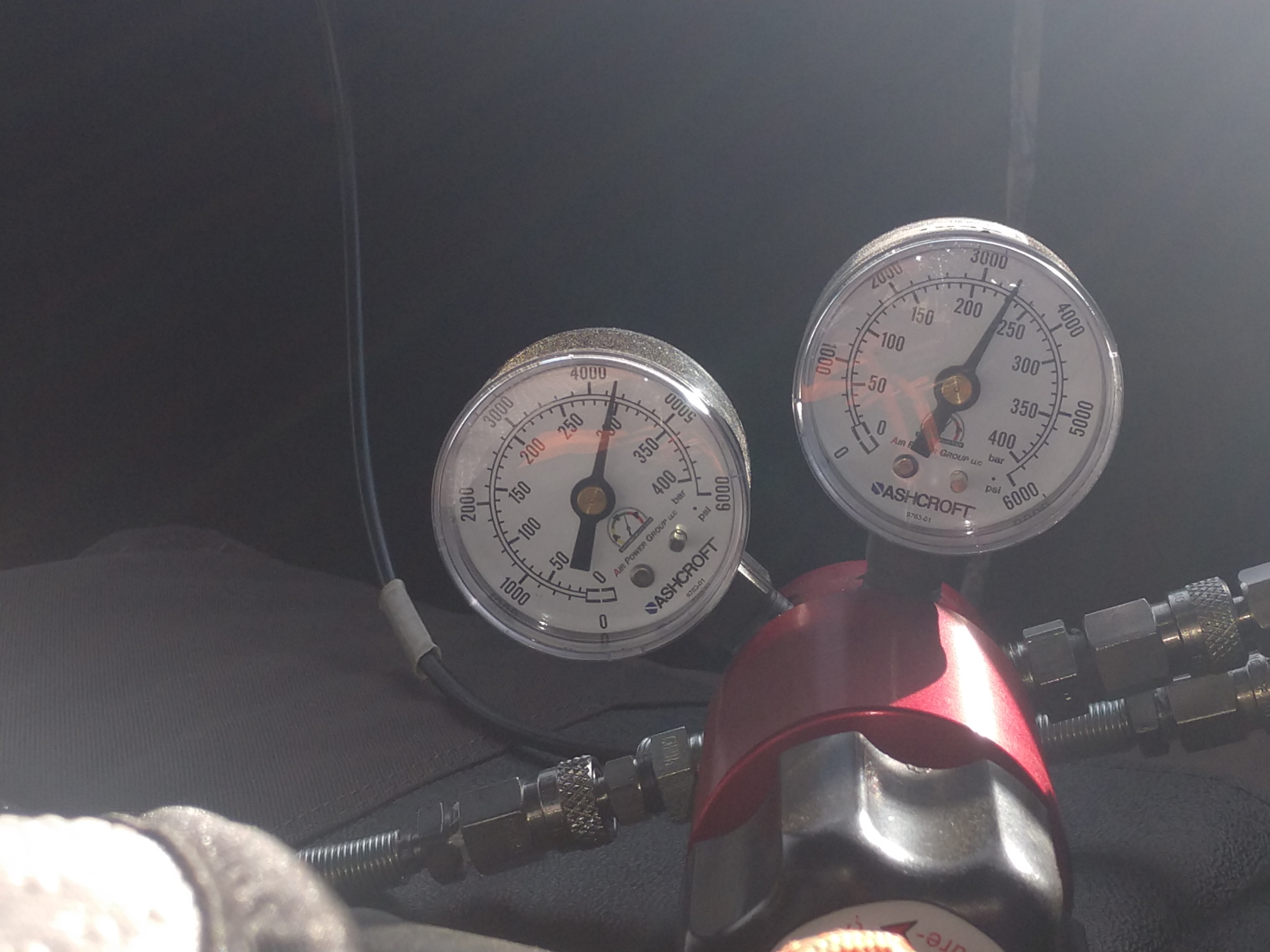

Oh, so you shoot tethered with a regulator? Interesting, I thought about having lane build a regulator for it but it would be one behind the bottle and putting a 700cc bottle.
I dial in with a regulator, it is set to 3250psi, that is the mid green on the dial. When I go out I keep the needle in the middle of the green (3250) with no regulator.
The regulator I have for the gun won't install without leaking was built custom, they didn't offer 3250 until I asked. I was going to send my gun into aoa after the turkey season and see if they can figure out why it doesn't seal.
Then I could too off at 3500, and have the upper green band to work with. It would give more shots per fill for sure.

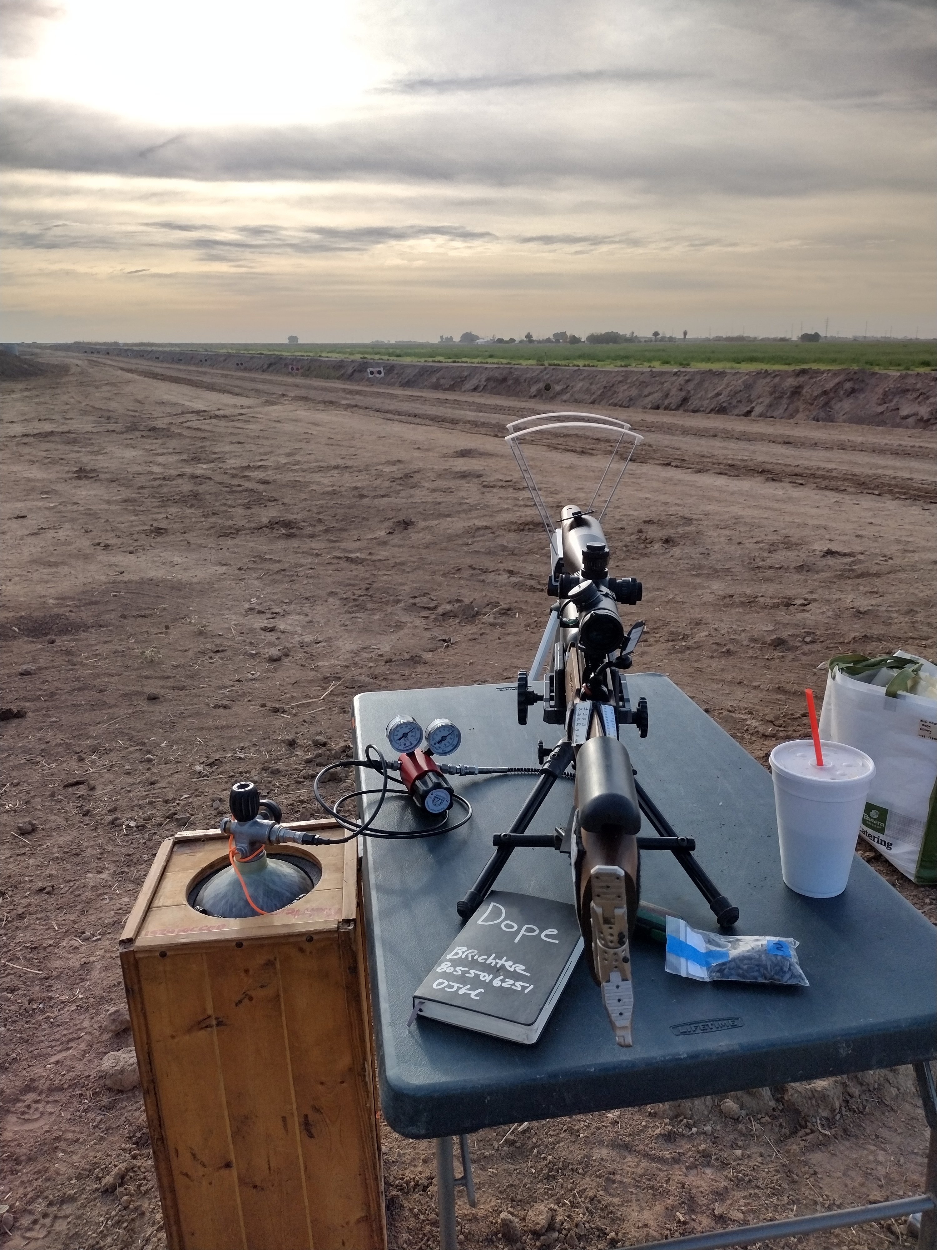

This is how the external regulator is set up
I normally set zero and yardages in El Centro at the feedlots. It is zero elevation, perfectly still in the mornings, I go out to about 270 yards

Damn, that's some good distance, anda nice reg set up. How many shots do you end up getting off a tank?
This is the regulator that leaks, set to 3250psi
They don't make them anymore that I'm aware of

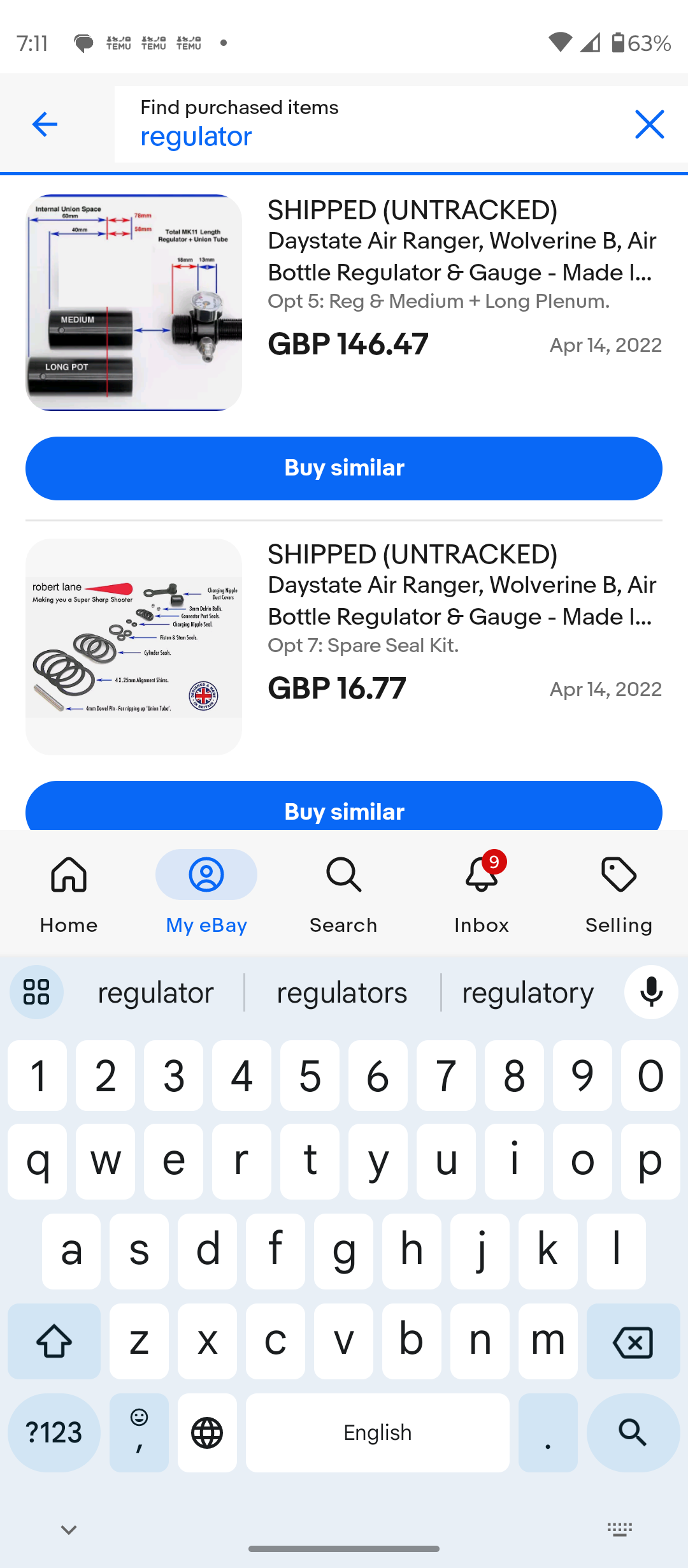

Thanks! I looked for regulators on Google and one of the first links was lane regulators and they build them to whatever specs you want. I believe it's somewhere around $130

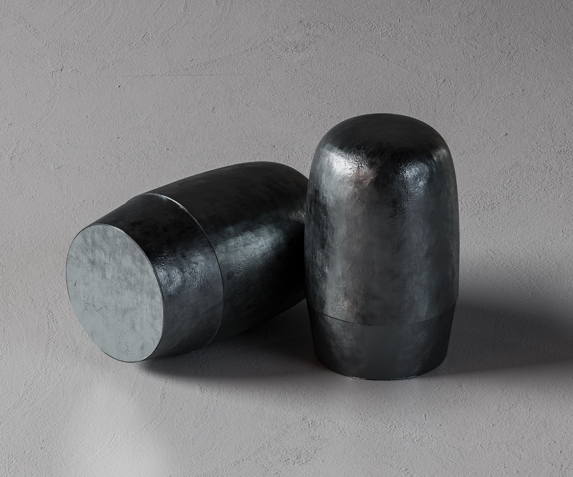

Interesting but very heavy and at the same time so long that it will not fit into many magazines... - 11.8mm - :rolleyes:
For stability in ELR a long slug is good. we're going to think more about better accuracy rather than whether it fits in a specific magazine, knowing that more and more magazines are accepting longer slugs as it becomes a bit more the norm (Rti arms Mora, Epic 1, etc...)

What Makes ZAN ELR Airgun Slugs Special?
1. Precision Engineering ZAN Projectiles ELR slugs are meticulously designed and manufactured to the highest standards of quality and precision. Each slug undergoes a multi-step quality control process to ensure that it delivers consistent performance, shot after shot. The tight tolerances, uniformity, and aerodynamic design help achieve unparalleled accuracy, even at extended ranges.
2. Aerodynamic Design The key to achieving long-range success with airguns lies in the slug’s aerodynamic profile. ZAN ELR slugs are optimized for minimal drag, reduced wind drift, and stable flight paths. The slugs feature sleek, high-BC (Ballistic Coefficient) designs, which allow them to retain velocity and energy longer, resulting in flatter trajectories and greater accuracy.
3. Superior Material Selection Crafted from premium materials, such as high-quality lead or alternative alloys. These high-quality materials ensure that your shots are more accurate and predictable.
Don't forget the Shop ZAN : https://zanprojectiles.com/shop/22-elr-slugs/
Will it even fit in the DRS? And at 42.3 grains, bumping the speed up to 939 (as advertised) will probably get you 6 or 7 shots per 230 bar fill?. Looks like you’ll need to shoot a Panthera or Dynamic in 700mm to effectively use these slugs.
