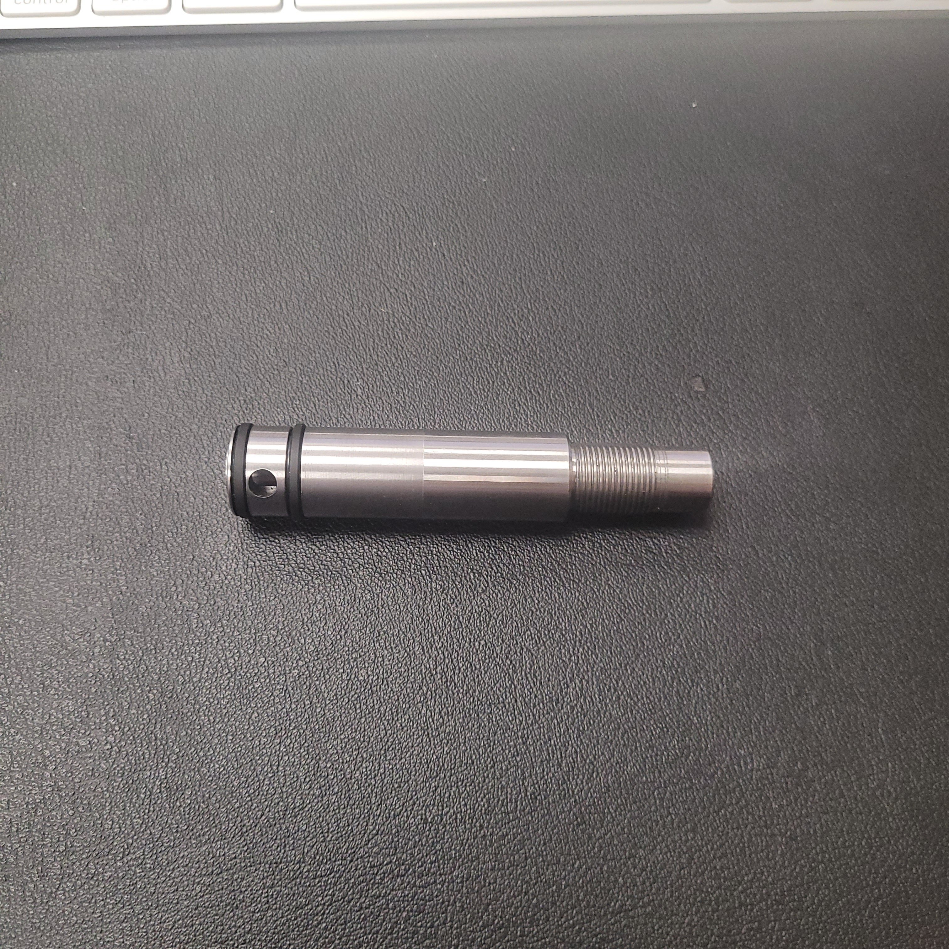

Theoben Custom barrel adapter for FX liner
Very nice !!! Similar to doing my MFR rebarrel with too small of barrel blank.

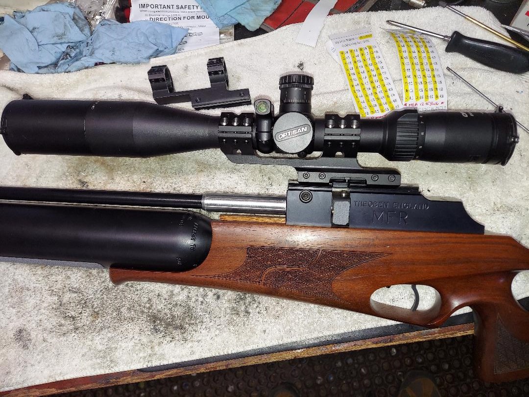

I think I just did that Stuart! I got everything in the rifle and tested and I am still getting air blow by. So thinking I damaged the rings when pushing them in.
I will grab some more and try again. lol Though I am shooting pellets through the system so that is a good thing :D My goal would be to tune the rifle untill there is little to no sound coming from the rifle. Ideally looking for around 12-15 ftlb for usage in my yard and close areas of hunting.
