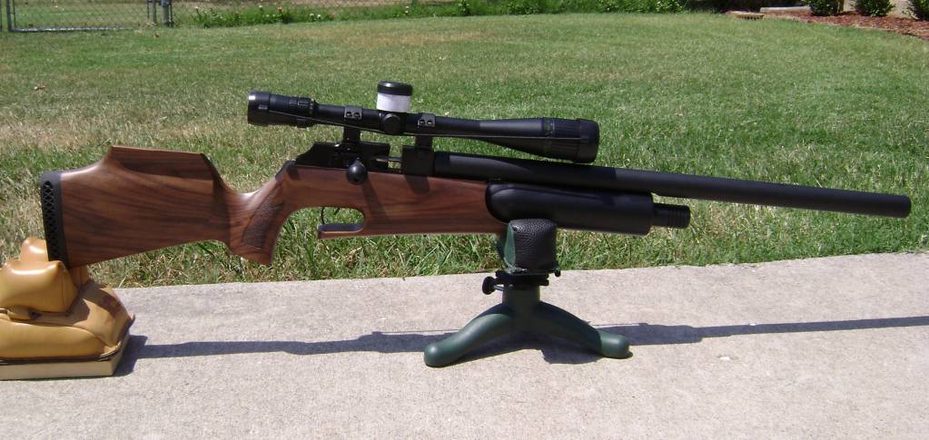

Unregulated MKII .25 cal custom built by Allen Z.
I have a couple different stocks.
Barrel cut and fully shrouded to overall length of 44.5 inches (barrel is actually about 19 inches). Original MKII has a fishing pole length barrel.
AZ custom Quickfill on bottle modification (Oversized Parker 60 fitting)
Trigger gone through and set at a 8 oz’s.
Custom cocking bolt installed and adjusted.
Dovetail cut in receiver and Allen’s custom rings with some bizarre lap type job he does on them that leaves them perfectly centered with scope zeroed with full scope travel left. I had to supply the scope. I had the Elite 6-24x40 installed with the AZ dialing for death regular rangefinder knob.
Allen ran through about 700 pellets finding the best power point and pellet for the gun. Even did some night shooting under lights so he could see the pellet stability. It flashes if not perfect flight. Shooting just under 900fps with JSB 25.4.
Allen Z is a freaking Rapid Wizard. This was cutting edge at the time but is now more of a retro classic.

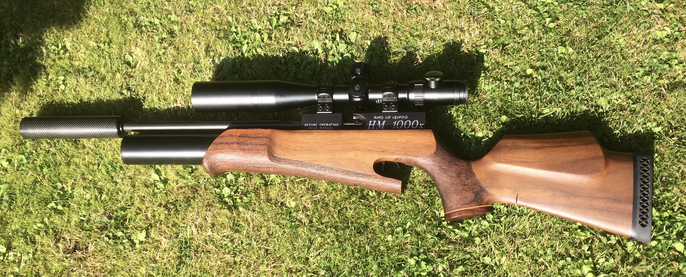

I own several rapids and RAWs while I would love to see the return I can’t really see it happening, the reason being airworx already have the 1000 and 1000x blocks which let’s face it are rapids with a cocking lever, both share many of the same parts, why would airworx bother with the extra cost of tooling and increased parts manufacture.
While I do have a chassis stock and a RAW walnut stock both of which are nice but neither are as easy to live with as an everyday hunting stock compared to the more sporter style of Theoben stocks.
What I would like to see is the lighter HM100 block a more hunting oriented stock, something like the MFR with an mfr reg that allows for easy bottle fitment. (it’s much easier to carry a spare buddy bottle than a 12ltr charging kit)
Also, it would be nice to have a block without operating instructions printed on the side, don’t need a q/f and gauge either, less is definitely more!
