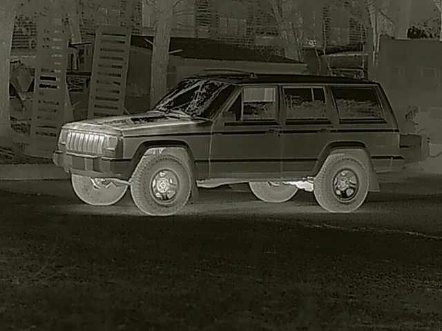

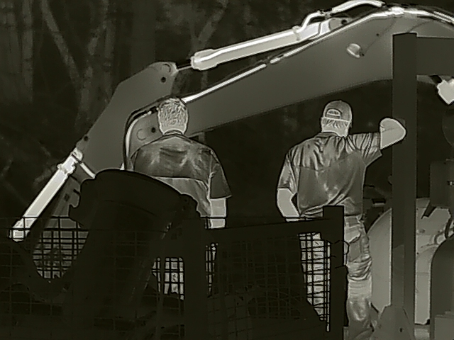

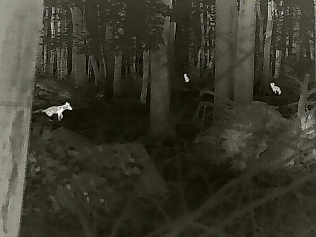

Some random pictures, keep in mind what you see in the eyepiece is better than the pics.
Middle fox is probably 80 yards out. Jeep is at 50 yards.

View attachment 317671View attachment 317672View attachment 317673
