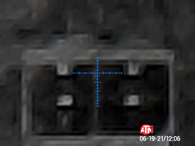

I have the ATN Thermal scope, with the one shot zero, How are you guys sighting them in?
I use aluminum HVAC tape on a target, and I tilt it up slightly towards the sky. This reflects the cold of space back towards the scope. So in a White Hot mode, you'll see black. This works even when it's cold outside, because it's not as cold at the target as it is in space.
Just tape up the entire target, and that should be able to see your shot. Probably should sight in at 25 yards, and use the Ballistics Calculator for other ranges.
Here, you can see I added 4 pieces of tape to a target at 50 yards and at my max extended magnification, it got quite pixelated, but even with that, you can see holes in the HVAC tape.
Edit: The poor quality is because I'm using extended magnification of 12.5x instead of the max regular magnification of 5x.

I have used HVAC tape and hand warmers. Only problem with the hand warmers is the image tends to bloom and look bigger than it is. Sometimes it helps to put a hole in cardboard and put the hand warmer on the back side of the cardboard. When shooting small critters, you need a more precise aiming point.
That is one of the biggest issues with thermal scopes and small critters. My scope only has 14 MOA resolution. That's massive.
