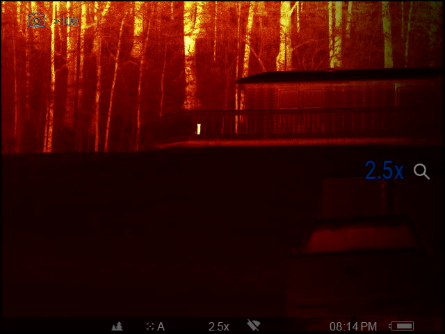

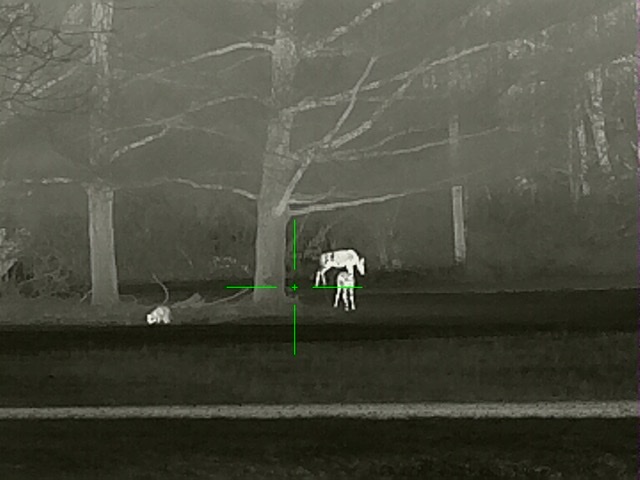

I would look into thermtec and fusion. I’ve got a local dealer that has fusion, pulsar and Bering. I believe he is bringing thermtec in too. The fusion is pretty good for the money and the thermtec has a rangefinder setup(I think it’s computer based).
Red is a pulsar helion 2
white hot is Bering optics superhogster
Are these thermal scopes or thermal monoculars?
The red is my pulsar helion2 xp50, it’s a spotter. The white hot is my Bering optics superhogster scope. Both photos are close to 100 yards. The pulsar is about double the resolution looking through the eye piece then the photos, it is also a 640 unit. The Bering optics photo is really close photo wise to the eyepiece. High humidity is the main thing that hurts thermal image, both of mine do good up to the mid 90%.
