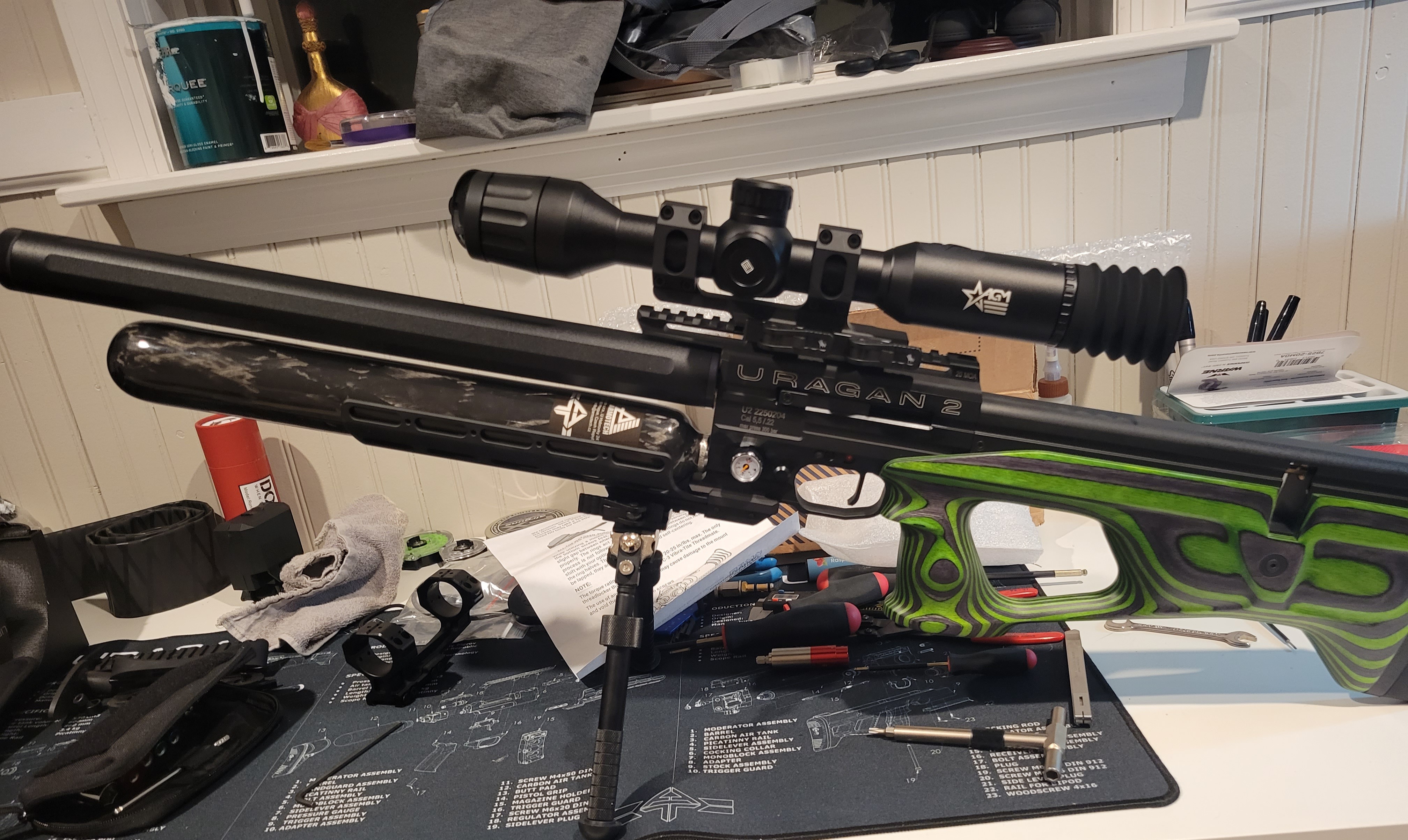

I had an agm for a little bit, it was a spotter and had 2 major things I hated. Image was good, but when swapping image pallets white hot, rainbow, and red hot were dimmest on 1 while black hot was brightest on 1. Plus the internal screen really bothered my head. I’m running an older helion2 now and don’t have this issue.

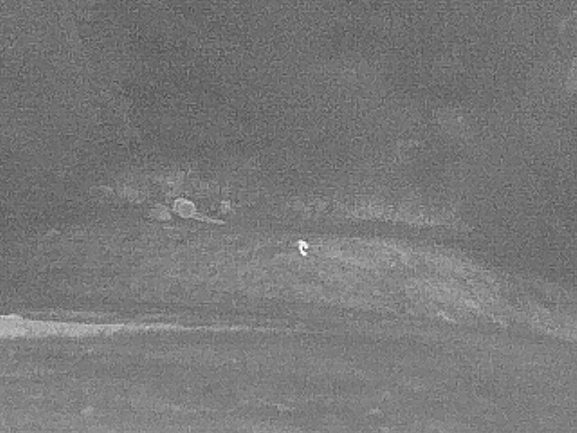

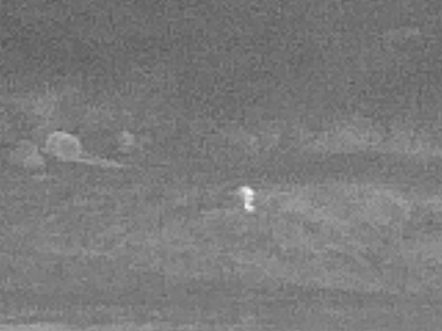

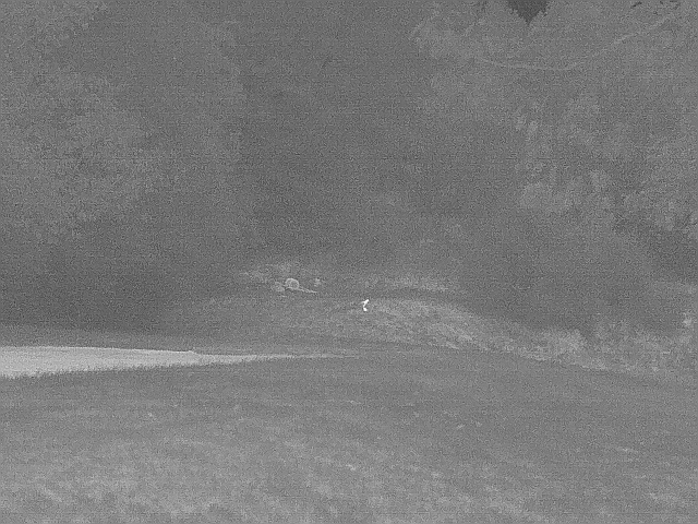

I have one thermal, I Trijicon IR Hunter MkIII 35mm, 12 micron 640 sensor. It has a base magnification of 2.5 and I honestly wouldn't want to use it much past 150 yards, 200 at the most at which point I'd be at 3x digital mag which to me sucks. While I can digitally magnify it 4X, that is so bad it is a wasted option, 3X sucks pretty much for me, some say it is "ok". At 2x digital it gives 5x magnificaton and is perfectly useable, but nothing like the view through the 2.5 base magnification.
If you want to use thermal anywhere near 150 yards or more with a somewhat reasonable view in the eyepiece, you need something with a base magnification of at least 3.5 x, then you can digitally zoom 2x and be ok. By the time you get to 3x digital mag things are degrading a lot, and if you are looking at something 200 yards away it really sooooks. If I think about it, I'll set out a gallon of warm water in a few hours and take some pictures with my Trijicon at roughly 120 yards at base mag and digitally at 2x,3x, and 4x and post them.
Just got out my cable for the Trijicon, realized I hadn't put the trijicon download software on this computer yet, so I just loaded it and found I had a few pictures of a red tail hawk eating a rabbit she just killed just about 125 yards from my deck. Pictures show 2 things about thermal, how bad the picture can get if there is a ton of water in the air, and how bad digital magnification gets. These pictures were taken after hours of rain, very light mist in the air that was just enough that with the naked eye the trees behind the hawke were not clear, just a bit hazy.
In my previous post I mistyped, digital mag is 2,4, and 8x. I stupidly wrote 1,2,3. Effective magnification starts at base of 2.5, then 5x, 10x, and a completely useless 20x I have never taken a pic at, it is beyond bad and shouldn't even be an option.
Base mag(2.5 base mag):
2x digital(5x magnification)
4x digital(10x magnification)
The further away something is when you are all the way up to 4x digital magnification, the worse it looks. These pictures, besides the water in the air also reflect my contrast and brightness settings. I can make pictures look better, but I like the white hot to make critters jump out so that is the way my Trijicon stays set.
This is with a high end 640 sensor, if you had a 320-384 sensor you could do 2x digital mag, but 4x would be mostly worthless in most cases. Base mag is where it is at for a thermal scope if you want to use it at any distance. 2x digital works pretty well, more than that get's into the pure suck range. Clip on thermals with less than a 640 sensor that are not military optics are 100 yard tops at 4x opitcal mag with your daytime scope. Berring optics makes a fairly reasonable 640 clip on, but if you ever look through a military one you would likely never put up with it. Stick with a thermal scope with a good base mag, or spend real money on a clip-on. I've briefly used a voodoo-s and a voodoo-m. I would never pay the money for the -s (>15k) but if I had the money I'd jump on the voodoo-m in a heartbeat for a clip-on. No problems getting to 15x mag on day scope with it and if that hawk was about 400 yards the voodoo-m would look much better at 15x than the 2x digital(5x) pic of that hawk at 125ish yards looks, costs around 22k or so.

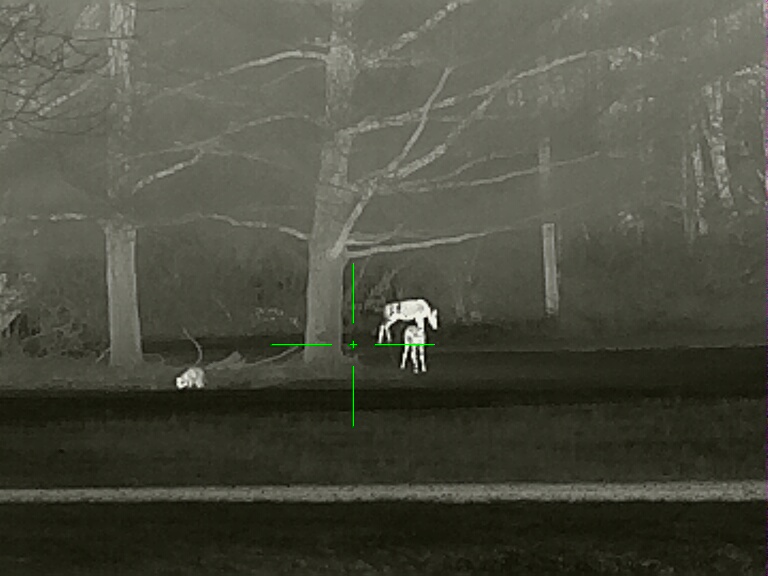

Something to note for hunting with thermal. Thermal optics may have you shooting into thin brush or grass that is not visible by your unit. Here’s is where night vision holds an advantage to thermal optics. I’ve had several animals show up on thermal, then when I go to line up a shot there are all sorts of plants in the way that I didn’t see through the thermal optic. Not sure if this was a humidity issue or what, but it happened more than once. Dunno about the high-end stuff, but you may encounter this with entry level thermal optics under certain conditions.
I think the high-end also has this feature, or perhaps problem, depending on how you look at it.
If the heat signature isn't diminished much, there's likely only thin leaves and twigs between you and your target. If the target takes up significant MOA in your scope and the obstruction is close to the target, you'll often still make an effective kill. Of course, it depends on being familiar with the obstructions to have any confidence in this -- knowing there's nothing very solid in the way.
