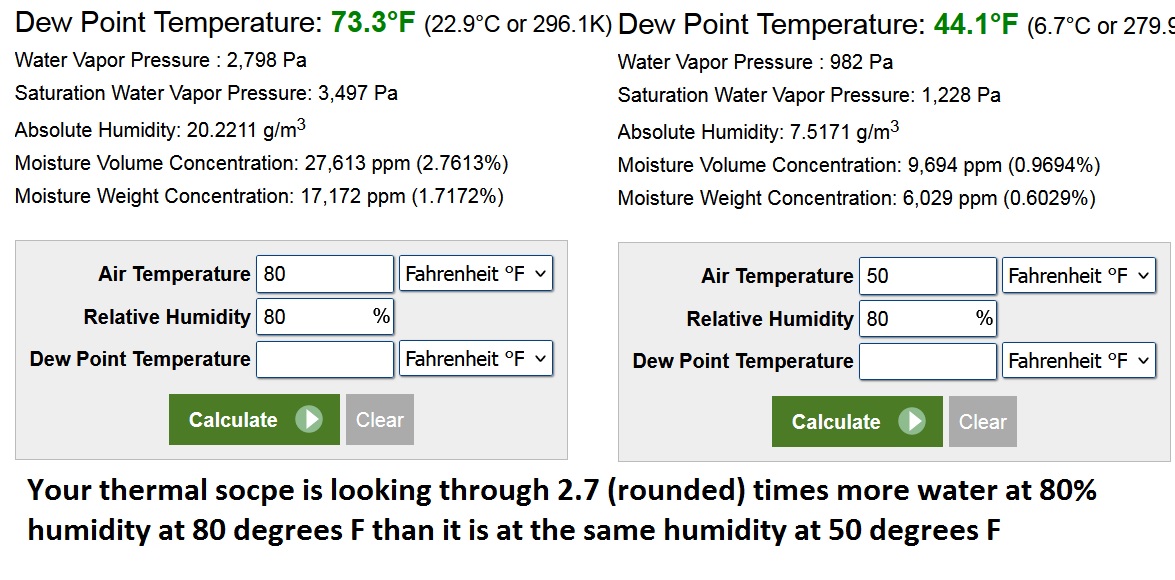

Humidity is a pointless measure when talking about thermal scopes, without the temperature included that is. Dew point tells you what is what with thermal scopes and degradation of image. You can calculate exactly how much water is in a volume of air with dew point, or just use the web. With a decent thermal, any dewpoint around 50F and less won't degrade your image that much unless you are looking really long range(>200 yards). I just ran a quick example with humidity at 80% for both 80 degrees F temp and 50 degrees F temp. There is just about 2.7 times the water your scope is looking through at 80F vs 50F when the humidity is identical.... Humidity without temp is meaningless.
Absolute humidity is defined as the mass of water in a given volume, there is no percentage, just mass contained in a specific volume of air.
@karl_h I don’t know about all of those details, but I’ll look into it. Thanks for sharing. I know what I’ve experienced with thermal and night vision regarding humidity (separate issues). For my needs I believe that I can trust what ETX Hans and Jason on the Late Night Vision Show discuss, record, and post. We’re in the same region.
