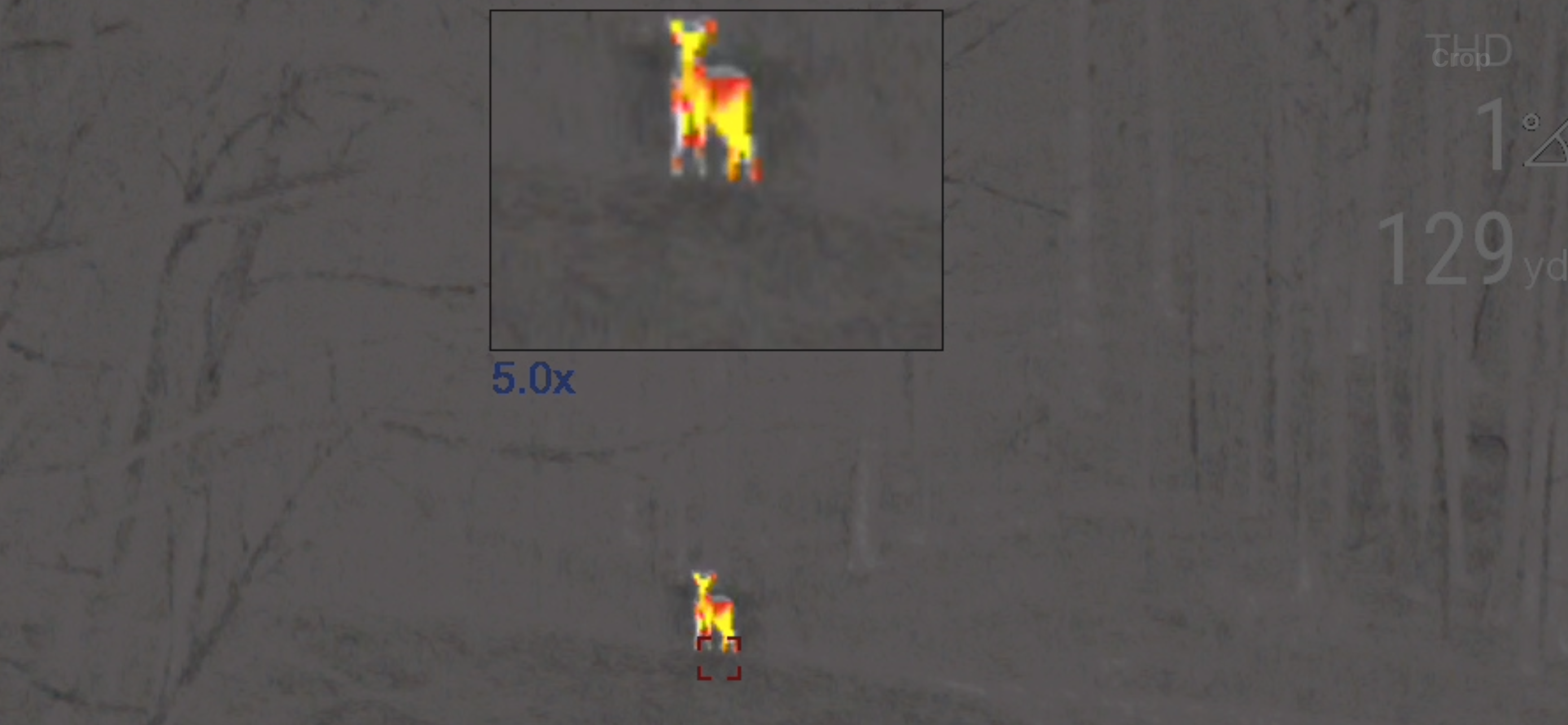

I’m also running a pulsar telos lrf and my biggest complaint with it is the range finder is slow. I have to remind myself that I’m not using my sig which ranges almost instantly. This is a deer at 129 yards in high humidity the eyepiece looks better on both of my units than the pics. I’m very impressed with how fast the telos fires up and the image isn’t as jittery when panning like some of the others I have owned.
