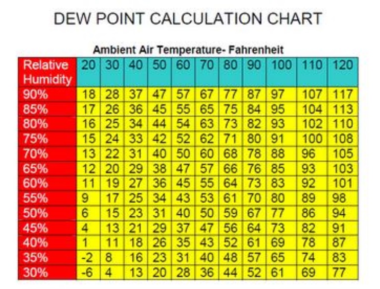

And like everyone else, the presenter kept harping on humidity, totally usesless number when talking about thermal capability of any device. Water is the enemy, and humidity does not tell you how much water is between the thermal device and target. Dewpoint tells you how much water by mass is in a given volume of air. Some of the best thermal images I have with my Trijicon are in near 100% humidity (gasp). The dewpoint was in the teens F, needless to say so was the temperature. That same exact air with every single molecule of water still in it warmed to nearly 80 degrees F would be less than 10% humidity. Humidity is bs when talking about thermal devices. Mass of water in a given volume of air is what causes problems, have a dewpoint of 65 and it wouldn't matter if the temp was 66 or 100, the thermal image would be just as bad at both temps with a dewpoint of 65 since there would be the same mass of water in the same volume of air, and at 65 dewpoint that is a lot of water. If everything in two thermals was identical except the cores, the one with the smallest NETD could look better if the difference was significant for the conditions. But everything is not always equal, different lenses, different chipsets, different software and a core with a much worse NETD could look better by far than one with a super low NETD. it's all relative.

I often use humidity because my weather station does not show dew point. I cannot go by my weather app due to the fact that I live in a valley which is often 5 degrees different then the app plus my ponds tend to fog out some of the areas I hunt, they are elevated above my home. I guess I need a new weather station, I’m located in southern Illinois, heck I can’t even trust wind direction of the apps at my place. The one huge thing I’ve noticed is the lower net mk is good for seeing smaller temp variations. I use my telos almost every night, I had a helion2 xp50, and a couple agm. I’ve owned a superhogster and now an iray bolt 50 and played with a lot of other scopes/handhelds. The newer faster processors in some have helped a lot in smoothing out the view when moving.
You don't need a new weather station, just a simple chart. It's been my experience that anytime the dewpoint is under 50, degradation of image is negligable, by time you get under 40 it is almost nonexistent unless looking at something a long ways away(several hundred yards). Fog is another thing entirely, that is water droplets hanging in the air. I've found if I can see something with my naked eyes in a fog clear enough to make out details and not just a fuzzy blob outline,, I can see it in the thermal well enough to shoot small groups. I have a low area on my property I hunt a lot, less than a two minute walk out my back door. That area holds water, and probably 4 months of the year or a little less has standing water. When there is no standing water, the soil is virtually saturated anyway. I learned trying to shoot coyotes at night there, if afternoon temps were over 40 degrees F, no solid north wind, and the temp drops fast enough after sunset the whole bottom becomes a thick fog you can't see through, so I don't waste my time on nights like that.
here is a quick chart for dewpoint vs relative humidity.
Im saving this, unfortunately I’m rarely under 95% humidity. It was 98%last night at 45 degrees, I’m hoping for some snow and 20 degree weather to hunt.The area I usually hunt has 2 ponds, a creek and swampy area, so far the telos has been impressive and really does good to spot critters. The bolt 50 tends to have a little more detail but I think it’s mainly due to the higher base mag.
