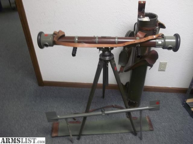

For long distance ranging I had a 300 to 30,000 meter Wild optical rangefinder made by Deutsche Optik and some Russian made Newcon rangefinder binoculars that ranged to 2500 yards IIRC which was the longest ranging electronic device under $2000 at the time - in my early years of 1000 to 2500+ yard shooting back in the 80s, I remember reading in an owner's manual for some high dollar scope where it explained why the parallax focus mechanism markings traveled beyond the "Infinity" symbol, because there is no exact yardage associated with the dial position for a zero parallax point - always shifting due to temperature changes. They explained that as the temperature shifts, so does the parallax free set point - thus the extra movement past infinity. I can see how that might mess things up when ranging for Field Target based on calibrated markings.
My Wild looks just like this one. Quite accurate for a 60 year old mechanical / optical device. It weighs more than quite a few of my long range rifles and is not fun to carry. If it was deployed at some shooting ranges, I am sure the rangemaster would be running over to stop us from shooting that RPG or Bazooka!
The bar with the squares on either end at the bottom of the photo were used for calibration, which I assume likely reduced errors caused by the current temperature, though I didn't calibrate it in the field very often. In use it is perpendicular to the line of sight and you look down into the eyepiece to take a reading.
This video on YouTube, is on a 1942 WW2 vintage Barr and Stroud brand, but the function is similar to the Wild. Another video on Youtube that talks about the mechanics a bit used in this type of rangefinder. The Wild uses a split image type of display like what is found in older cameras.

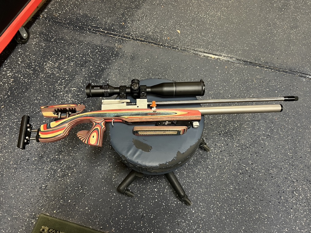

Today, it's Fathers Day, and I reset my entire FT ranging and target course from 10-55 yards; all clearly marked in a variety of optical bliss (ha).
i am going to leave my Tsar FT with my Sightron SIII 10-50x60 outside in the 90 humid air for a couple hours but under cover. After this i will begin parallax focusing / ranging and marking my range wheel anew. I will mark the scope wheel left in 90 Degree temp's with a fine tip red perm ink - RED to indicate HOT, at first my biggest focus will be in 5 yard increments.
I will then return the Daystate Tsar to the A/C of my indoor 75 degree mancave, and after 2 hours of cooling down I will repeat my ranging from inside the comfort of my shooters box window set up with emphasis on 5 yard distances, but this time i will mark the wheel with a green fine tip perm marker.
I can then turn the A/C down to 60 BRRRRRRR and after 2 hours of acclimatizing i will repeat the process but this time i will use a fine tip blue marker (indicating cold) with emphasis on 5 yard intervals. Actually there is no rush on cold weather markings as December - February are a long way off.
This should prove enlightening.
Note the Athlon scope in the picture predates my New Sightron. If this exercise proves useful i will repeat with my other primary FT rigs.
Of course i could set one complete rig up for 50 degree weather, another for 60 degree weather, another for 70 degree weather, another for 80 degree weather and so on.... glad i don't live where its always cold or gets into the 100 plus temp often.
Can we obsess ? Yes!
Afterall it's Fathers Day.
Perhaps the Frankenraw will need the same love:

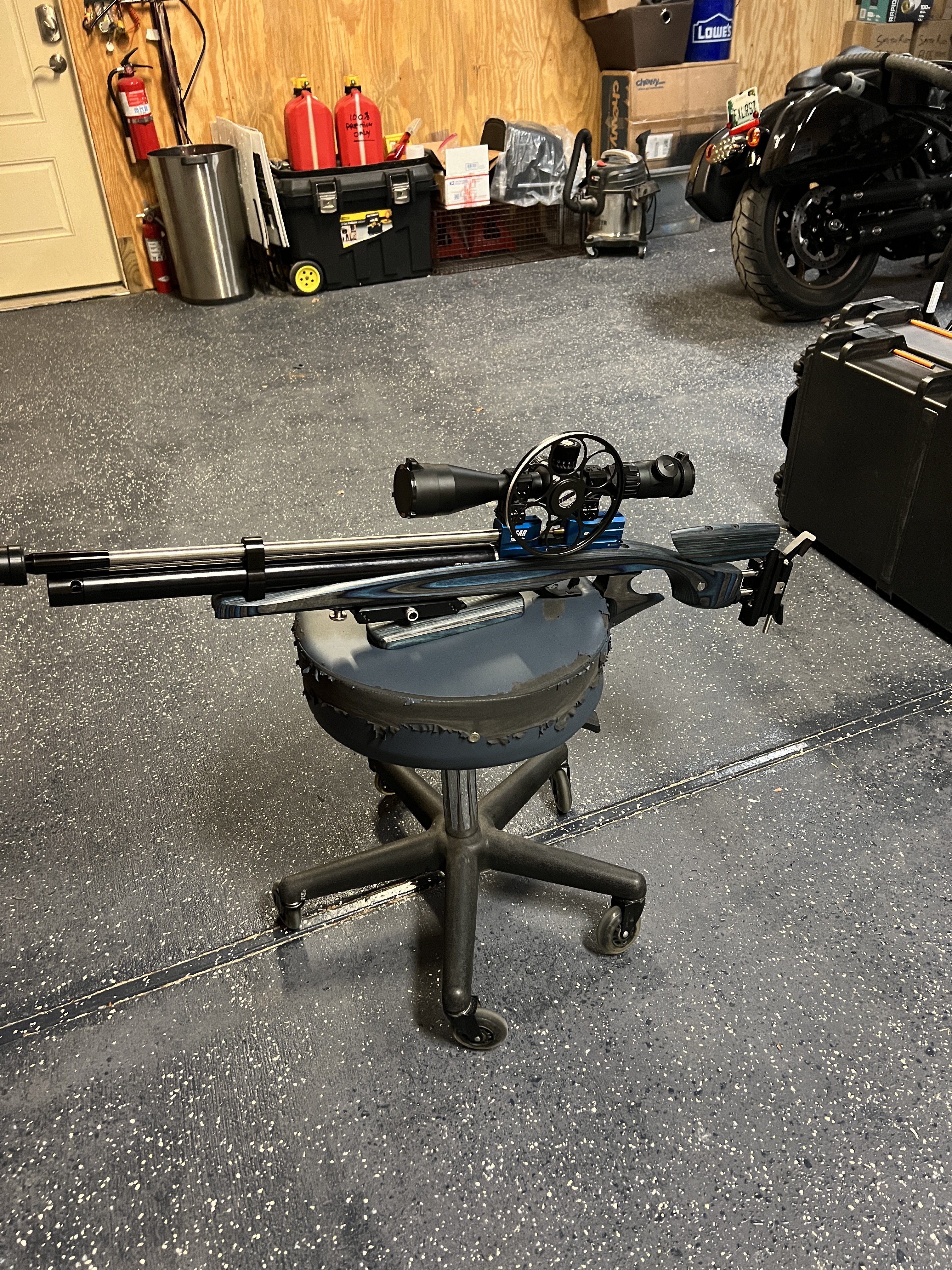

Solution-! Buy JD Garland’s parallax wheel x4 but just one hub. Mark/calibrate the 4 different wheels for 4 different temperature ranges. This is an example:
50-65 degrees
65 to 75 degrees
75 to 85 degrees
85 to 95 degrees
Once the hub is installed you can pop your wheels on and off according to temperature range on day of competition because the hub always puts the wheel back in the exact same spot. Now knowing the actual temperatures where the shift occurs is another rabbit 🕳️.
