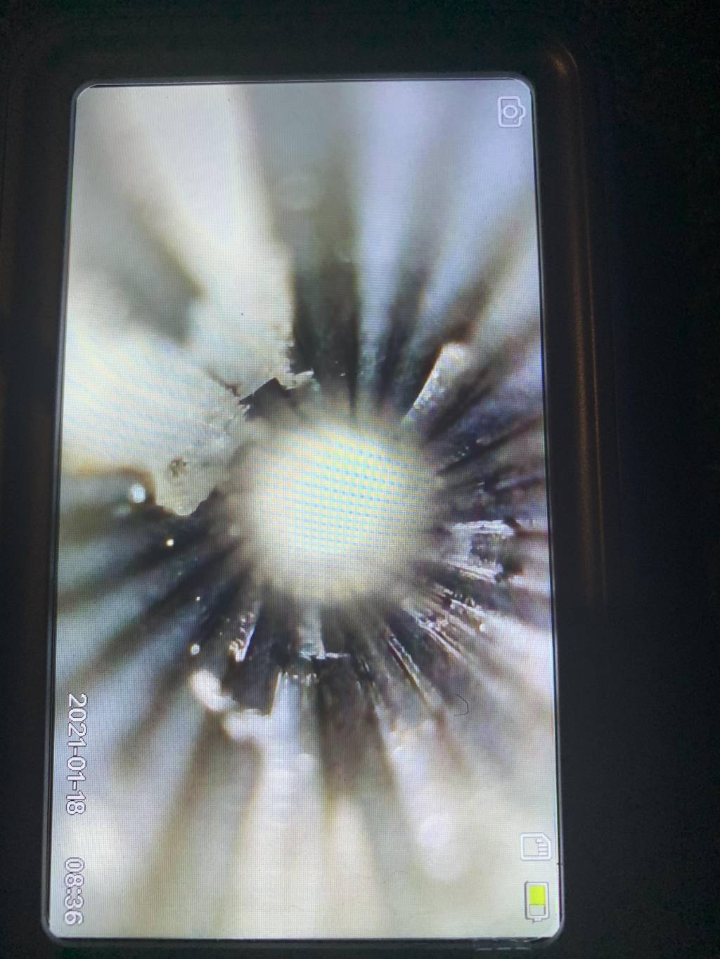

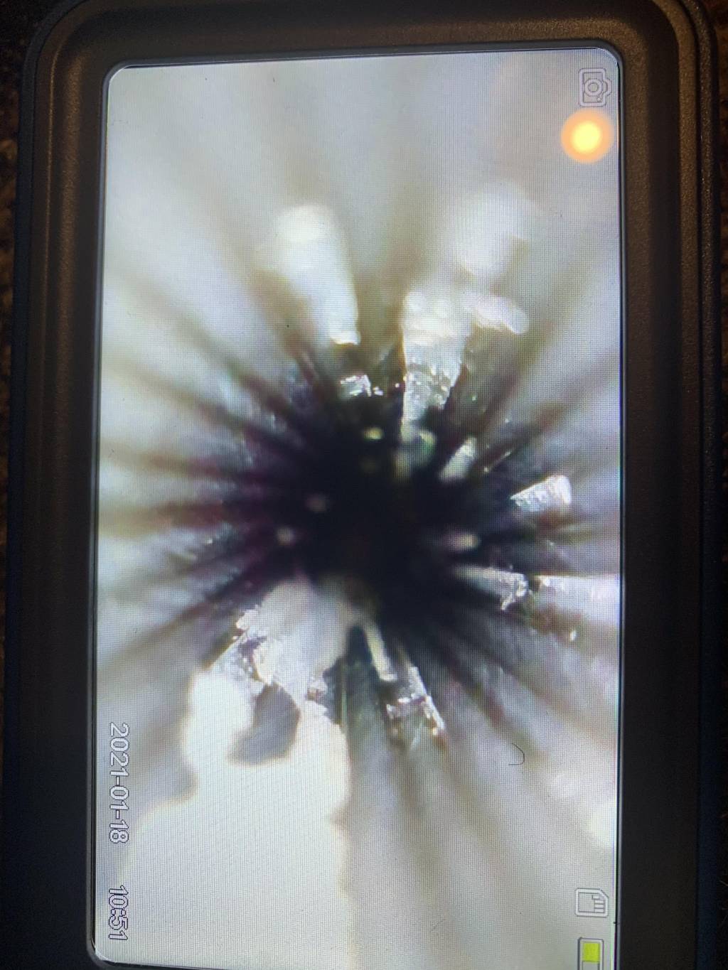

I know most guys clean their guns with their favorite liquid and a pull through patch. When the patches come out clean I’m good. Not really. This is my Taipan CZ barrel. It gets cleaned after firing 100 lubed slugs. I use firearm lead and copper solvents with the barrel off the gun. The pictures were taken after I even use a nylon cleaning brush. I can get the lead out but it involves some aggressive cleaning tactics. I won’t toot the horn of the manufacturer that this doesn’t happen to but I wanted to put this out for the guys who might not truly know what they are doing to their pellet guns trying to be slug guns.
Great pics. I totally agree. I have to scrub the crap out of my Slug A liner to get it clean after over about 100 slugs... I usually take the liner out and run a bore snake with brass brush through the liner 3 or 4 times, then run patches until it comes out clean. With the Superior liner and same slugs it only took 35 or 40 slugs to get that dirty. FYI, the Slug A liner is polished to a mirror finish.

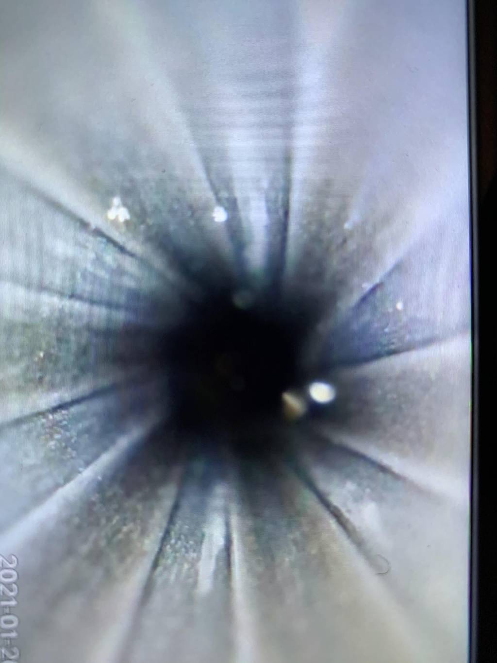

Have the same problem and posted couple weeks ago that slugs ruined my liner, maybe not ruined but definitely was the source of my lost accuracy of pellets and most said no way not possible they swap back and forth and never clean anything and that pellets and slugs shoot perfect! Well maybe so but not in my case and I only shot eight slugs.
Couple of smart fellas suggested lead in the choke, but I cleaned the liner over and over but patches and Hoppes#9 only. But after closer inspection with good light and magnifying there it was,,, heavy lead fouling! I pushed about ten pellets thru and that alone removed quite a bit but not all.

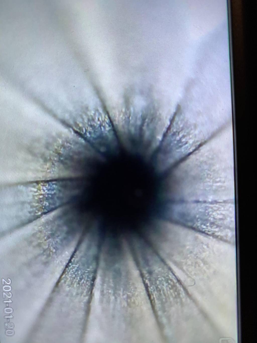

The point of this topic is not so much about the why, it’s more about the if. Just wanted to let guys know what could be going on inside their pellet guns while they are chasing glory. Now here is the bright side. Here is a TJ Slug barrel with way more shots through it. This is what it looks like the entire length after just a dry patch pulled through it. Both guns are accurate. Both guns are shooting a oversized slug. One barrel is a slug barrel, one is not.
