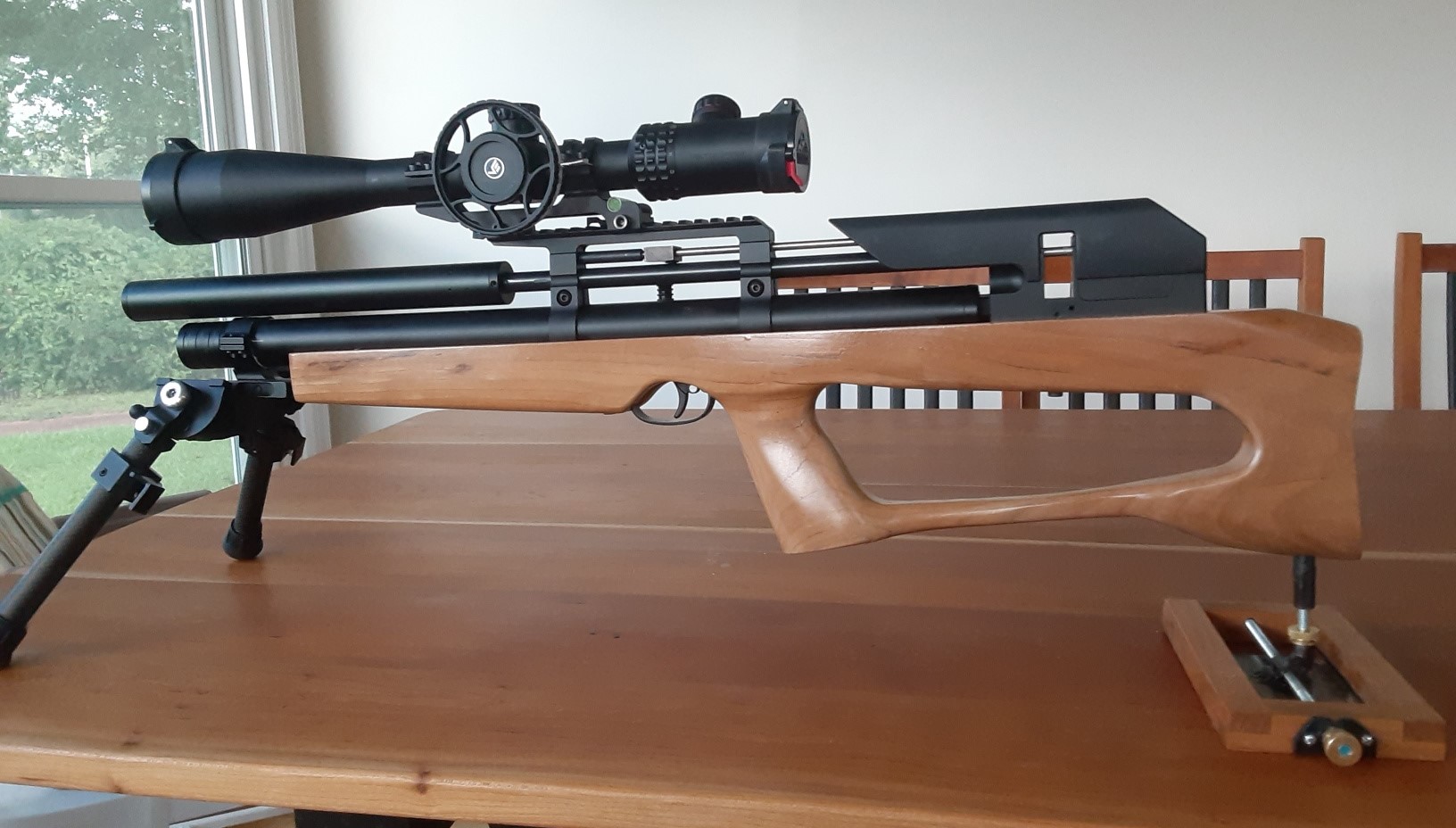

how is your woodworking? This is one of my 3 P35s in a stock I made from a piece of cherry I had left over from making my dining room table and chairs. Could have been walnut if I had that on hand or went and got some. They come with a plastic stock. About 5 lbs. The 25 would come tuned to 40+ fpe and the 22 30+. Plenty for small game in my opinion. They are less than $500 from Krale. The Stoeger Bullshark is closely related with a different stock and a 40mm longer barrel. You can find the Stoeger in the U. S.. They are regulated.
The predecessor rear cocking P15 is still available and comes in a beech stock.
