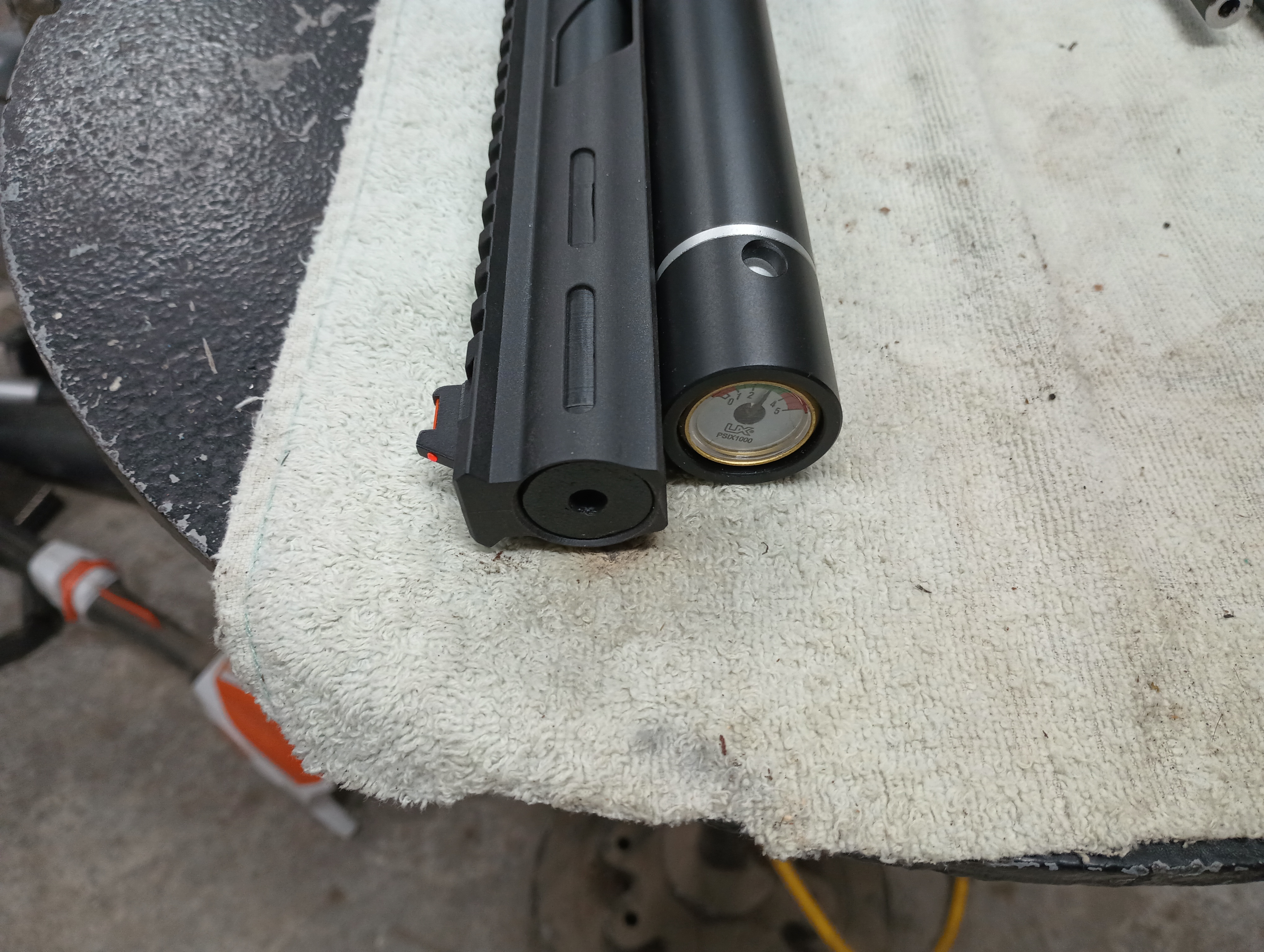

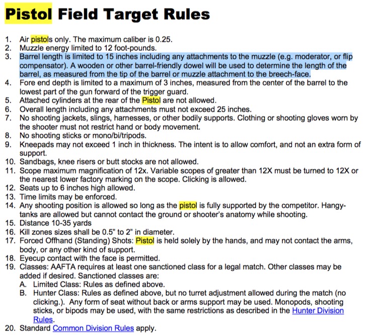

Premise is to retain some semblance of a pistol, which it does not.
It's a shame the 15" includes moderators as they protect hearing.

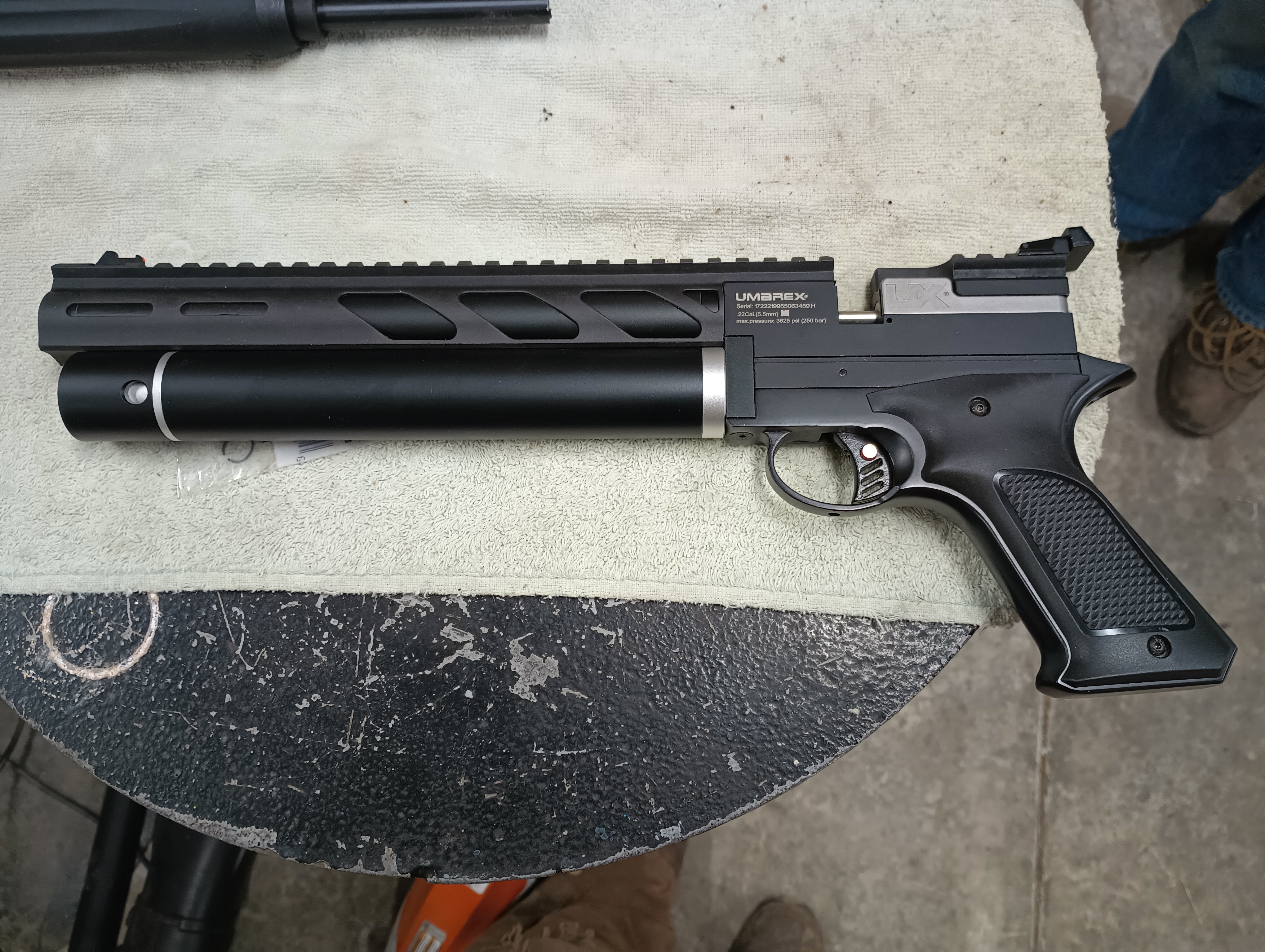

I'm not familiar with how to calculate the 12 ft pounds.. but I recently converted my notos from 22" long pistol to a just under 16" pistol, shortened the barrel 4" and instead of the fixed 6" external moderator, it's got a 4" internal moderator and I expected it to be louder and possibly less accurate with the shorter barrel.. but it turned out wonderful, it's actually quite noticable quieter than factory and, I still need to shoot a good test group, I'm thinking around 50 yards because it seemed to be quite a bit more accurate than factory.. I didn't do anything else and with the barrel 4" shorter I went from average 760 fps with cphp pellets to consistent 637 fps and that's with no tuning or adjustments from factory.. considering

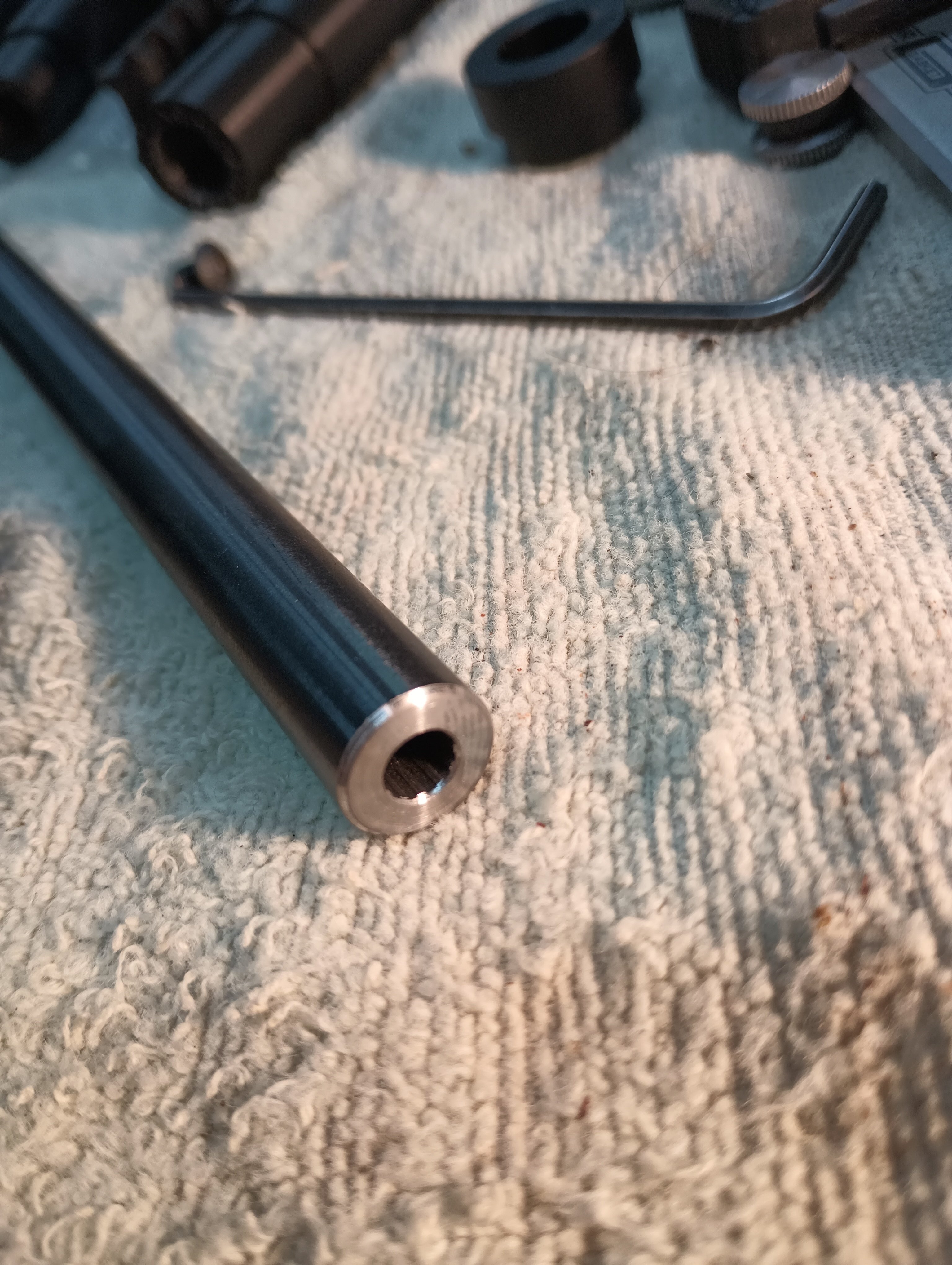

I just shortened it and it shoots better, I can now actually shoot freehand, and it's quieter than factory, I'm really happy.. now if I compare jsb jumbo monster redesigned 25.? grain pellets before and after the conversion I lost less than 100 fps and they really sound like they smack hard, plus it's even quieter.. now it's just under 16" overall and if I could get a machine shop to shorten the air tube it would be easy to get it to 14" like the attaman ap16 and likely to 12" like the attaman ap16 compact.. I did all the machine work and crown the barrel but I'm not comfortable doing machine work on the air tube, since I don't have a way to hydro test it and I'm not set up for large metric threading.. I guess it's the first time I have done any metric machine work.. and all my equipment is older but great shape, but it only has american dials so to do metric it's a lot of conversion from metric to standard and back..
but I'm really happy how it turned out.. factory open sights and pistol grip.. never put the stock on since I bought it for a pistol but it was too long to shoot freehand another option if I had to be under 15" long, a air tube off a pp700 and it would measure 14.5"

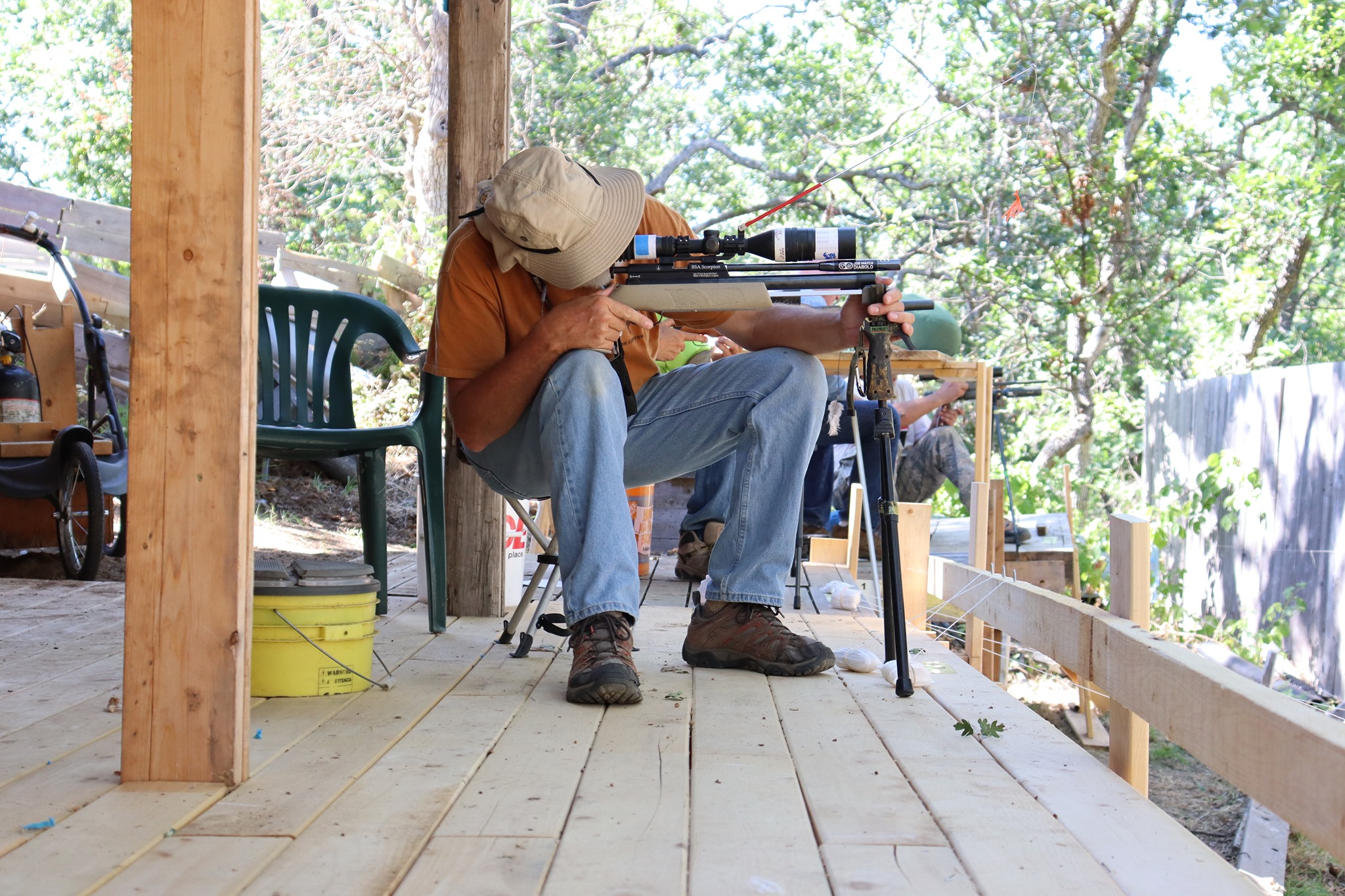

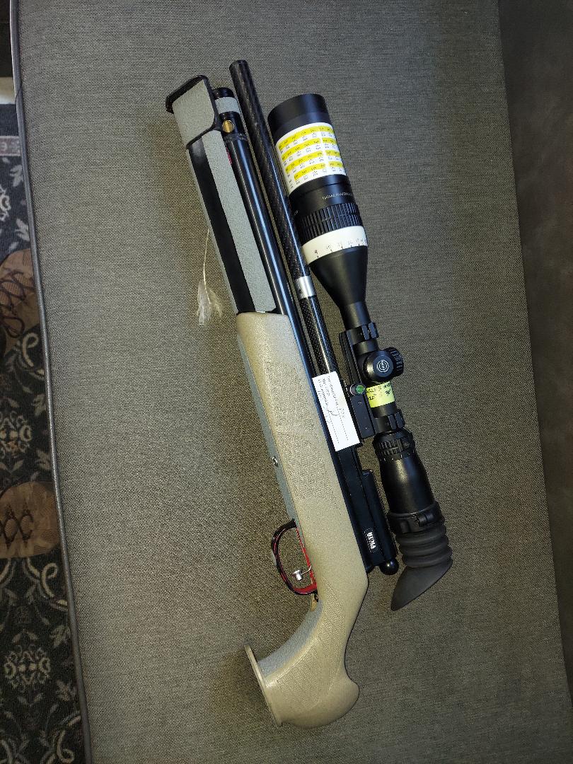

This a case in point picture ... being my @ 6 season old custom BSA scorpion. Had made a support extending the fore stock with the very end near muzzle a V block placing Bi-pod yoke at the furthest distance from trigger guard, yet still sub 3"
Also a pic on how shot, stance, bi-pod etc ...
The RAW pistol could be shot in a similar way if set as such to do so ;)
i'd prob blow the end of my finger off! worse would be me getting unwound out of that pretzel of a position.

They likely would allow it, as the AAFTA rules state for Hunter Rifle a stop ( Only one ) can be utilized. Tho not read of it's allowance along with the 6" depth rule forward of trigger guard ?
The Pistols 3" rule would offer the same question ?
I would reach out to a AAFTA BOG member for clarification.
