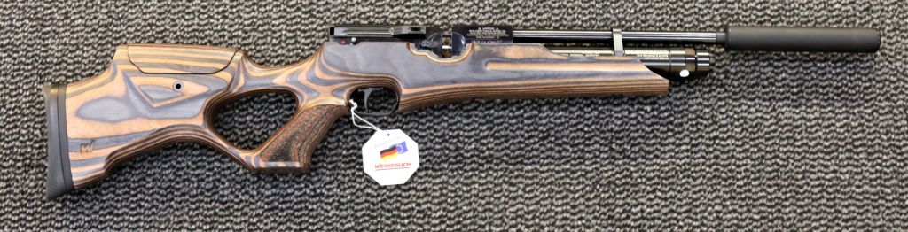

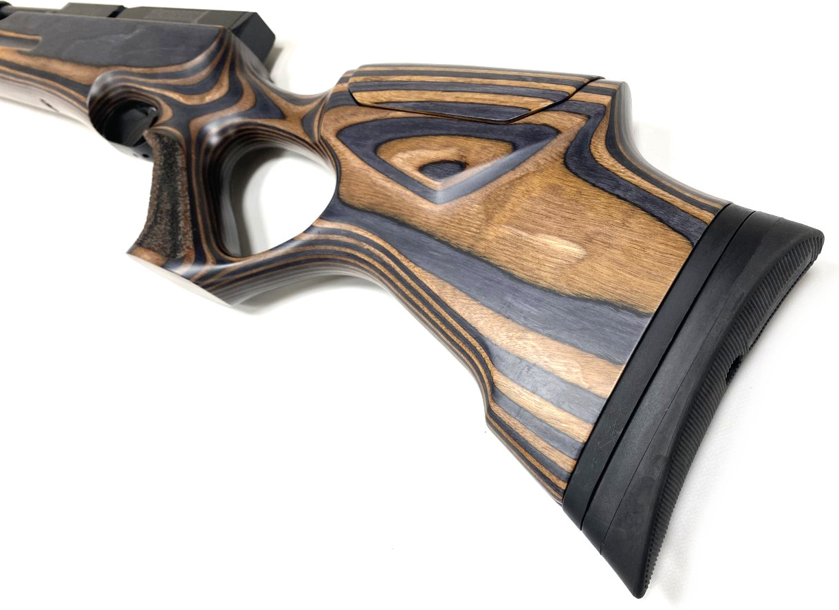

I dug up this thread to add some tuning information after some chrono work this morning. I didn't use a reg tester when I did my tuning, so I was estimating my set point, but I was wrong. Going by the rifle gauge, the set point appears to be in the 70/75 bar range, lower than I guessed. Average velocity with the 10.3 gr is around 705 fps, yielding power of 11.5 fpe. I knew shot count was greatly increased after my tuning, and it looks to be in the 165/170 range. Given the small carbine cylinder, I am very impressed with that number. It reminds of the old quote about the Union army Henry rifles, you load it on Sunday and shoot all week!I was thinking about a HW100 for silhouette practice. They have a bunch of options, but I think the laminate adjustable stock looks like a good fit. I was sticking with 177 caliber.
I'll adjust it down to 800fps or so to increase shot count, and save wear and tear on the targets.
I guess the big decision now is carbine or longer barrel.
I like the higher shot count with the bigger cylinder, but the rifle looks pretty long. Carbine looks a bit short, and I have a desire for high shot count. I have a big SCBA bottle, and a bauer compressor, so I refills are unlimited, but I still have a stigma for high shot count.
So now I am leaning to the carbine, but I am not sure. What do you guys think?
