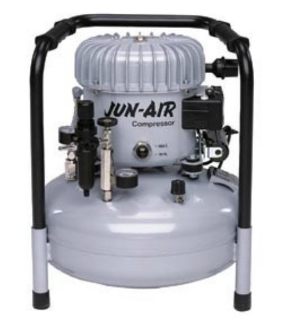

I have a Jun Air oil free quiet compressor for paint jobs and I once had the idea of using it to drive the ShoeBox but finally gave up because the ShoeBox has some requirement on the pressure and flow rate of the first stage compressor. My Jun Air just doesn't meet the flow rate requirements. From your description, it seems that your compressor does not have enough flow rate as well. The compressor going "fast cycle" suggests that it cannot keep up with the rate of air drawn by the ShoeBox. The Freedom 10 requires a first-stage compressor that can deliver compressed air ( 90 psi ) at 3 cubic feet per min. but it seems that your Bostitch can only do 2.6 as indicated in the official site :
Airgunfans, you should use your Jun Air. A Shoebox is not an airhog like the Altaros booster compressor. I first used a Porter Cable 6 gallon pancake compressor with my F8 but it was too loud for me so I replaced it with a quiet running Rolair JC-10. Shoebox F10's sip air and your low run cycle with the Jun Air will pleasantly surprise you. I'd set the Jun Air regulator for 125 psi and see how long it runs to keep pace. It will not be stressed at all.
