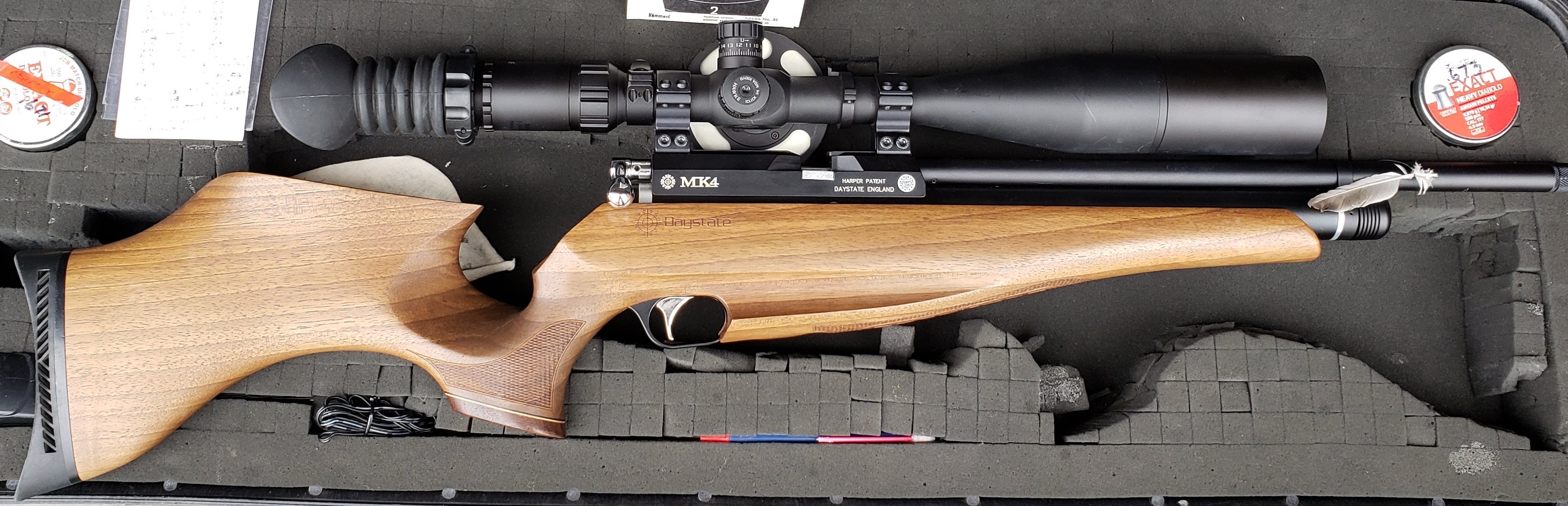

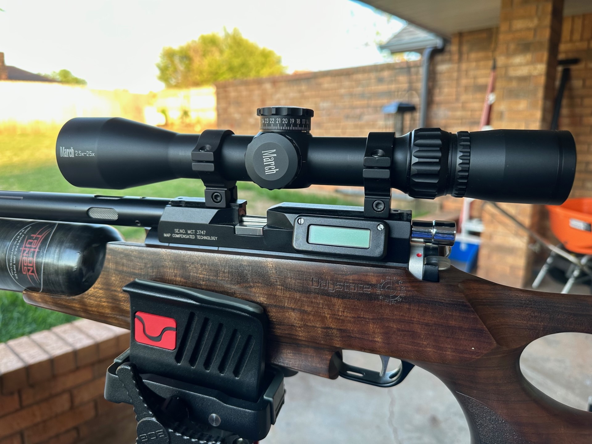

Be sure to add the cost of a compressor and associated gear. I would highly recommend you buy a preowned Daystate Air Wolf MCT or a Daystate Mark IV. Both of these early MCT PCPs are reliable, accurate and state of the art. They will introduce you to the electronic rifle before you invest another $2000 just to find out electronic rifles are not "all that" for you. My own Air Wolf and Mk IV are fantastic rifles and totally fulfill my desires for an electronic rifle.
