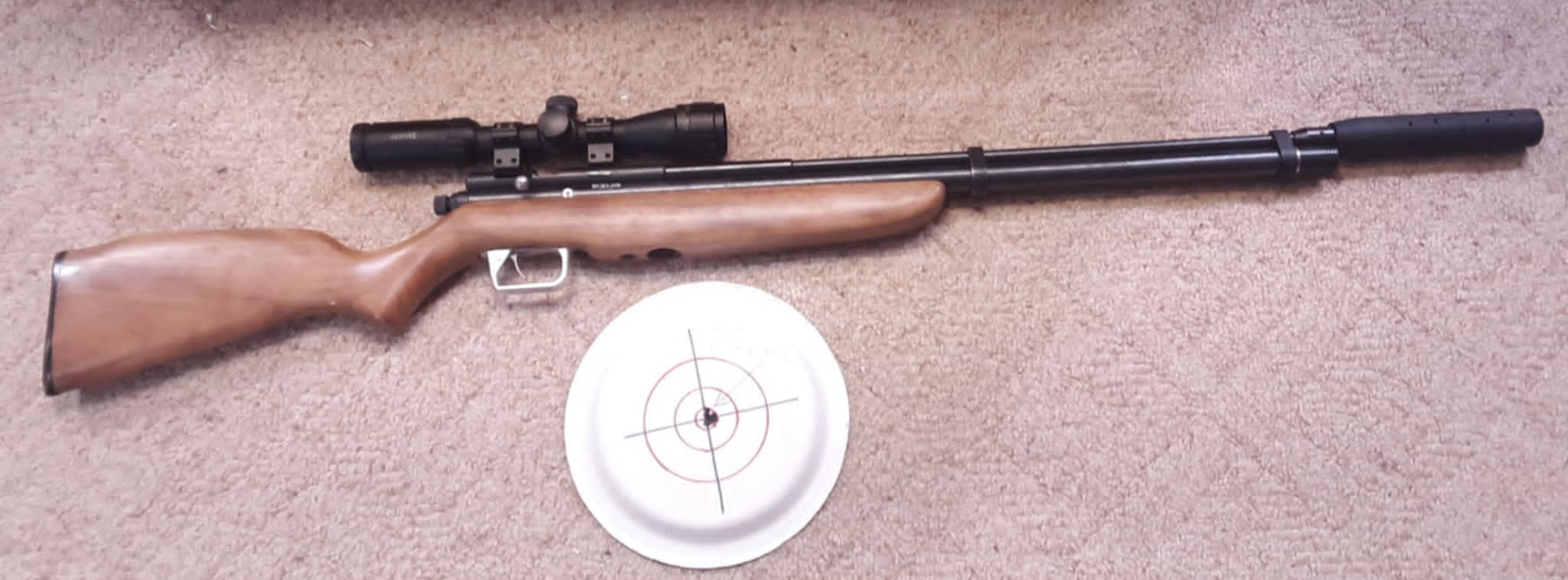

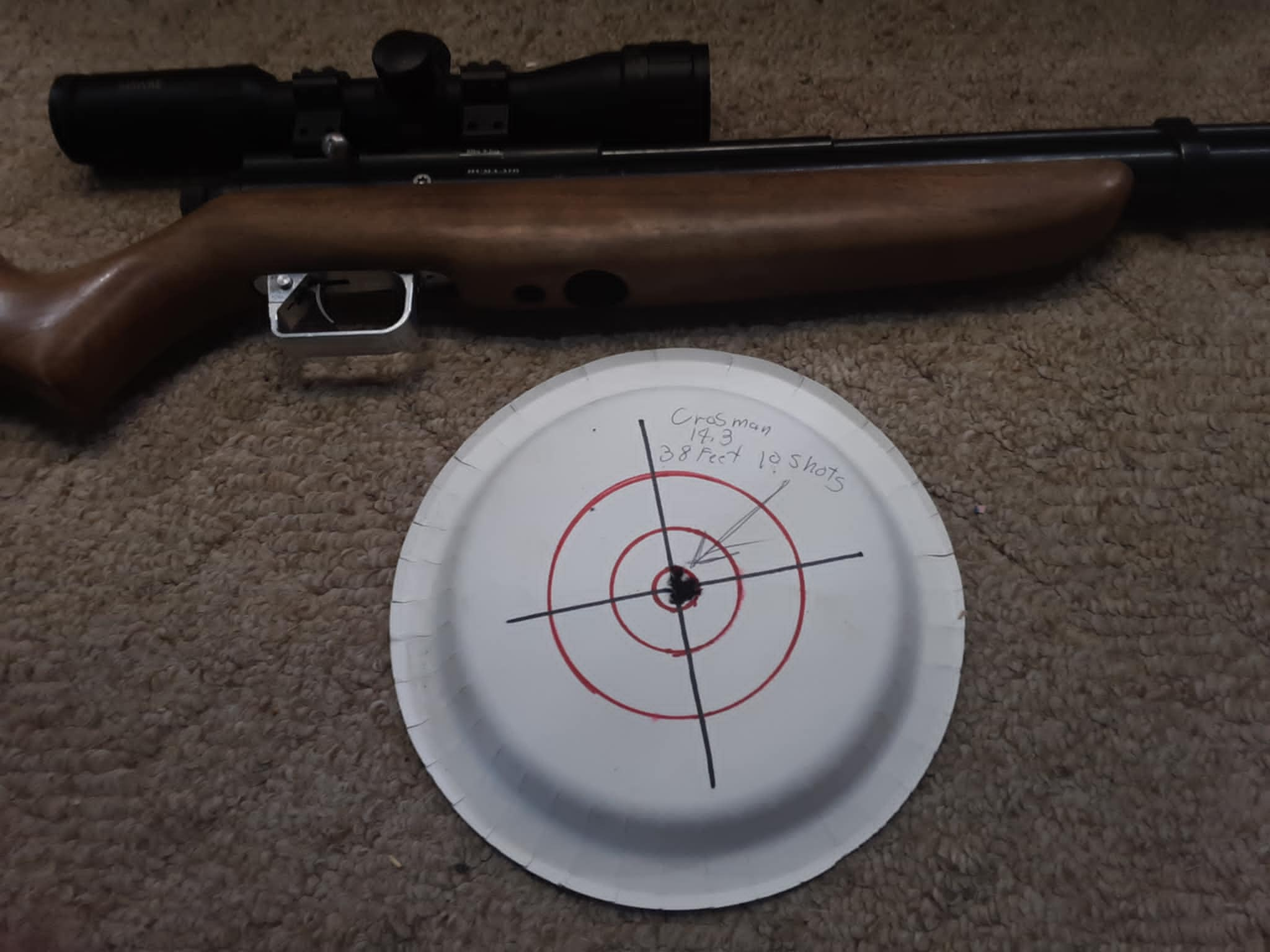

I figured so much. I paid $300 for the package, and I want the pump as a back up. I can buy a pump new for $50, so that is basically what it is worth to me. I will probably just keep it as I don't own any other .177 caliber.Hard for me to say, I never thought the pumps where worth the price but the rifle should go for $300 nib

Check the gauge port o-ring. Common issue, especially if it sat NIB this long. Can you post the serial number? We can find out how old it is!Can you believe this rifle leaks?I want to weigh the individual parts and file the specs in my airgun files. An aluminum breech saves a surprising amount of weight, but I forgot to file the info properly, so I must weigh again. I really like a lightweight rifle. Pyramid Air has 600mm .25 caliber DRS synthetic stocked rifles (refurbished) for around $845. and I already blew through all of my Christmas money.
As it is, The Discovery, scoped, weighs 6 lbs., 4.3 oz. this would be very similar to the DRS.
I just bought two rifles. I couldn't decide which I liked better, so I bought them both. One new, one used. Where is the serial number located?Check the gauge port o-ring. Common issue, especially if it sat NIB this long. Can you post the serial number? We can find out how old it is!
