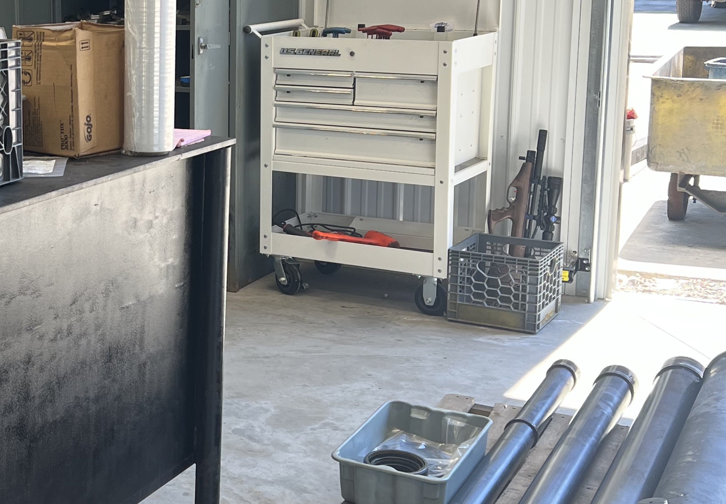

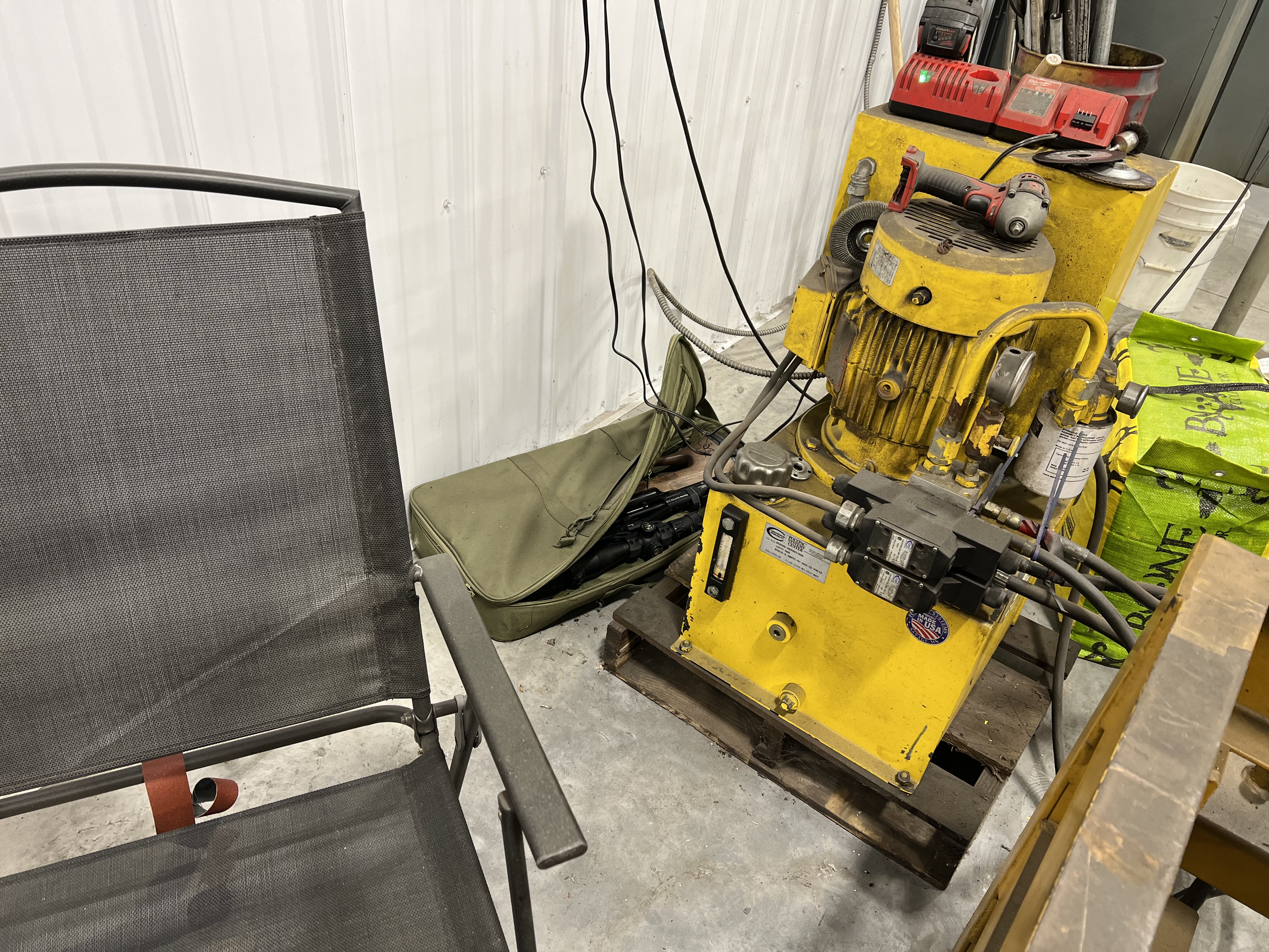

We were taking a break at the shop today and started talking about the shop gun and how long has it been since we shot it. The conversation started because a new guy asked what was in that case behind the cylinder machine. My buddy insisted it was last year when we each took a crow with it. So I dug it out of the case. The gauge read just under its max fill pressure and the mag still had 8 left in it. I walked out to the dumpster and drew a picture while my buddy set up for a 50 yard shot. That’s where we have it zeroed. First shot was spot on and full power.
I‘m not saying a regulated PCP can’t sit for a year and still be spot on at 50 yards and deliver a full power shot. What I am saying is one without a reg will.

This is how it was originally spending its life. The first guy in the shop got it out of its case and set it by the door. But we’ve been so busy since last August so it been neglected. Crazy to think when I bought the gun I fully intended to regulate it if I wasn’t happy with what I could extract out of it unregulated. Thankfully Troy Hammer convinced me otherwise.

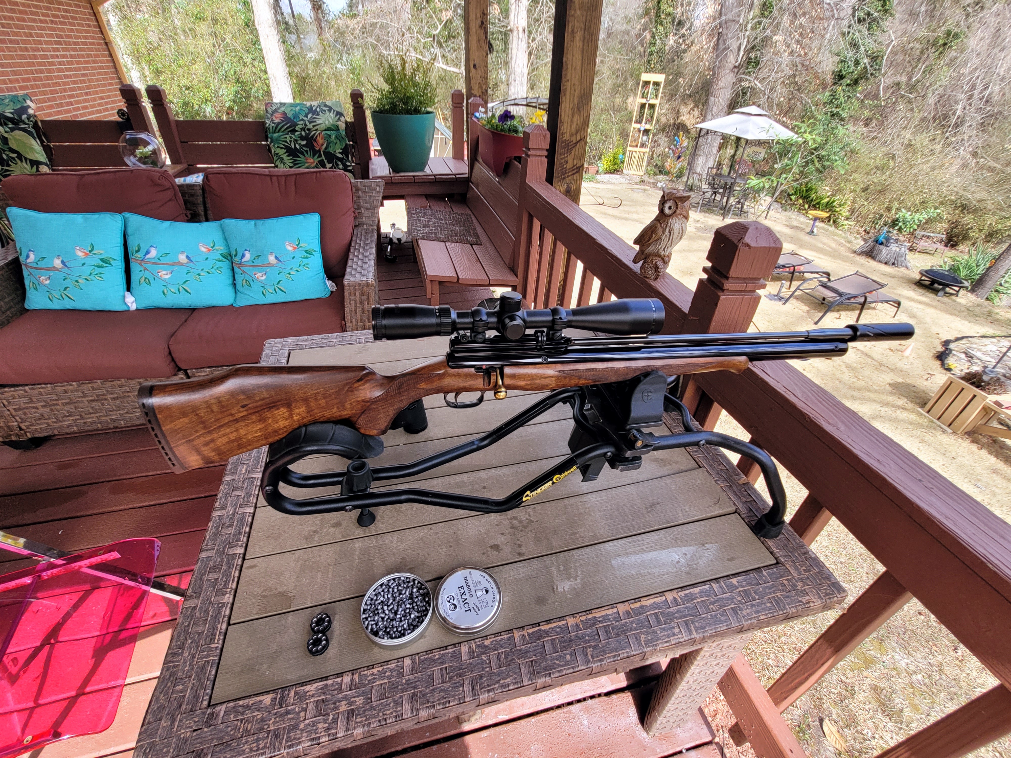

What I have noticed is that in My backyard i can sight the light weight pellets in, and then just change the aiming spot. Top, Middle, Bottom of Spot. I won't win any matches, but when you do get a few "Bragging Groups" it puts a Smile on My face! lol NonReg Gun
