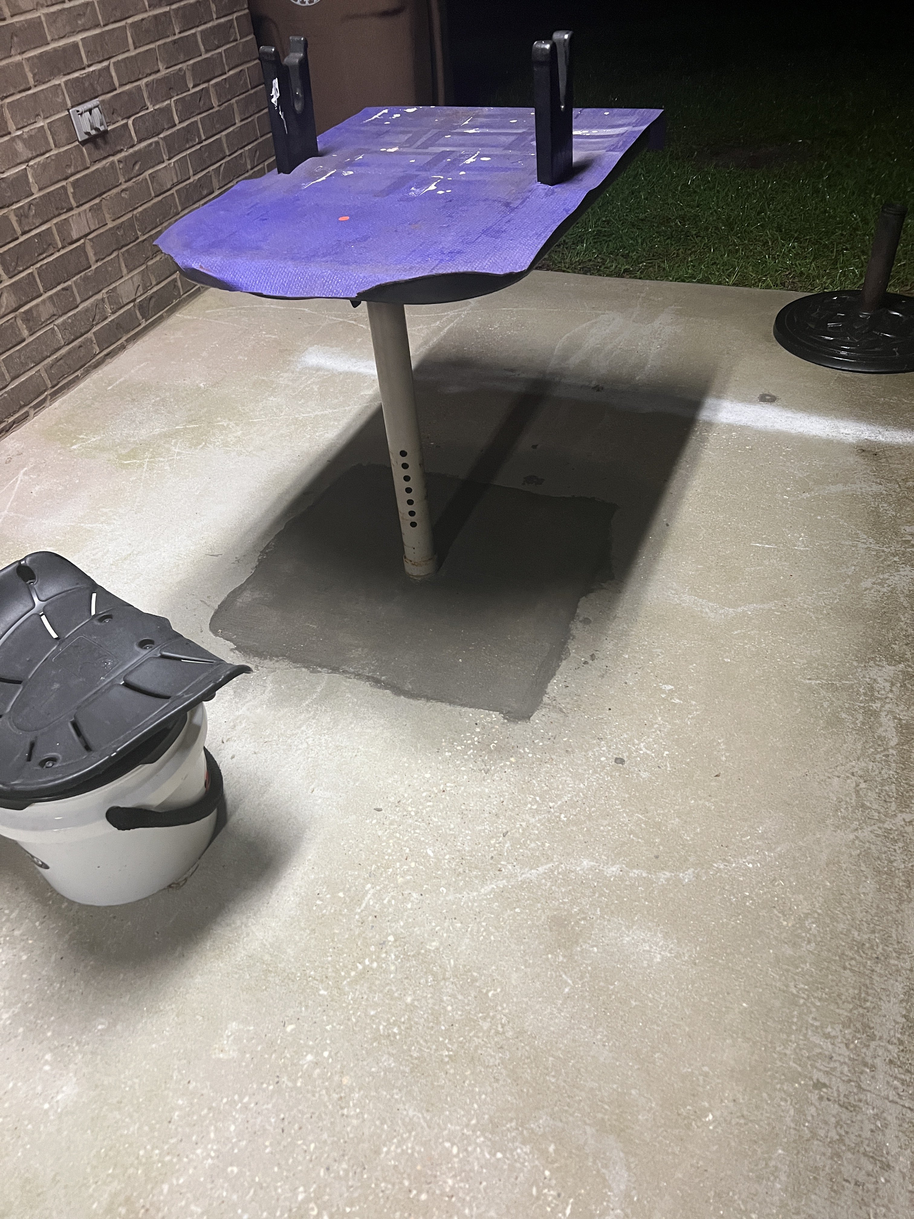

This morning’s project
This morning’s project was to put my shooting bench firmly “in the ground” with concrete and still be removable.
This table is covered and is facing my 25/50 yard Bench Rest and FT dope range.
Goal was to get rid of the long tripod legs BEFORE I broke my arse 🥴 or toes again!
When I lift the table I have a flat plate insert that fills the 2.4” hole so its level and no longer a trip hazard.

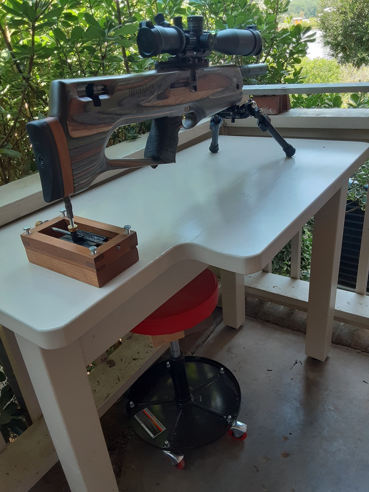

I think your new bench looks great and sturdier than mine. I built this new one earlier this year. It's all construction lumber with 3 legs laminated out of 2x4s and a top made of glued together 2x6 pieces. The single back leg was a bit shaky until I used a figure 8 piece normally used to attach table tops to screw the back edge to the porch rail. That made it a lot more solid. Solid enough for me. Fortunately I don't use this porch for anything else so the bench can just stay set up. The finish is the same Behr house paint on the porch. I have leg adjusters on the bottom of each leg so I could level it up.
For seating I use a rolling mechanics stool from Harbor Freight. I wanted it a bit higher so I screwed on a couple 2x4 scraps. I like the ability to roll around while seated. It's pretty inexpensive.

Nice setup.
