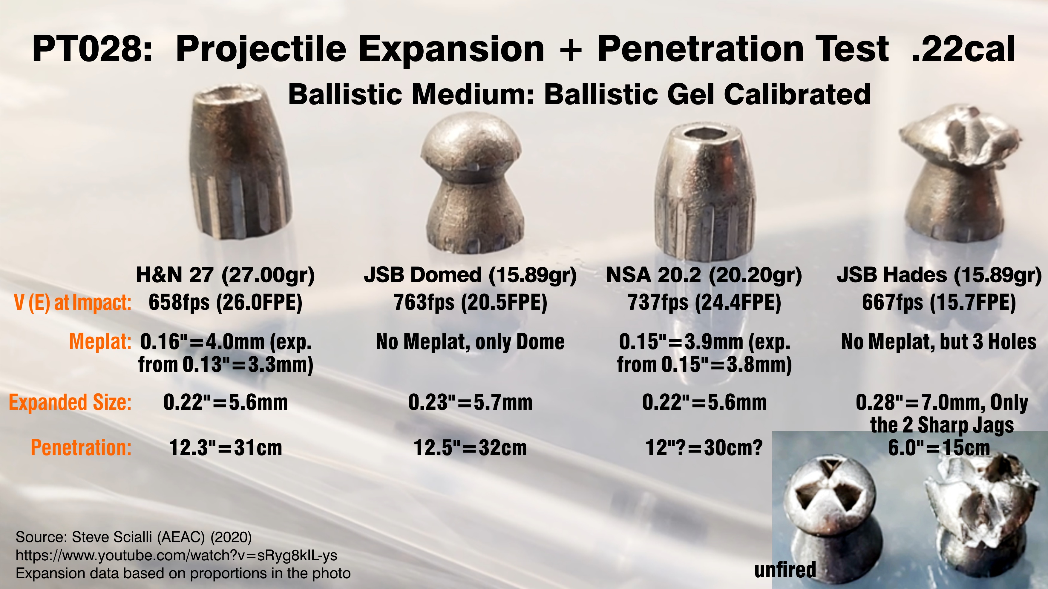

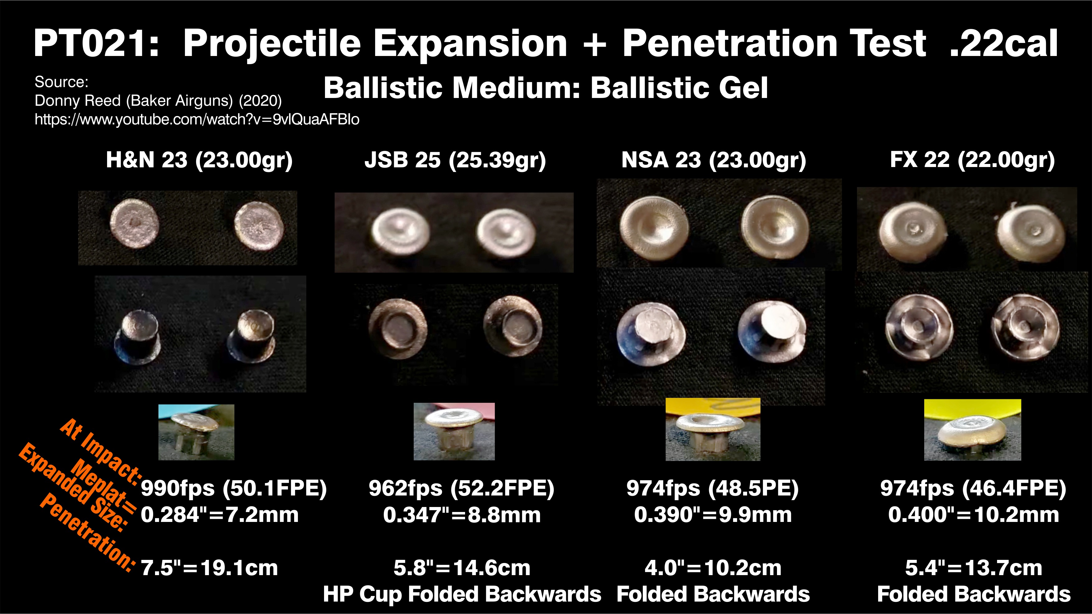

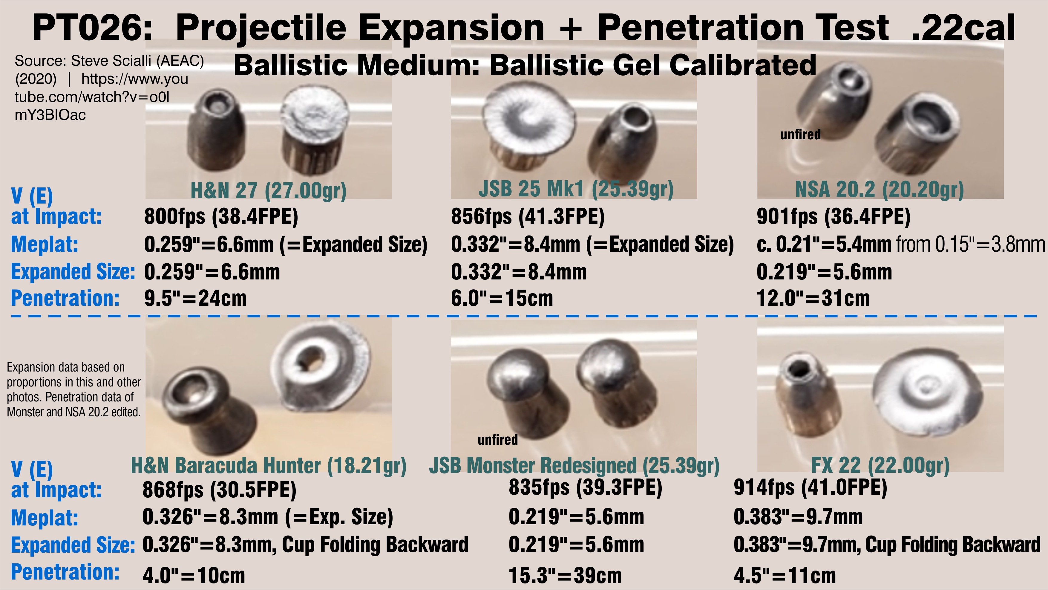

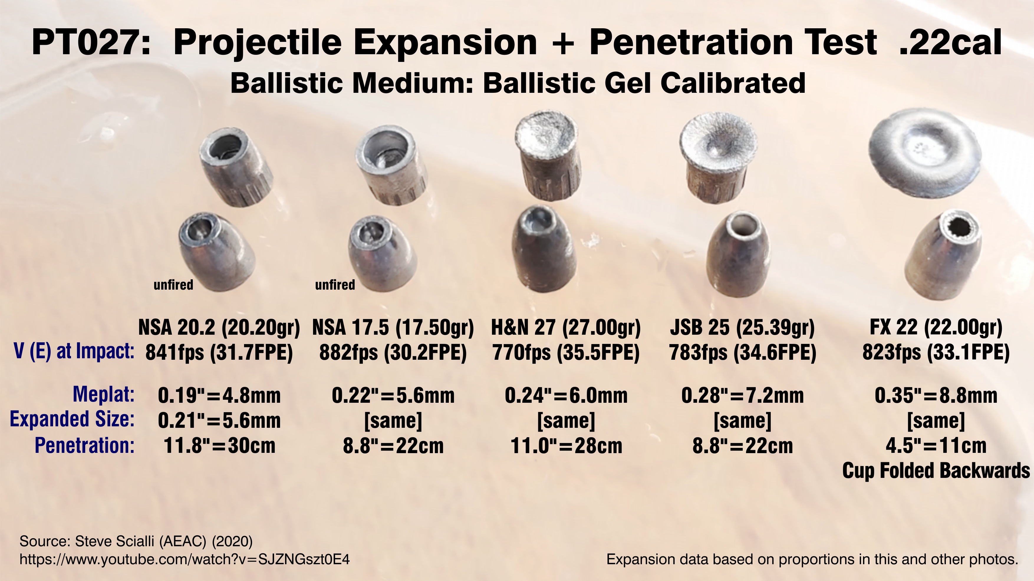

Slugs, pure lead category. Is there energy dump or expansion equitable to the hollow point or hunting pellets? I shoot pests, I wish ethical kills. Just that simple. Targets are to make sure I keep it tight for ethical reasons. Sometimes I need certain penetration for head/ skull shots. Which is my preference. Body more forgiving. But my application is limited. Thanks, I await responses, especially towards energy dump.
Here are a few samples of expansion tests with slugs. 😃
Cheers,
Matthias
Projectile Test. PT021.  Donnie Reed (Baker Airguns) (2020). -Ballistic Gel.- 46-52FPE. H&N 23...jpg
Projectile Test. PT026.  Steve Scialli (AEAC) (2020). -Ballistic Gel Calibrated.- 41-46FPE. Bc...jpg
Projectile Test. PT028.  Steve Scialli (AEAC) (2020). -Ballistic Gel Calibrated.- 16-26FPE. H&...jpg
Projectile Test. PT027.  Steve Scialli (AEAC) (2020). -Ballistic Gel Calibrated.- 40-41FPE. NS...jpg

I shoot several of the projectiles depicted here. Some at a higher velocity than shown, some around the same. All of my slugs/pellets were recovered from or just beyond a living furry creature. I had a bucket full. Some still laying around. I don’t agree with what’s pictured. Especially the H&N hollow point. I shoot them at 940fps and don’t get that expansion on squirrel. Same with his Hybrid results. They do mushroom but you have to get them cruising to get full expansion. @rangur1, the king of energy dump pellet is a Polymag. It is as devastating on small animals out to its accuracy limits as a slug. Except in .177. A 10gr slug has an advantage on a .177 Polymag.
I shoot several of the projectiles depicted here. Some at a higher velocity than shown, some around the same. All of my slugs/pellets were recovered from or just beyond a living furry creature. I had a bucket full. Some still laying around. I don’t agree with what’s pictured. Especially the H&N hollow point. I shoot them at 940fps and don’t get that expansion on squirrel. Same with his Hybid results. They do mushroom but you have to get them cruising to get full expansion. @rangur1, the king of energy dump pellet is a Polymag. It is as devastating on small animals out to its accuracy limits as a slug. Except in .177. A 10gr slug has an advantage on a .177 Polymag.
🔶️ Thanks for that very helpful comment, Frank! 👍🏼
Another case of "real life science" beating "lab science" (ballistic gel/ butcher's meat tests).
Matthias

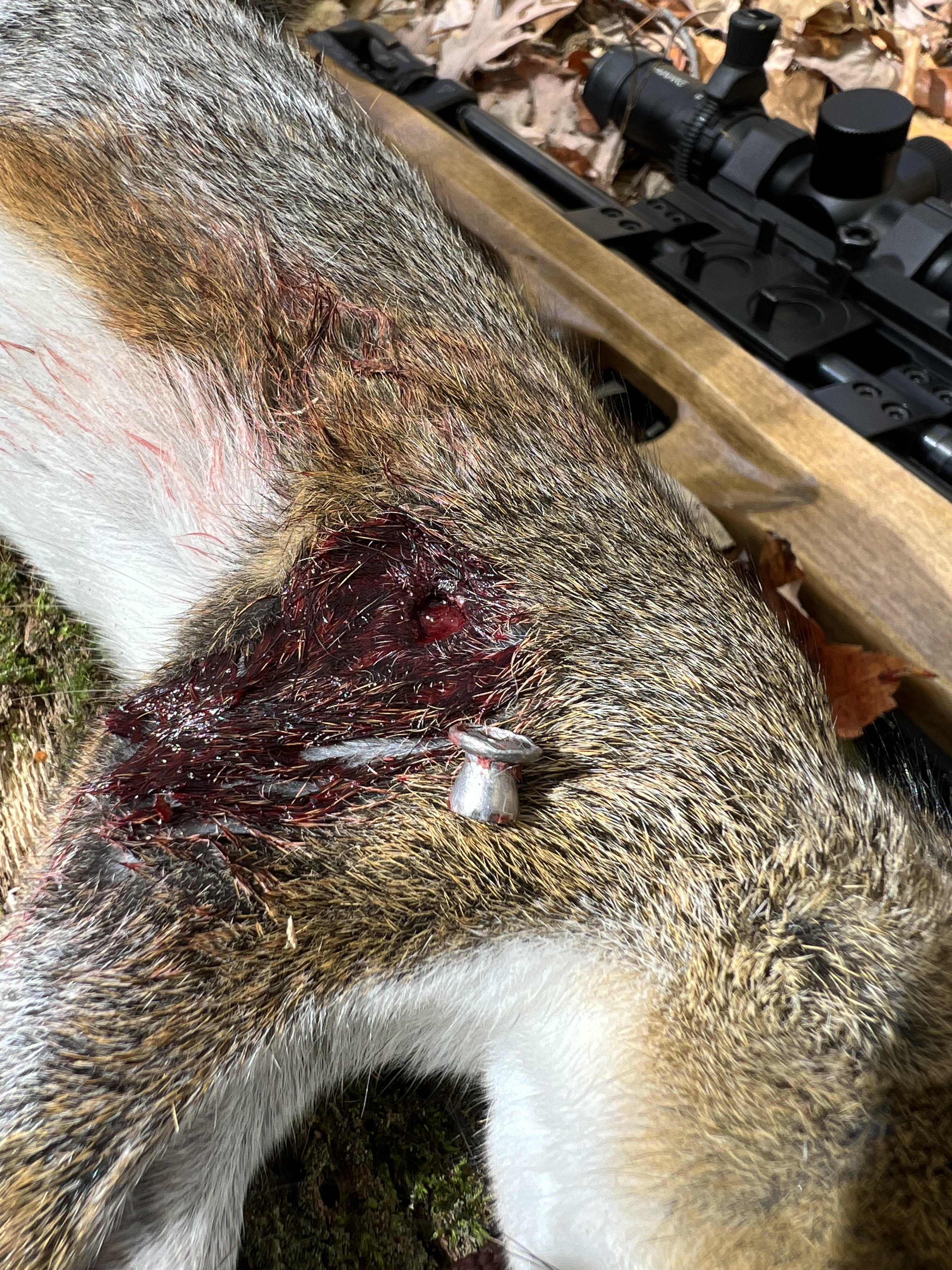

In my experience and recovered pellets, the Hades do a better job than a dome. As long as they shoot accurately to your max range. A dome will generally hold its own further out than a Hades. A Hades magic doesn’t come from expansion. It comes from the shape of its head causing better cavitation than a dome. This is a Polymag removed from the aft side of a squirrel. This is what these pellets do every time. A Hades head is still too dense to get reliable consistent expansion. Maybe if you can get them going accurately at warp speed.
