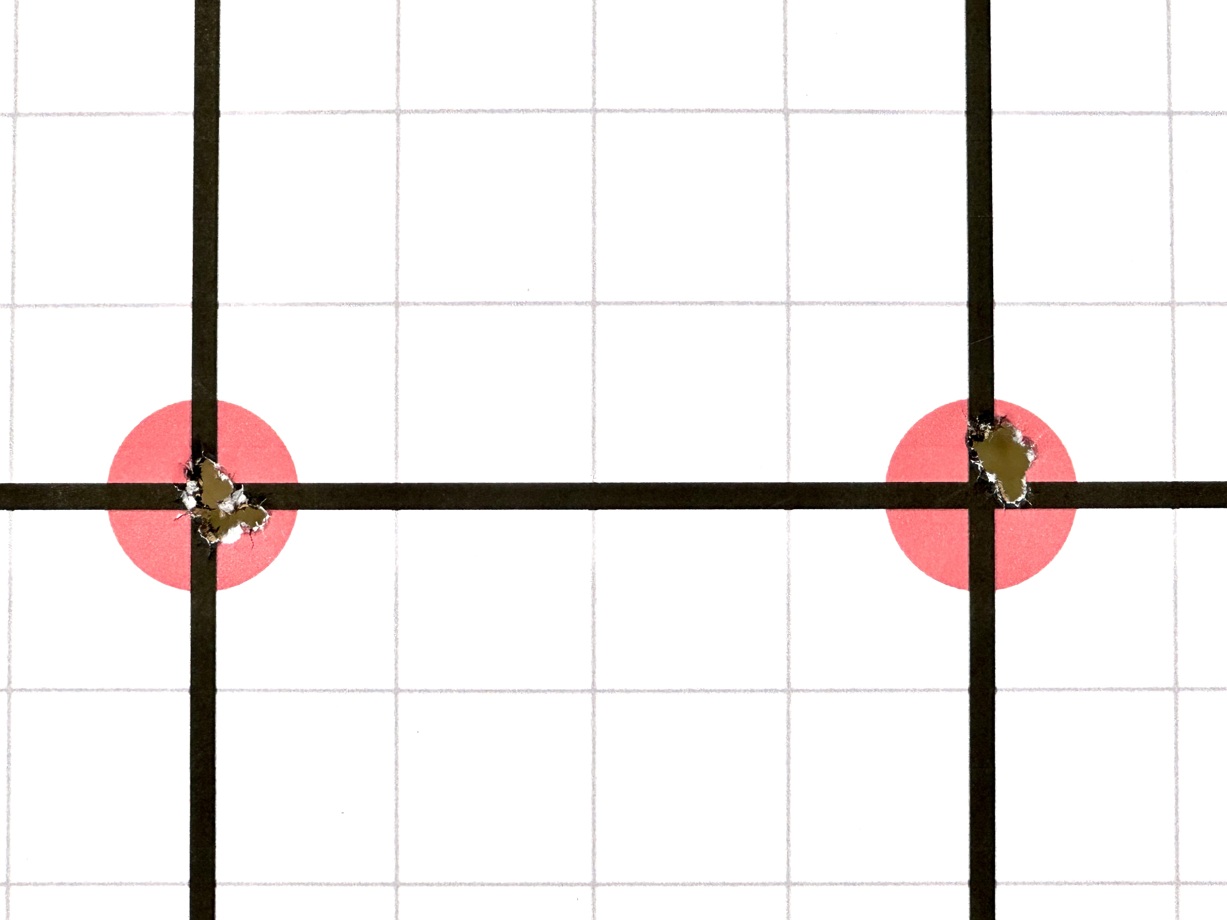

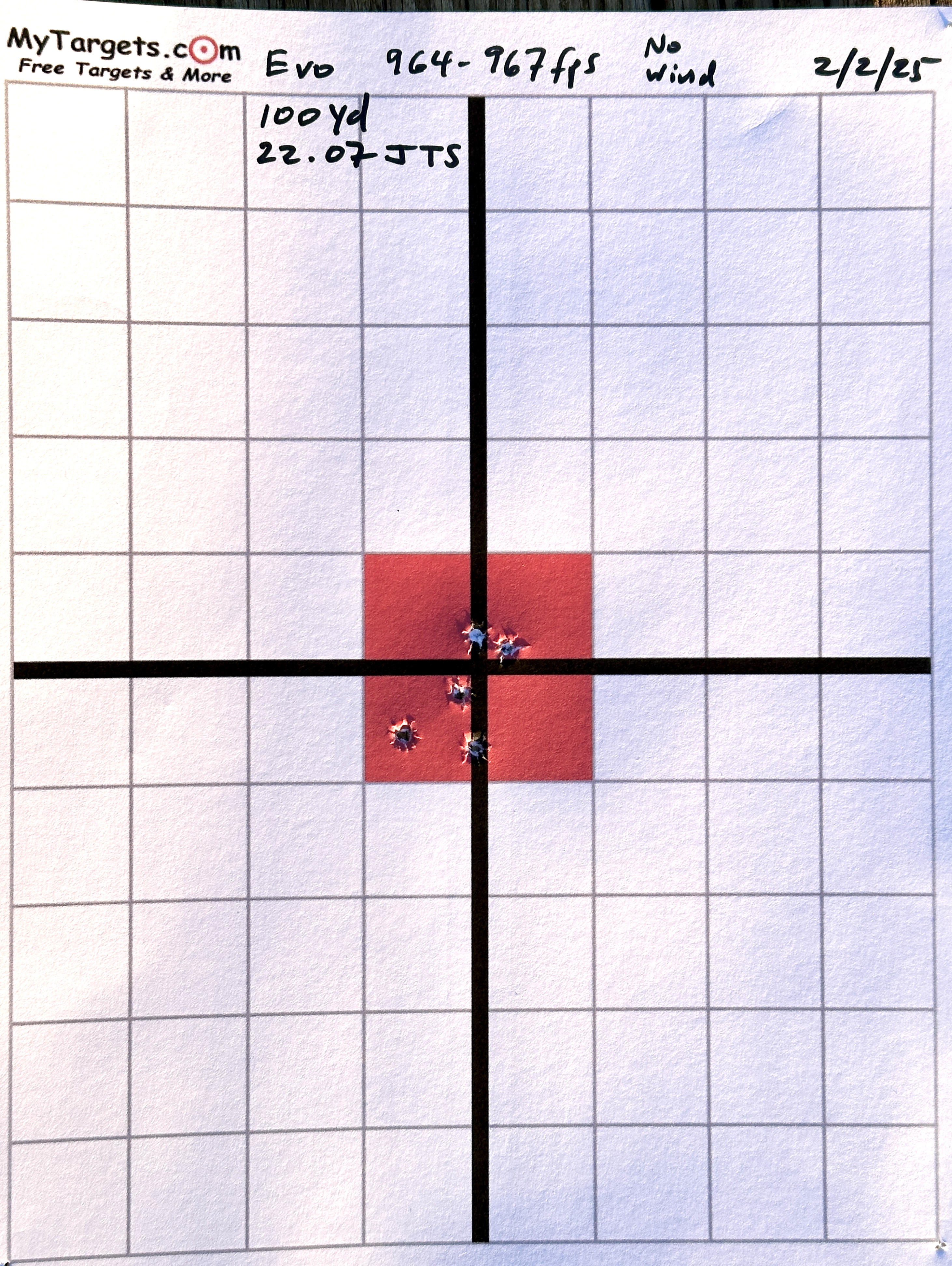

The two week deep freeze has subsided and today the winds unexpectedly calmed late in the day so I got out to get back on the Evo .22.
Very happy with the way this gun shoots the JTS 22.07’s
Shot at 50 yd and before packing it in, the winds died to nothing so tried a group at 100 yd. For pellets at this distance……Yep, this’ll do.
Bit of reg creep though…speeds gradually increase by about 10 fps over the course of a magazine or two. I‘ll have to troubleshoot that.
50 yd, 5 shots each, slight L to R breeze
5 shots at 100 yd.

50 yd, 5 shots each, slight L to R breezeView attachment 535240
5 shots at 100 yd.

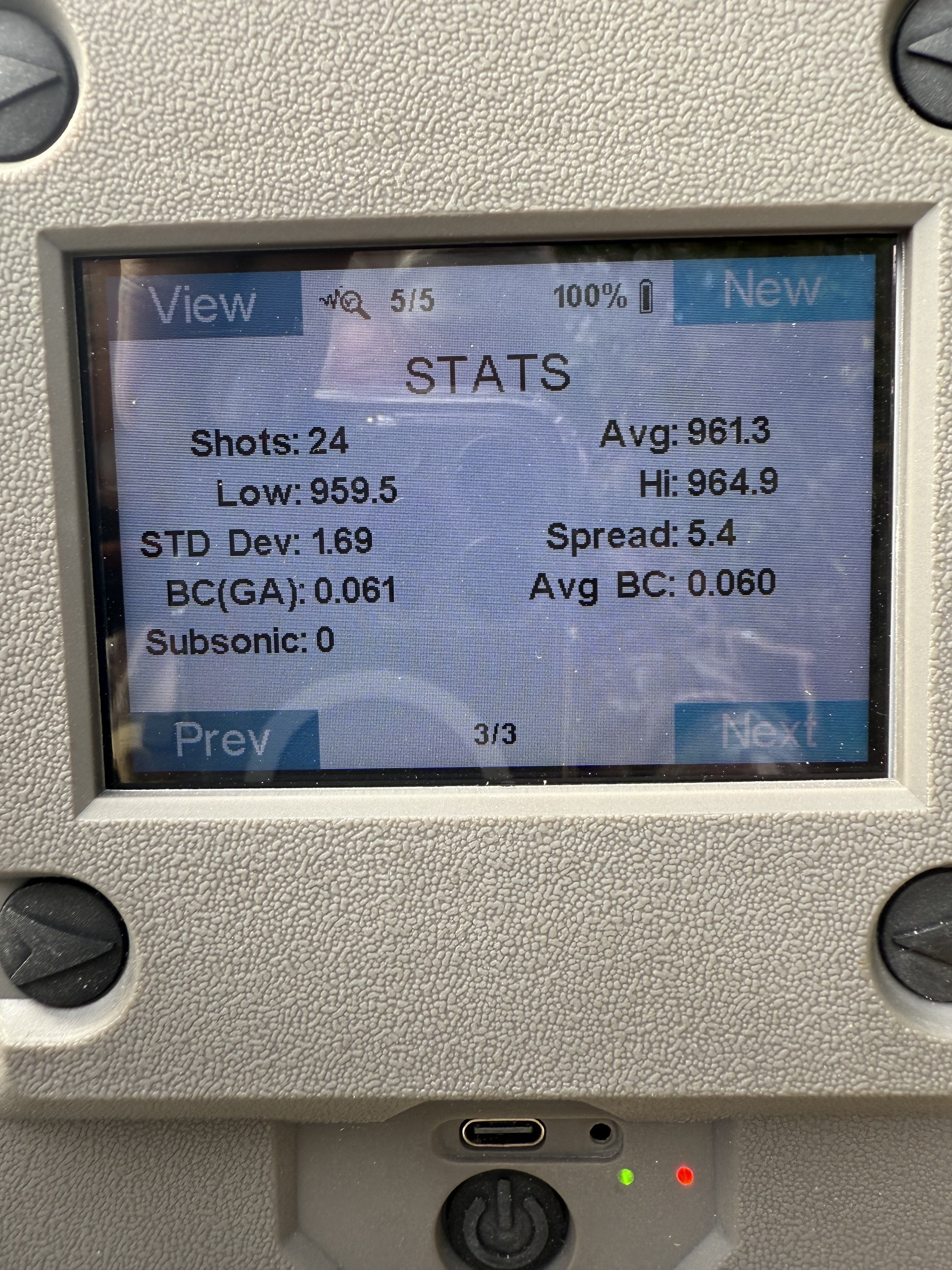

I spoke with Keith in SKOUT Service and he said that In reality if you are within a minimum of 10% of the HP side, you’re good to go.
At a glance, the ES readings are around 6 fps, maybe less, and I don't think I can improve on groups at 50. They’re there!

Good info. I’ve been shooting .22 pellets lately from my EVO. HP at 92 bar, LP 150 psi, Dwell 23 which gets me about 960-965 fps with the AEA 21.9 or JTS 22.07 (they are the same pellet). The BC averaged right about 0.060GA.
